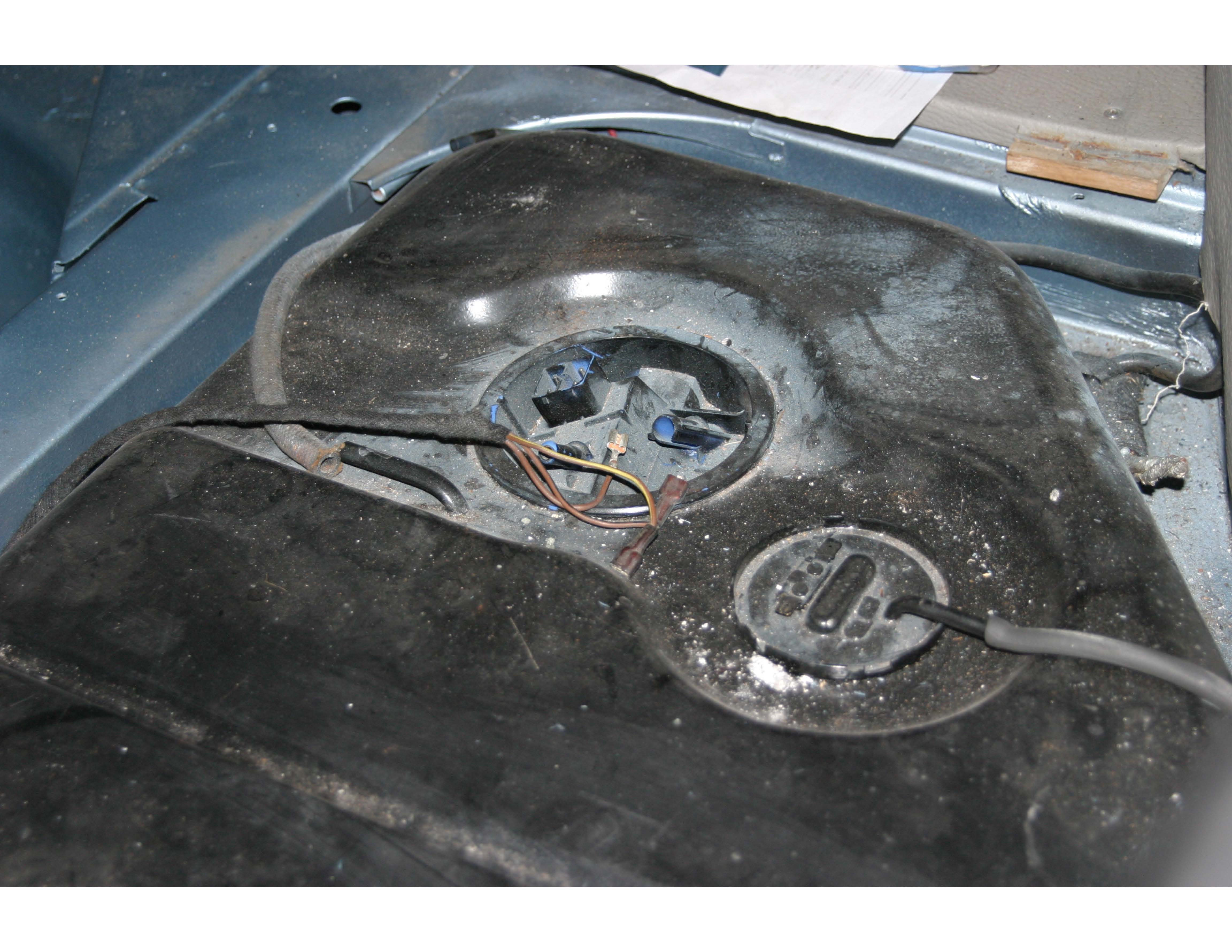

HEE YOU GO YOU JUST HAVE TO LENGHTEN THE STEM FEED AN INCH OF SO FAIRLY EASY
Thanks for the extra responses. Looking at this image Alan it looks like you have the fuel injected tank. My tank has only the smaller hole for the sender unit and pickup that goes to the carburettor. So HB Chris, based on your post can I just change out everything using the smaller hole or it is better/easier to go for the injected tank?

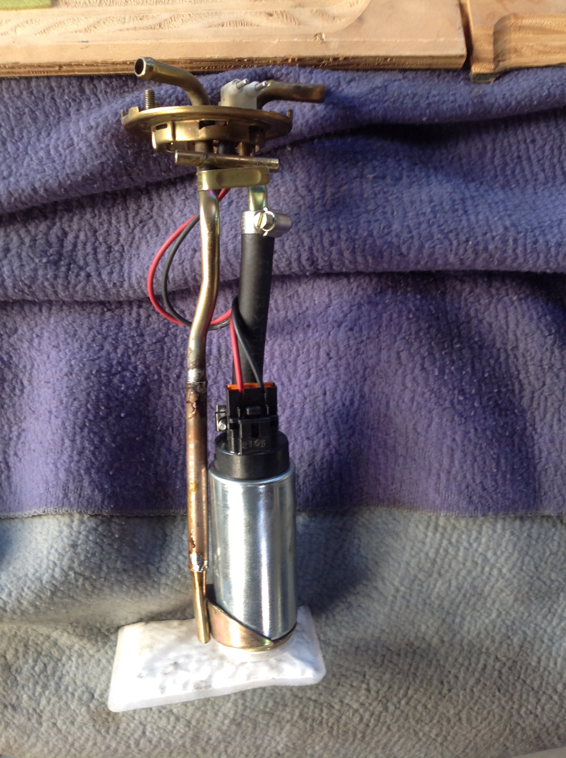

The e28 sender holds the 318Is pump just fine, or vice versa, but you need to lengthen the pickup foot of the pump to the length of the original pickup. I posted pics here in 2014. But Don likes the Walbro pump, easier to modify?

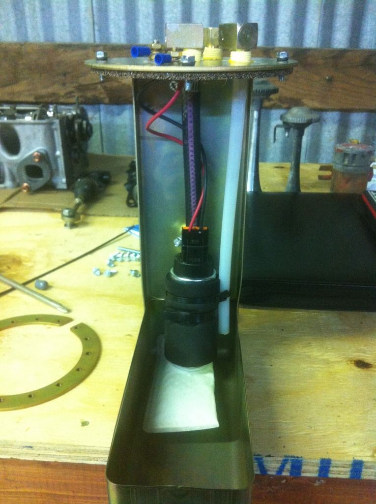

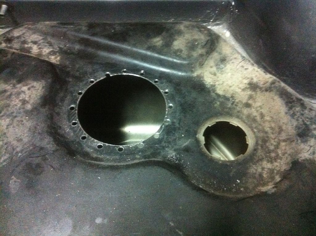

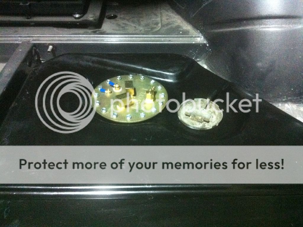

Here's what I used: http://www.tanksinc.com/index.cfm/p...duct_id=84/category_id=61/mode=prod/prd84.htm
It's the only option that includes it's own trough at the bottom to prevent fuel starvation (I don't know about CSi tanks, but all newer fuel injected cars have this built into the bottom of the tank). An M30 isn't all that high performance, but I've seen S14 engines with a piston blown apart from momentary fuel starvation (lean mixture causing preignition).
This is an awesome link and solution! Thank-you so much for sharing this.
