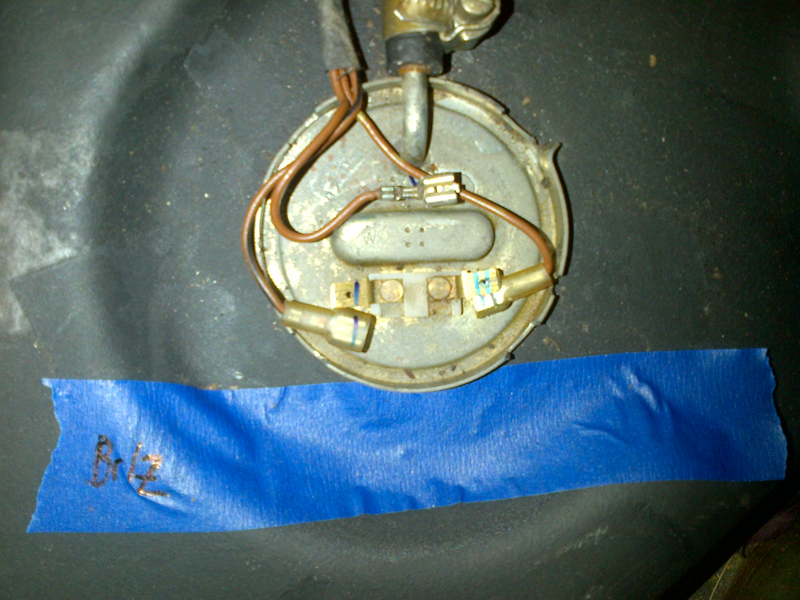

Hi Aearch,
I had this layout (see pic), which i believe is Original (3.0 CS 1973, carbed, Euro version). So it matches your own answer to your own question.
Top is ground; brown.
Left is then marked 'Br/Z' = Brown with black stripe. Brown (+the yellow ? ...it's a bit faded) is right.
My internal resistance wires are broken as well.
Arent't new fuel sender units for sale (BMW or W&N)?
Erik.

The sender is just two resistance wires with a float bridging them, shouldn't matter which way current runs through it. OTOH, some must have it correct or alles ist veloren.

no not true
the wire setup is critical
as the blk/brn wire is the low level light and must be hooked up to the + side
and the brown/yel goes to the guage on the "g" side or else it wont work
