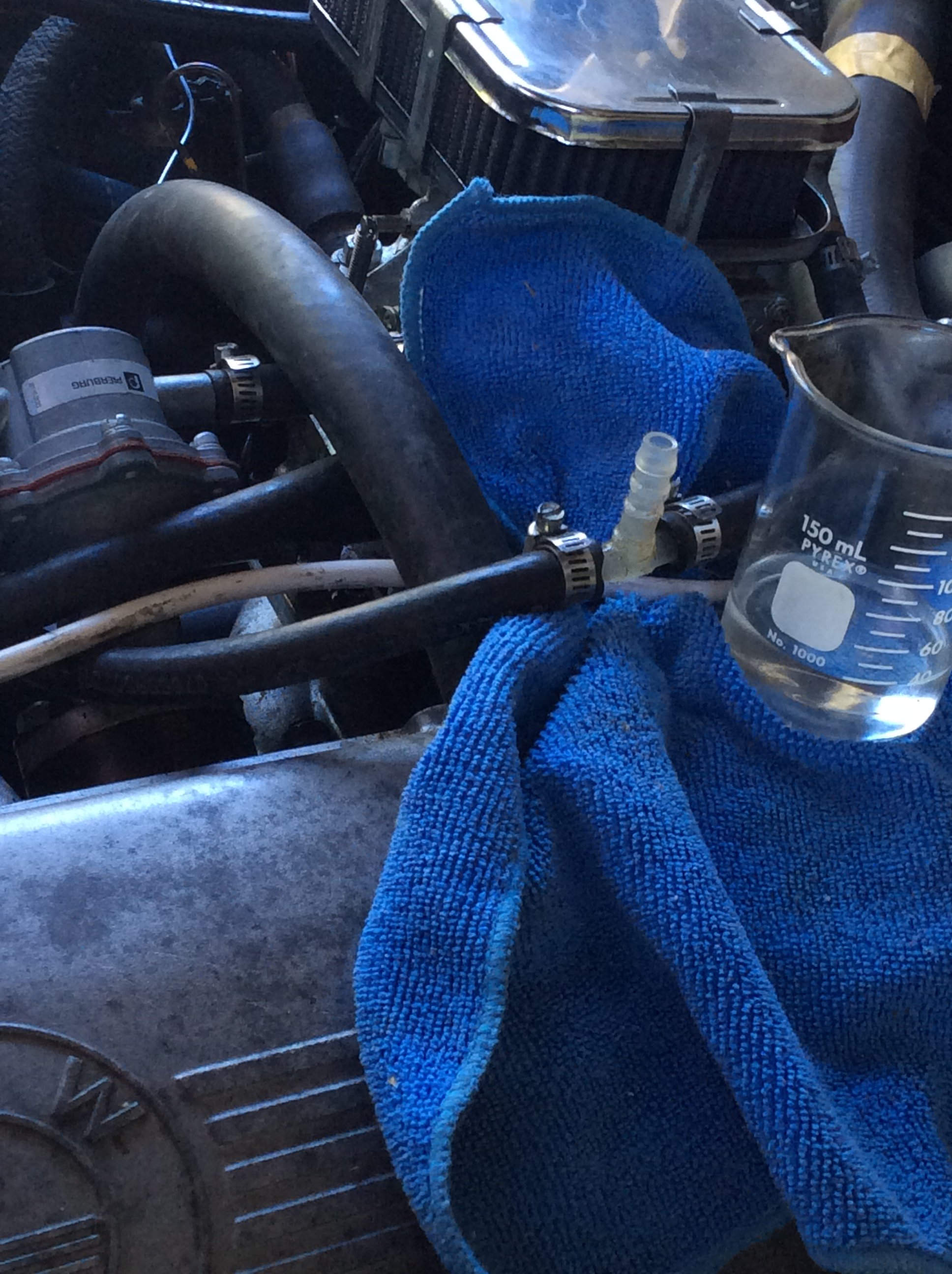

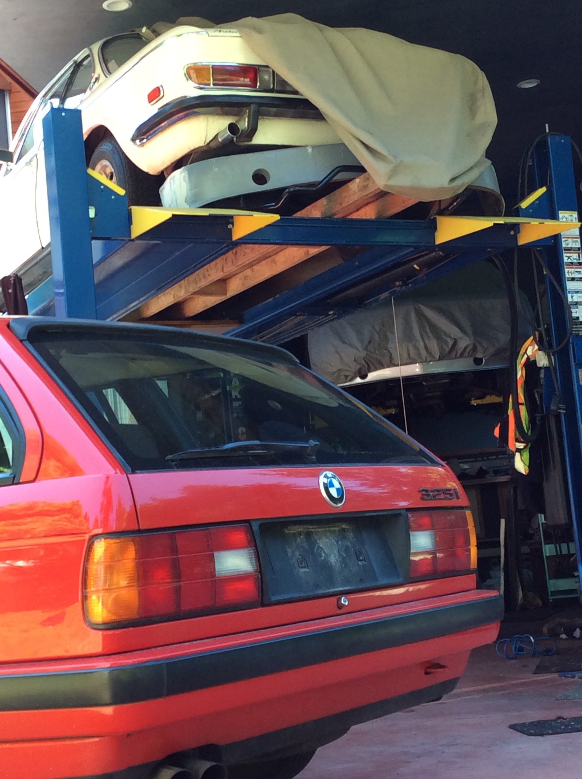

My posts may have been less than enthusiastic because my coupe has been basically been sitting up on the lift for 3 years waiting for attention.
Finally cleared up enough timespace to get the coupe down, finish the calipers, struts, change the oil, put in a battery,mount some Michelen xvs 185 and wipe the car down.
I parked it with a full tank 3 ago, over that time thirty litres of gas evaporated. Ten litters a year!
Obviously pretty bad gas and surely empty carb bowls. not a fan of Starting fluid, so I opened the gas line at the t-fitting just past the pump and gravity fed the carbs and primed the pump with fresh gas. Boom. All systems go.
Went for a spin to to get fresh gas.
Such a sweet sounding engine.
Back home without issue.
Now that I have driven the thing for the first time in three years I will be more sympathetic to your passions. :)

Nice photos... great story. especially the Manitoba part, But hey, at least you HAVE a lift! Mind if I drive up there and we can rebuild my differential? ;) Only a tunnel, 3 bridges and a ferry ride from here!
