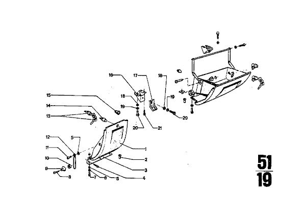

Gents, My door keep opening when i'm driving.The hook on the button lost it's spring.
Any fixes?
advice on taking it apart.
real oem shows a lock /w key... #13
# 14 is a replacement lock.
Adjust part 17.( Usually more downward) The latch action usually just pushes the catch upward.
It's angled and adjustible. I also had to take a dremel to the inside and shave a little to make the catch action better.
The second thing is to look hard at the hinge on the floorboard wall. They tend to get sticky/ rusted, etc. But you can loosen the screws- 3- and shift that cover a bit to give you a little more play for the latch.

What I have had luck with is to remove the panel next to the fusebox door under the steering wheel, then you cram your head in by the accelerator pedal and you can see exactly where and how the latch and catch meet and adjust it accordingly

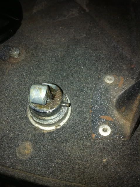

Seeing this picture reminds me that this happened to me years ago. The pin will probably fall out again. I think I put a drop of glue on the hole the pin goes into.
My quick temporay fix has been to wedge a leather watch strap along the right side. It holds up pretty well, until I go over a bad bump in the road.
