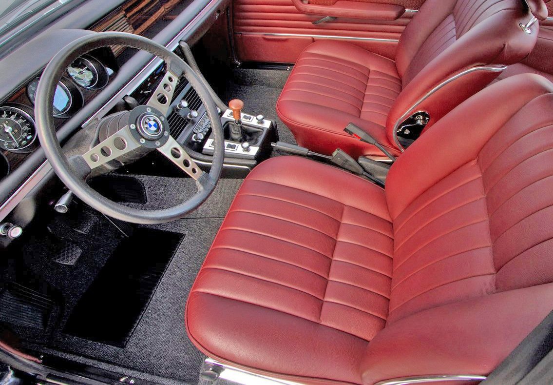

square weave is linear (in one direction). if it runs parallel to the car, then as you roll it down the tranny tunnel or along the panels under the doors, the linear pattern will 'separate' a little and show a gap. under the console, the alignment between the console and the linear pattern can look a bit distracting. when the pattern runs perpendicular to the length of the car (as in OCCoupe's previous car), every piece looks amazing because the pattern holds together. in addition, i have scheel fabric, which runs perpendicular to the car as well.

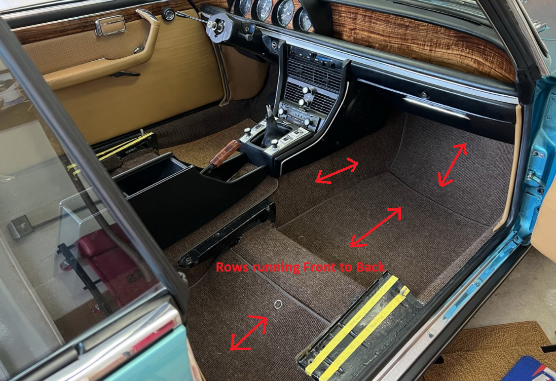

Jeez—I just ordered the German square-weave carpet from GAHH and specifically requested that the rows run front to back. I had saved a bunch of photos on Pinterest of square-weave installations in Porsches and Mercedes, and the orientation seemed to be about a 50/50 split.
Ultimately, I chose the front-to-back orientation based on this photo from the forum. It never occurred to me that the rows might separate some when the carpet bends around a curved surface, although that effect certainly isn’t obvious in this picture.
because this car has a center armrest it hides a lot of the issue. on the far side of the car under the door, you see a little of it albeit a little fuzzy. my biggest complaint is when you look at the transition of the tunnel to the floor you see misalignment. i know its not horrible, but its a detail that can be avoided by running it the other direction. as a designer, its those little details that really matter. i will also say that i think GAHH makes carpet fit better than most anybody else in kit form. the carpet in Occoupe's car was custom done and it looks perfect as it should be by a great custom installer. but what i love about occoupe's is that the layout of the material avoids misalignment.

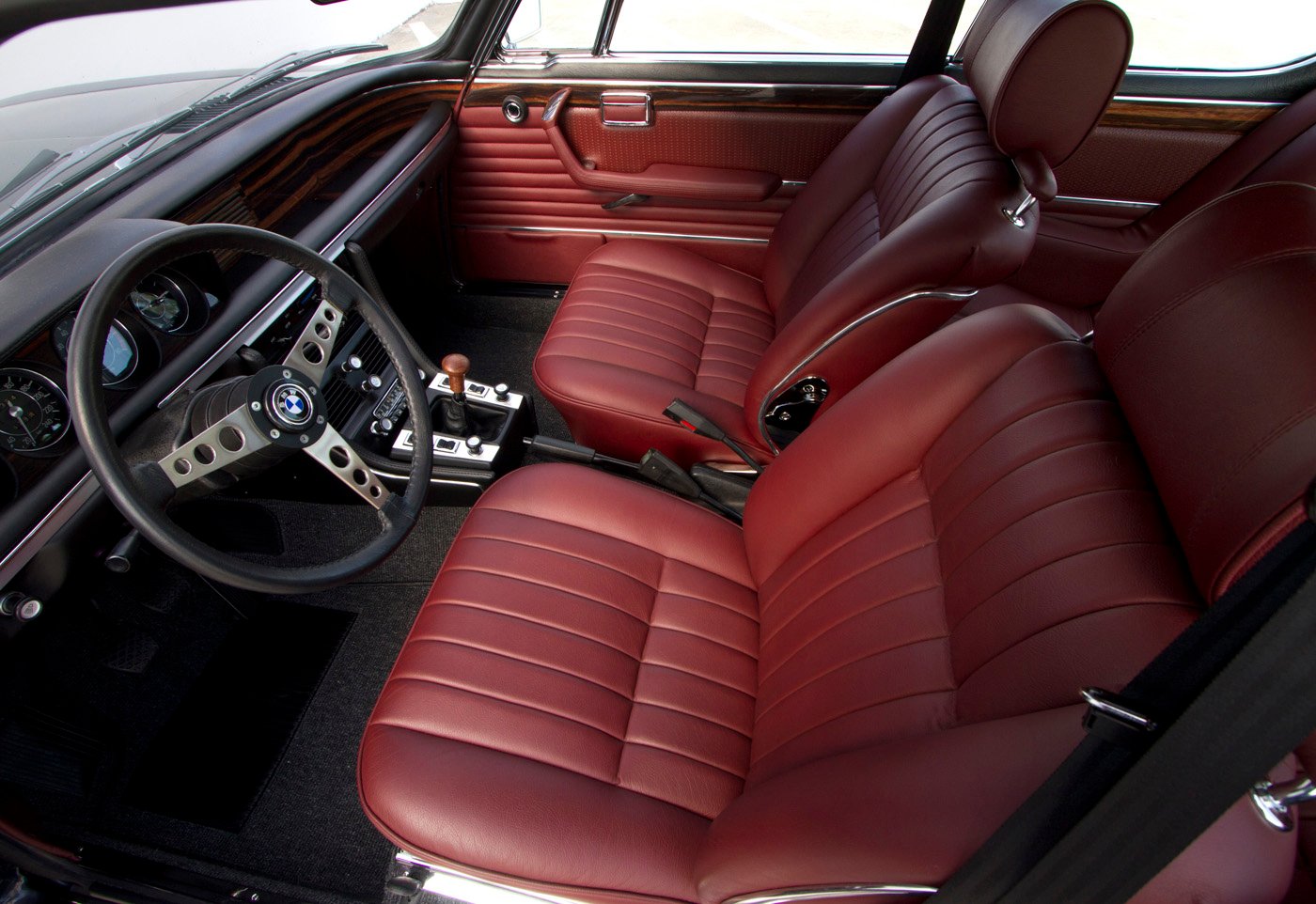

That’s @Drew Gregg carpet/coupe. Cocomats will cover most of the footwell but obviously the tunnel will be visible.
it might not bother you like it will bother me. i design luxury 5 star hotels ... and little tiny things that most people will ever notice set me off. i recognized the car so i knew who's it was. look, the carpet looks better than most ... a lot better. its much better than the KHM loop carpet i had. i am only speaking for me, what i see will probably never enter your mind. i probably need to spend the money and go custom ... i just don't know who to go to to do it right.
