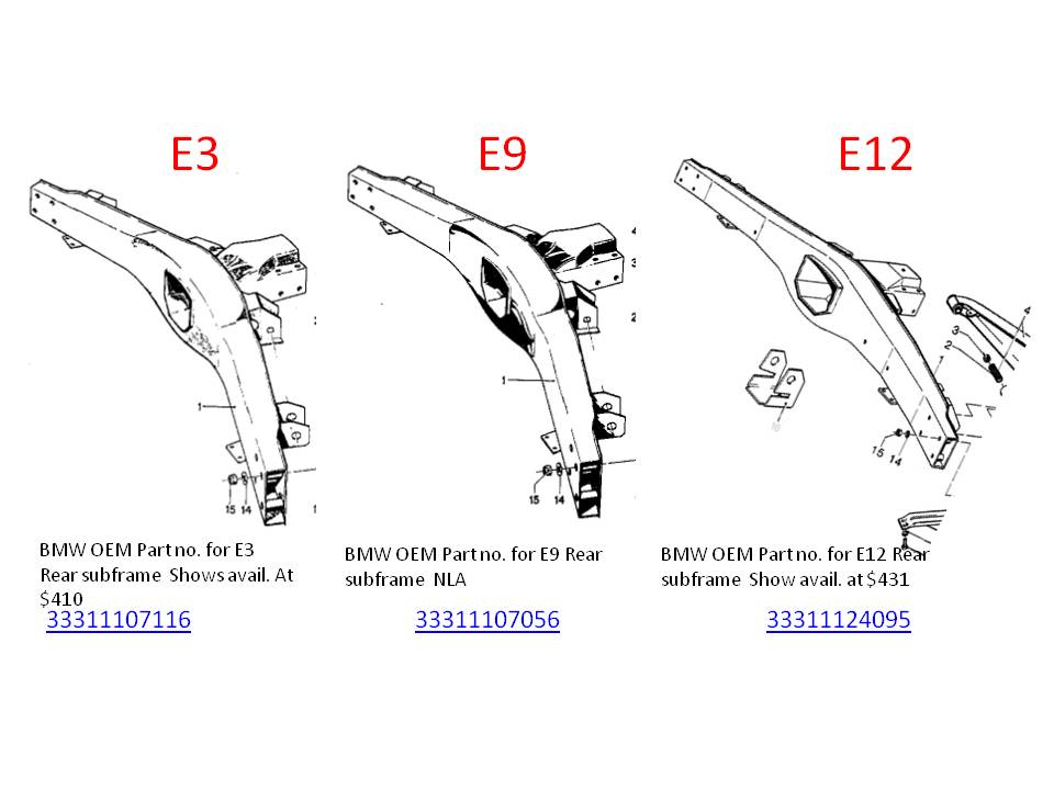

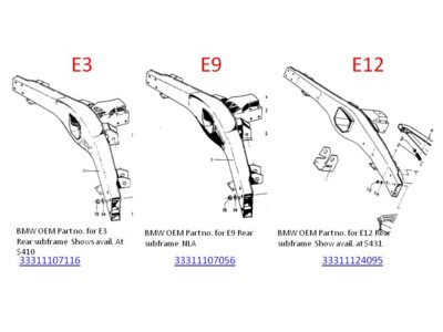

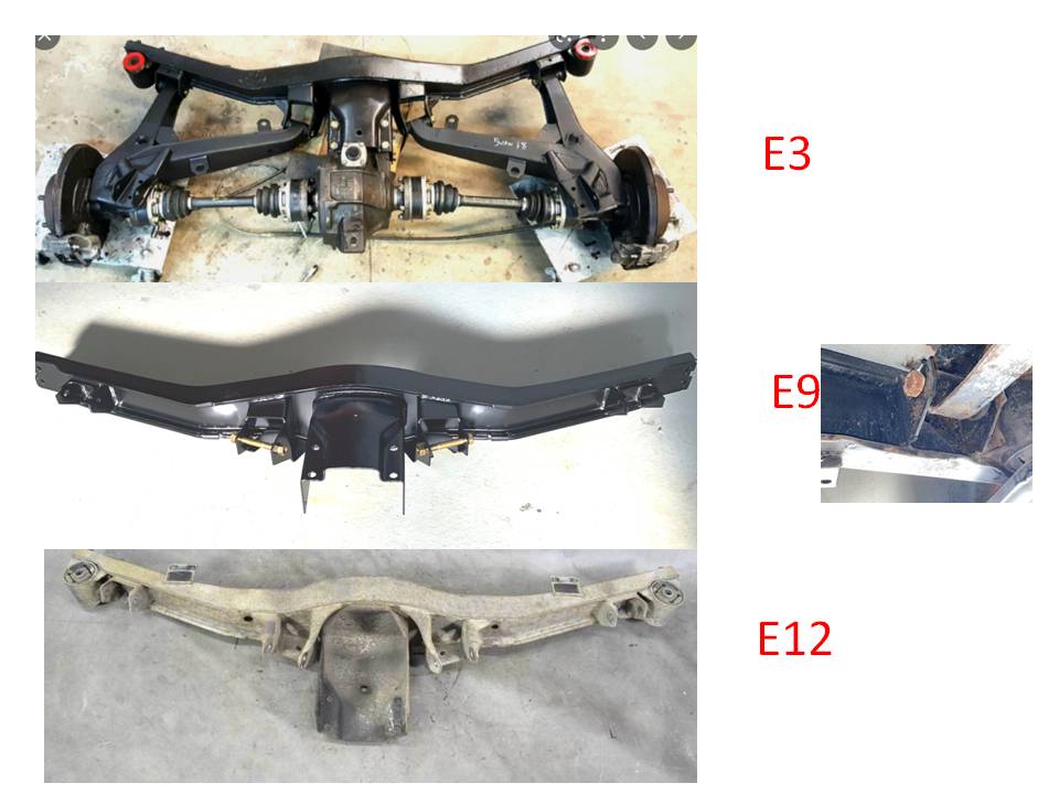

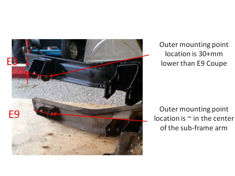

I currently have 2 CS rear subframes. The one in Patricia Mayer's car and the shiny black one that is center image on slide 2. Both are identical.
It is very clear that Bavaria (E3) rear subframes are noticeably different. The easiest way to note the difference is the outer mounting point. On the CS the bolt center line is roughly in the very center of the entire subframe arm. On the E3's it is sunken noticeably lower to the lower edge. Slide two and three show these differences. See also BMW's part no. differences including the E12, that I shot my mouth off earlier -slide 1. That's like the 17th time this week I've been wrong ;). Apologies to Ohmess and the great Al Taylor for being spot on!
A tip of the chapeau to @Mike Pelly who just provided the clearest image of these differences. Note both the inner and outer bolt hole center lines. Thanks Mike!

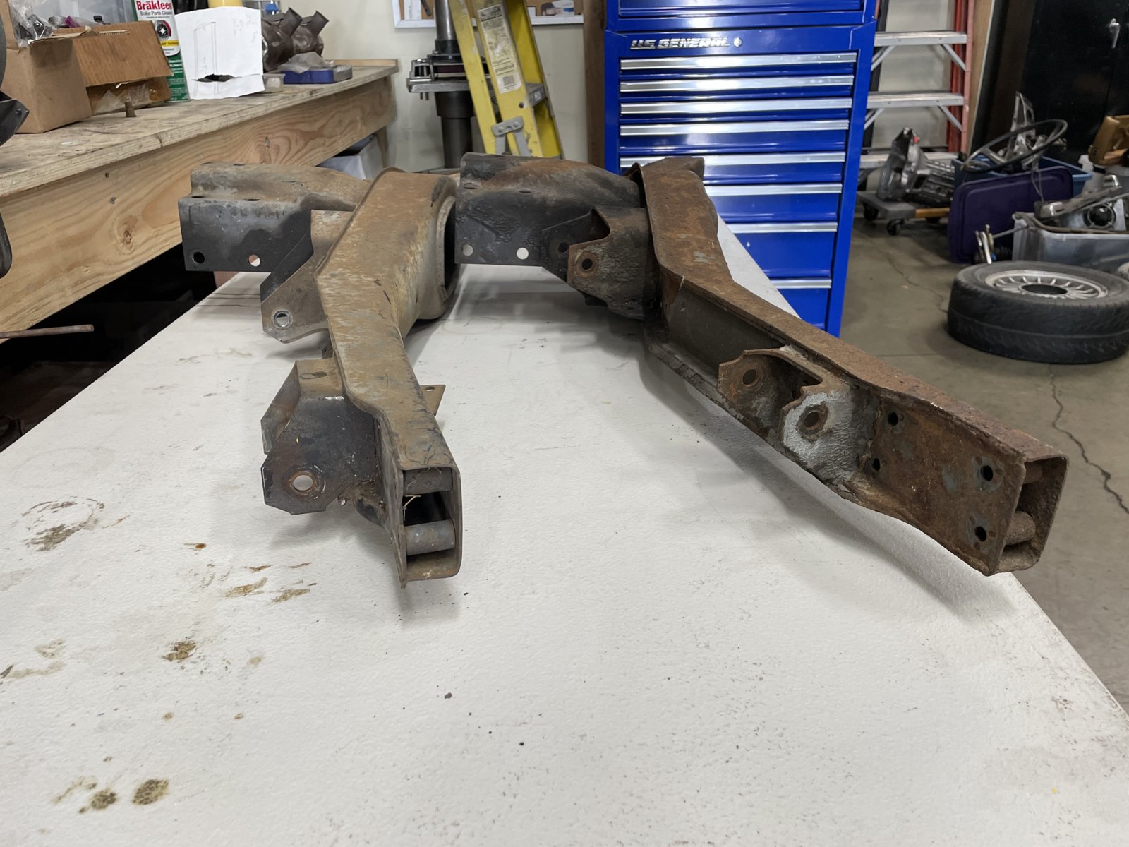

We have (1) E9 subframe for sale and (1) E3 subframe for sale this Saturday.

there is part that I am looking for it but it is very hard to know is that really from 3.0cs or not since it is not categorized there is sub frame there that is look the same with E3 and 2800cs but actually there are slightly deferent and it is garage sale you can not return and there is lots of parts are from same care and deferent model will not match but how ever I like to get there to see it myself and maybe can fined out
Candia- just wanted to make sure that you know that we verified the subframe is from a 3.0cs. We have one for a Bavaria too.
