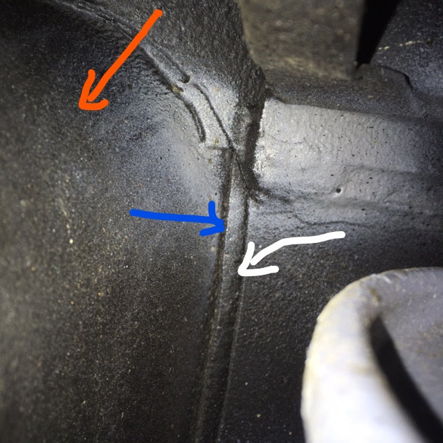

What to use for seal between gas tank and trunk floor? W&N sells some sort of foam tape. Is this really recommended for this use?
I use Grace shield. I cut a strip to adhere to the tank support lip, make them a little wider than the lip itself. Sticky side up against the tank lip.
Red arrow is the tank, blue arrow is the ice and water shield with a small amount sticking out , white arrow is the opening for the tank.
The extra width (blue arrow) stops stuff from accumulating between the tank lip and the cutout for the tank.
