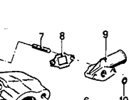

Currently re-assembling the top end of my M30, and I realized that when I pulled the Starter Valve and Connection Flange from the manifold, there was no gasket between the Connection Flange and the manifold. There is a slight residue, so the last person to work on that part of the engine likely used a gasket maker instead of the OEM Gasket (11611730741) - of which production ended years ago and I cannot find any stock remaining.

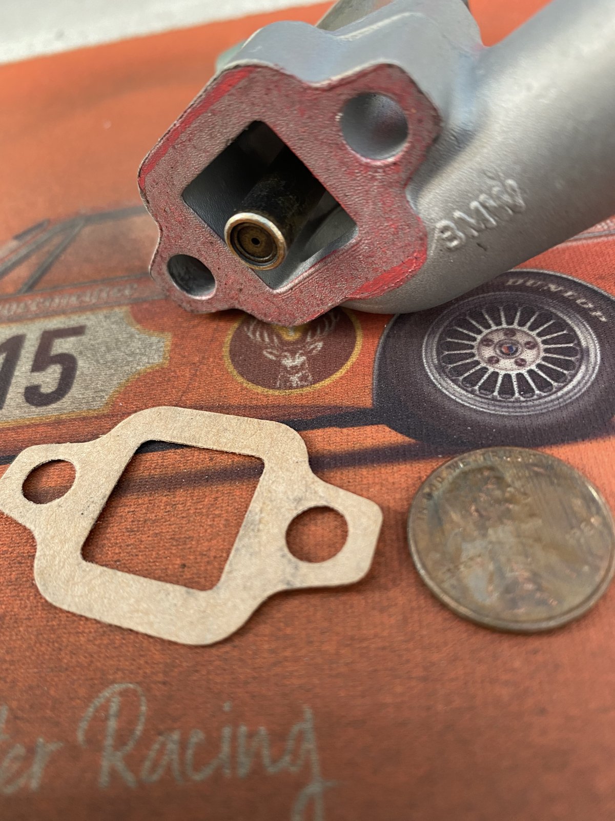

On further review (when cleaning the port), sure enough, there was remnants of an old paper gasket. Much like the C-pipe gaskets, it had become "one" with the accumulator, so it took the same method of scraping to get rid of it all.
Considering the potential of fuel contact, I've ordered gasket material and will make my own.
Thanks for all of the suggestions and replies.

Make ever so sure that your new home made gasket does not occlude the port it is sealing. The "cannon" gasket opening serves not only to deliver the cold start air from your AAV, it also has the long cold start injector shaft through and past the gasket. Getting sloppy on making a gasket too small will give you a low cold start idle.

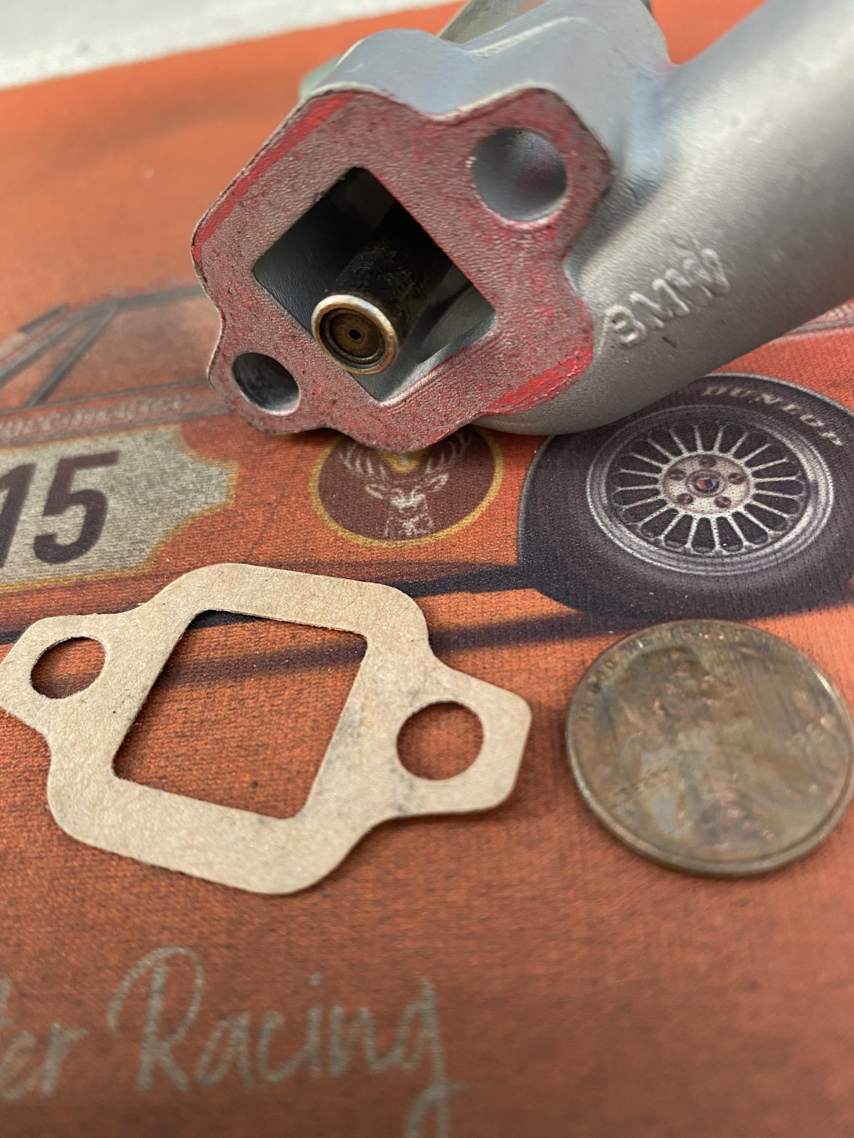

Thanks - gasket material arrived today and I think I did a decent job. I made a few and chose the best one. The most difficult part was making that 15mm square. We'll see how the low idle is when I get it all back together and ready to run.
