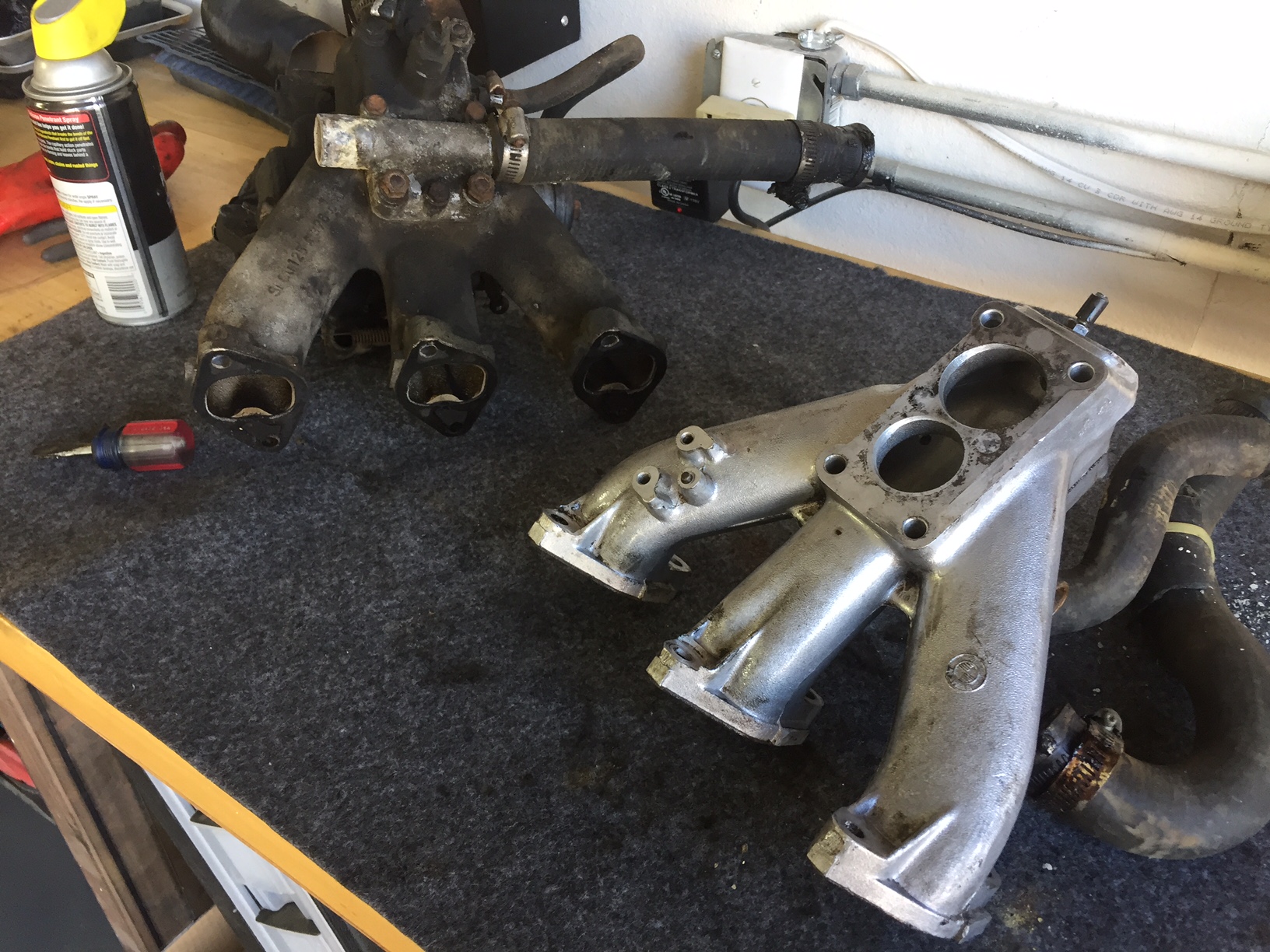

Here's a side by side fairly clean vs untouched...yikes!

Oh man...just hearing that, Chris, scares me to try the next manifold!
The 1600 I restored a few years ago just kept handing me broken bolts...it became my sand trap..
