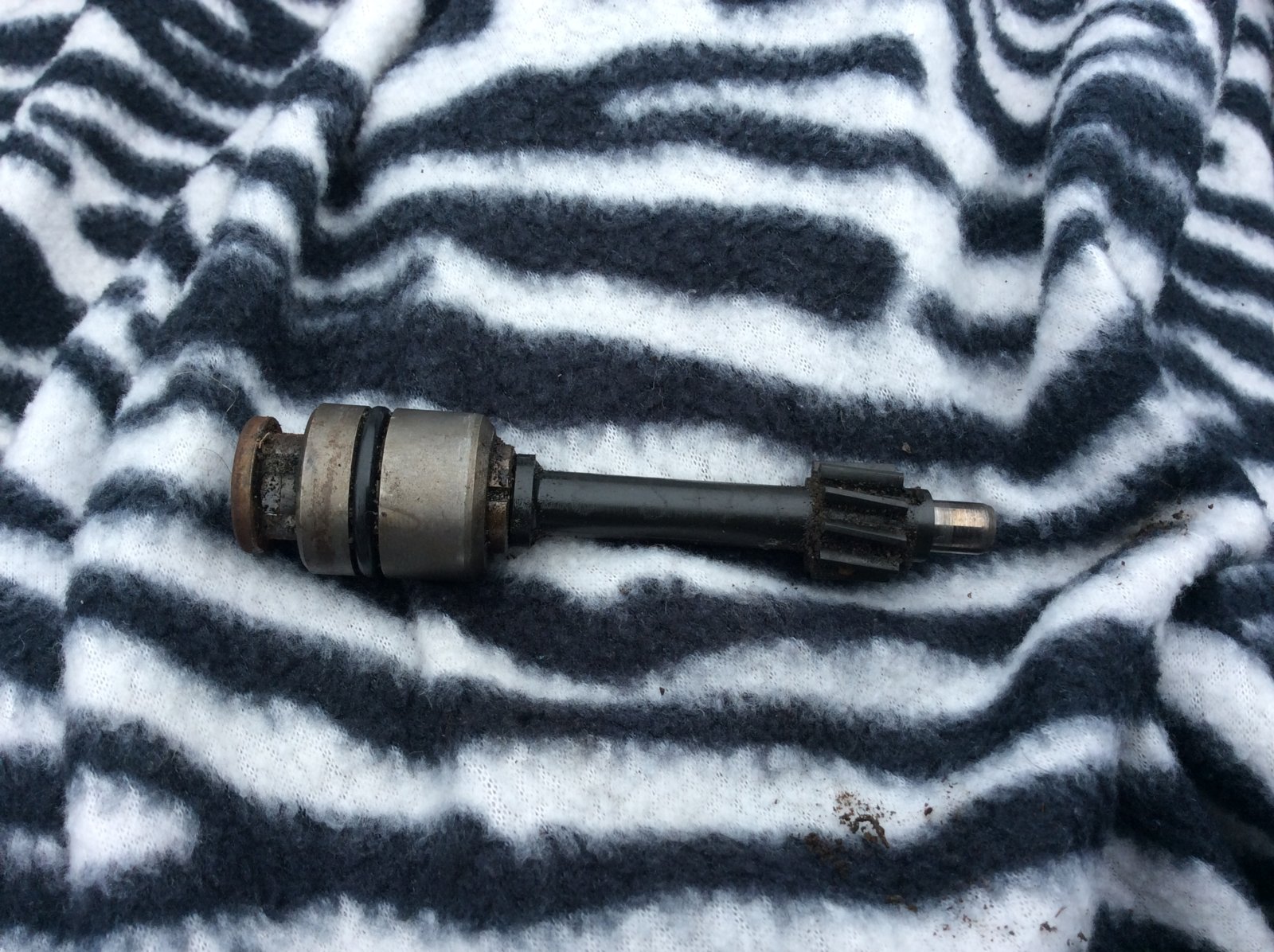

With this one removed from the gearbox:
Take a look into the hole on the gearbox where it came out, further in you'll see the worm gear on the output shaft.
I suspect this is where the long screwdriver comes into play as Don explained, put the screwdriver into the hole behind the worm gear to add tension and hit the end of the output shaft with a hammer once, then rotate the shaft and again, and again, it should pop out if you have the nut and flange + seal removed from the output shaft.

174k, if you are just trying to get the speedo drive out, I did mine a couple of weeks ago.
There is a small bolt in the side, remove that.
Then it is held in by friction from the large O ring (approx 16 mm diameter), so use a smaller flat screw driver to lever through the hole which the bolt goes into. Mine just came out when I did that.
