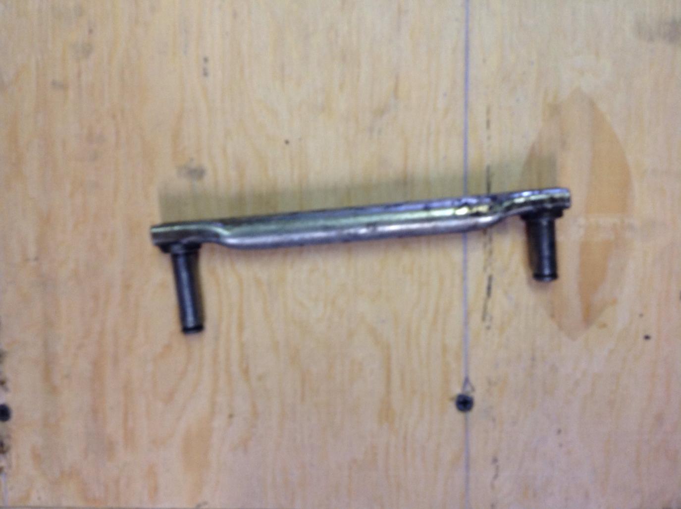

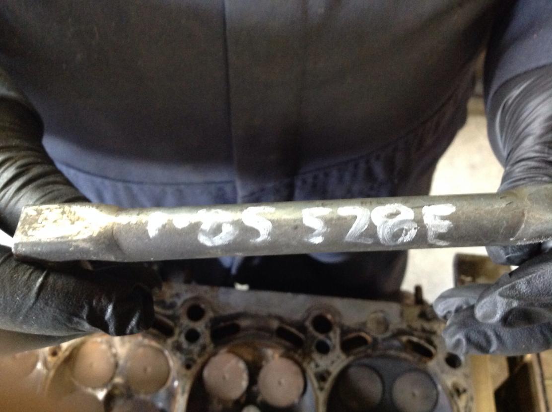

Asymmetric shift rod.....
Different lengths pic...
