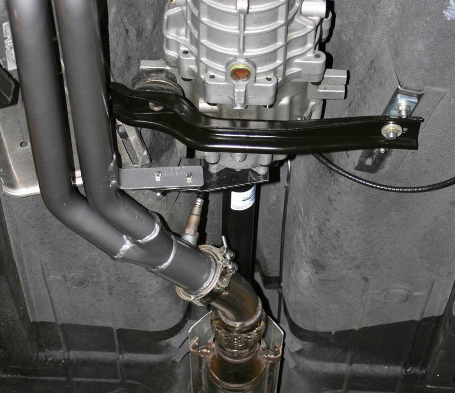

What is the solution to getting the center exhaust support installed for 5 speed conversion? I have a bracket that is supposed to work but no go.

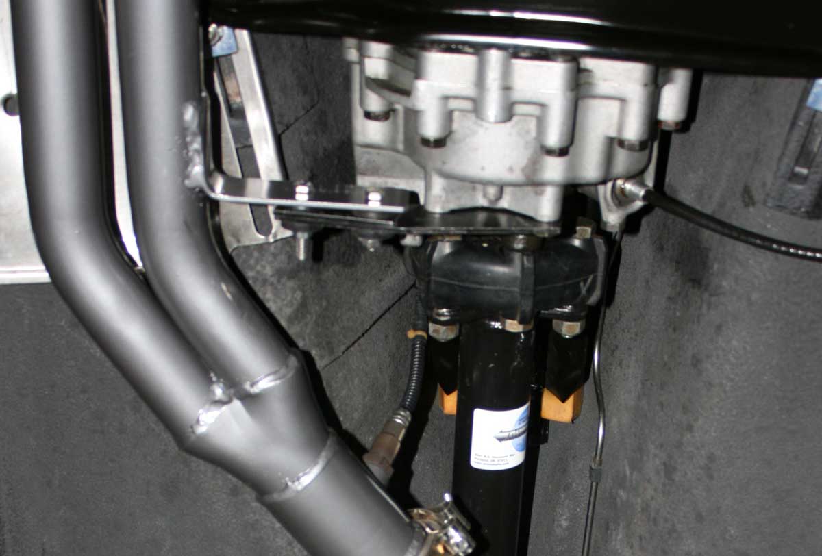

Here is what I did. Weld on a tab to the side of the exhaust so it overlaps the bracket's two bolt holes. Use the four rubber bushings as isolators between the bracket & welded tab. It will be obvious how the rubber bushings fit on both sides of the brackets large holes. There are two 8mm threaded holes at the rear of the transmission to attach the bracket to. Sorry the pictures are not that great, but hopefully you get the idea.
Bracket x 1: PN 18211102741
Rubber bushing x 4: PN 18211712091

Thanks for this and when I get a new muffler installed I will do this, I made a temporary bracket today so I could take it out on the road, I cut the original top bracket and made a bracket to fit on the tranny rubber mount bolt:
