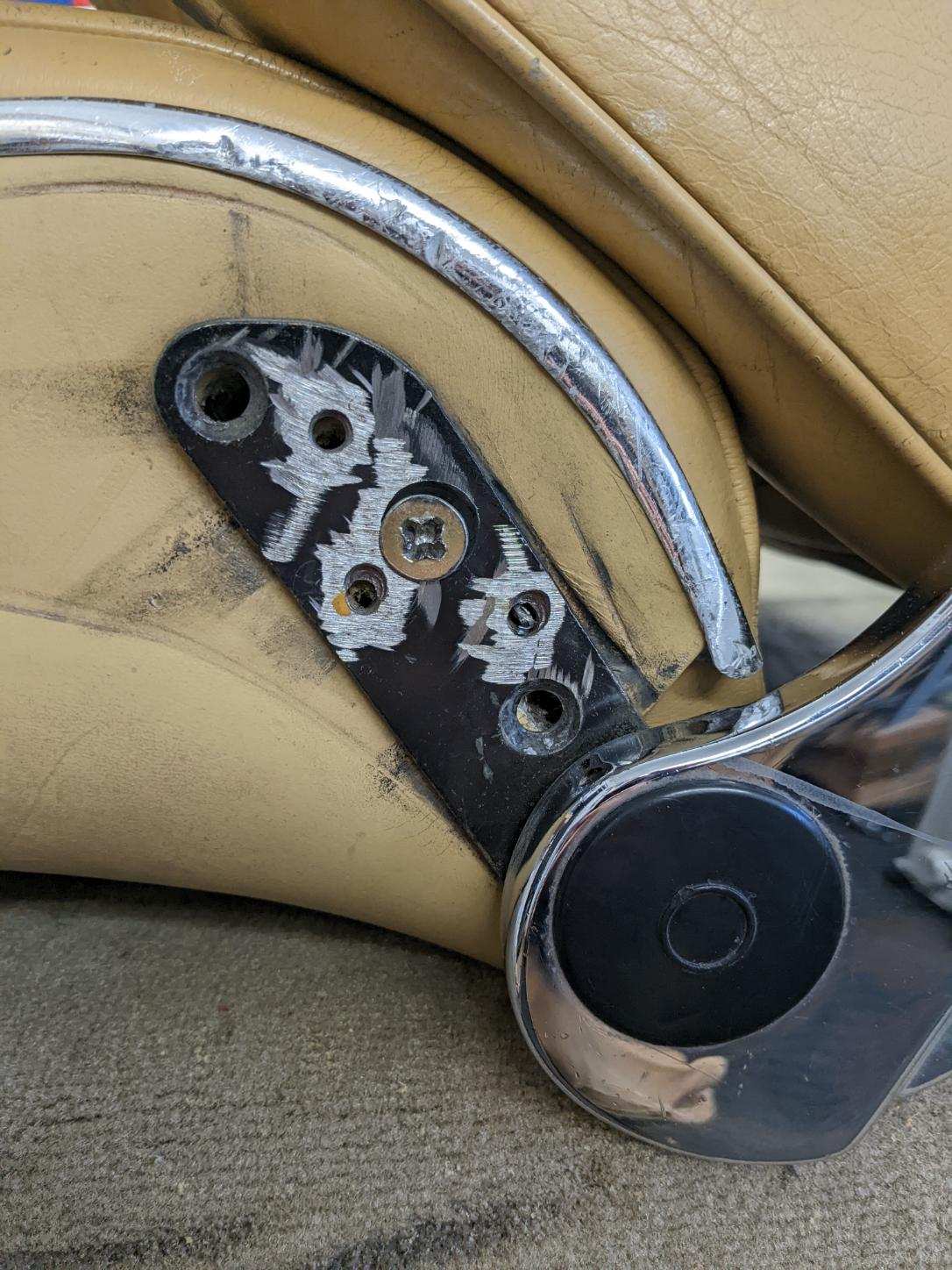

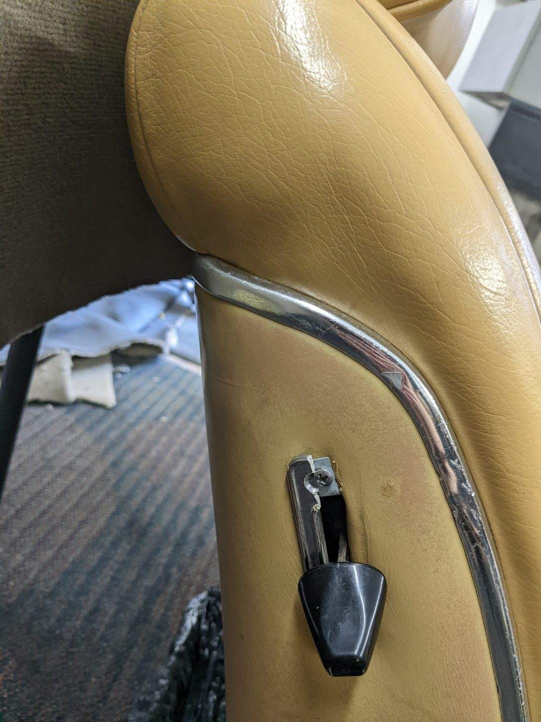

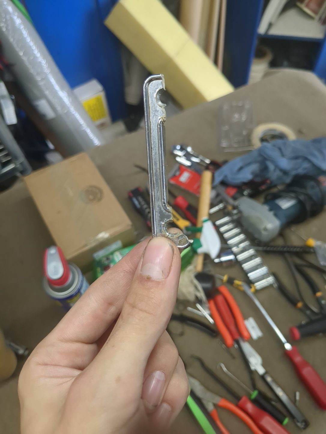

I recommend having a friend help you remove the front seats. And roll down the windows so that you can use the space to maneuver the seats while removing them.
The seats are cumbersome for one person and the seat rails can end up damaging interior parts. I messed up the ebrake handle when I removed mine and had to replace it.

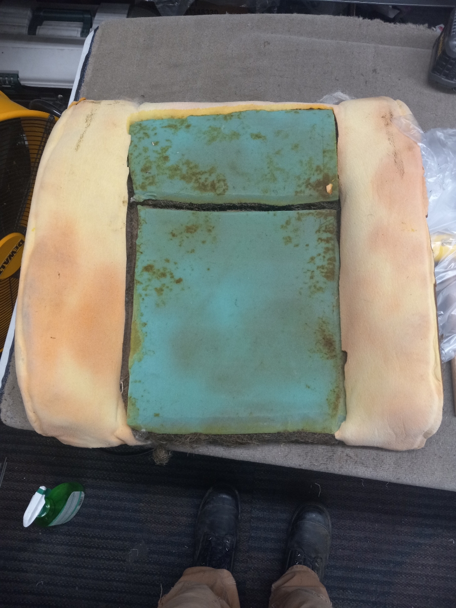

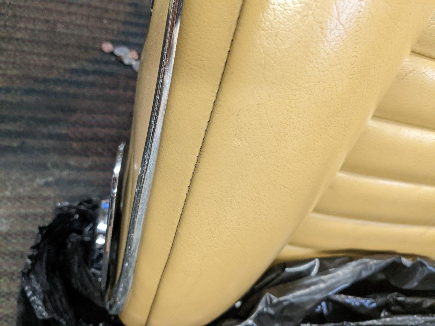

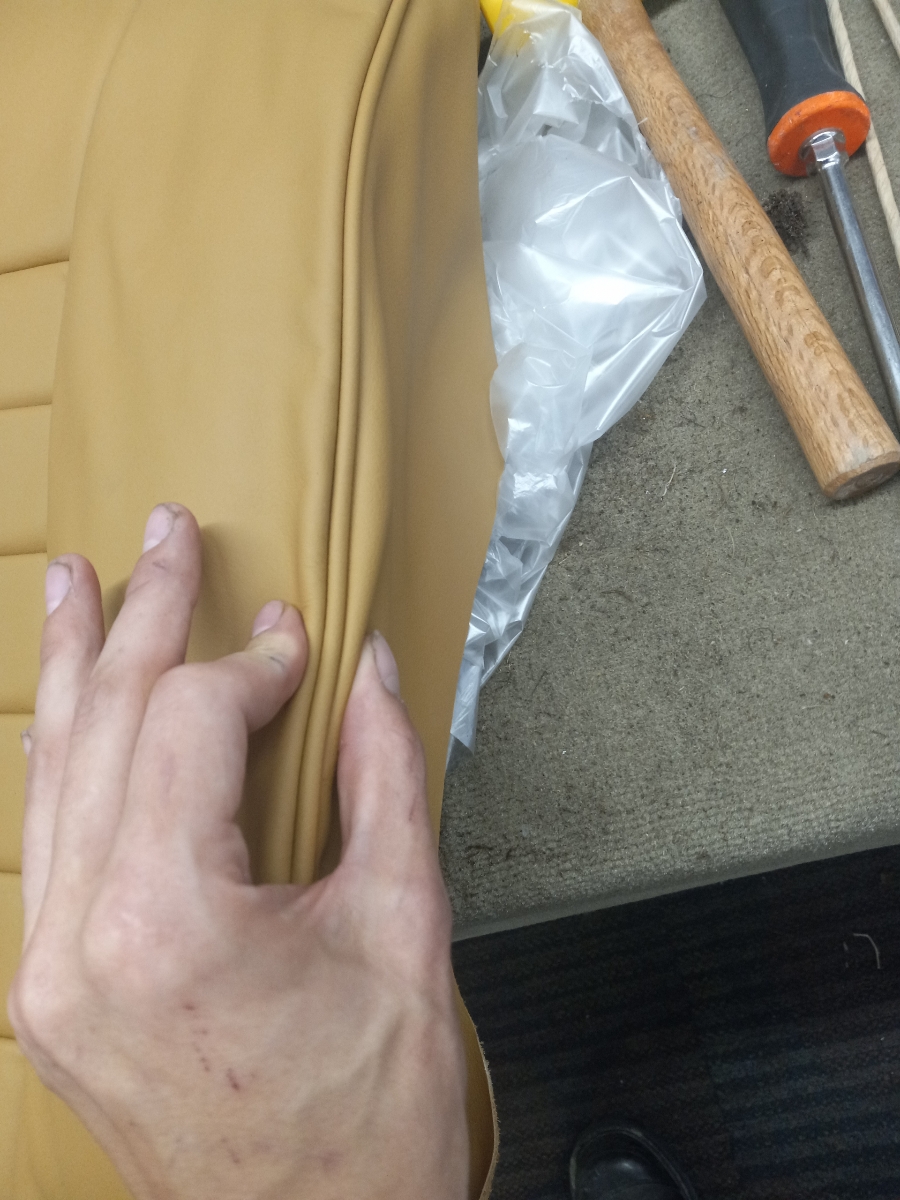

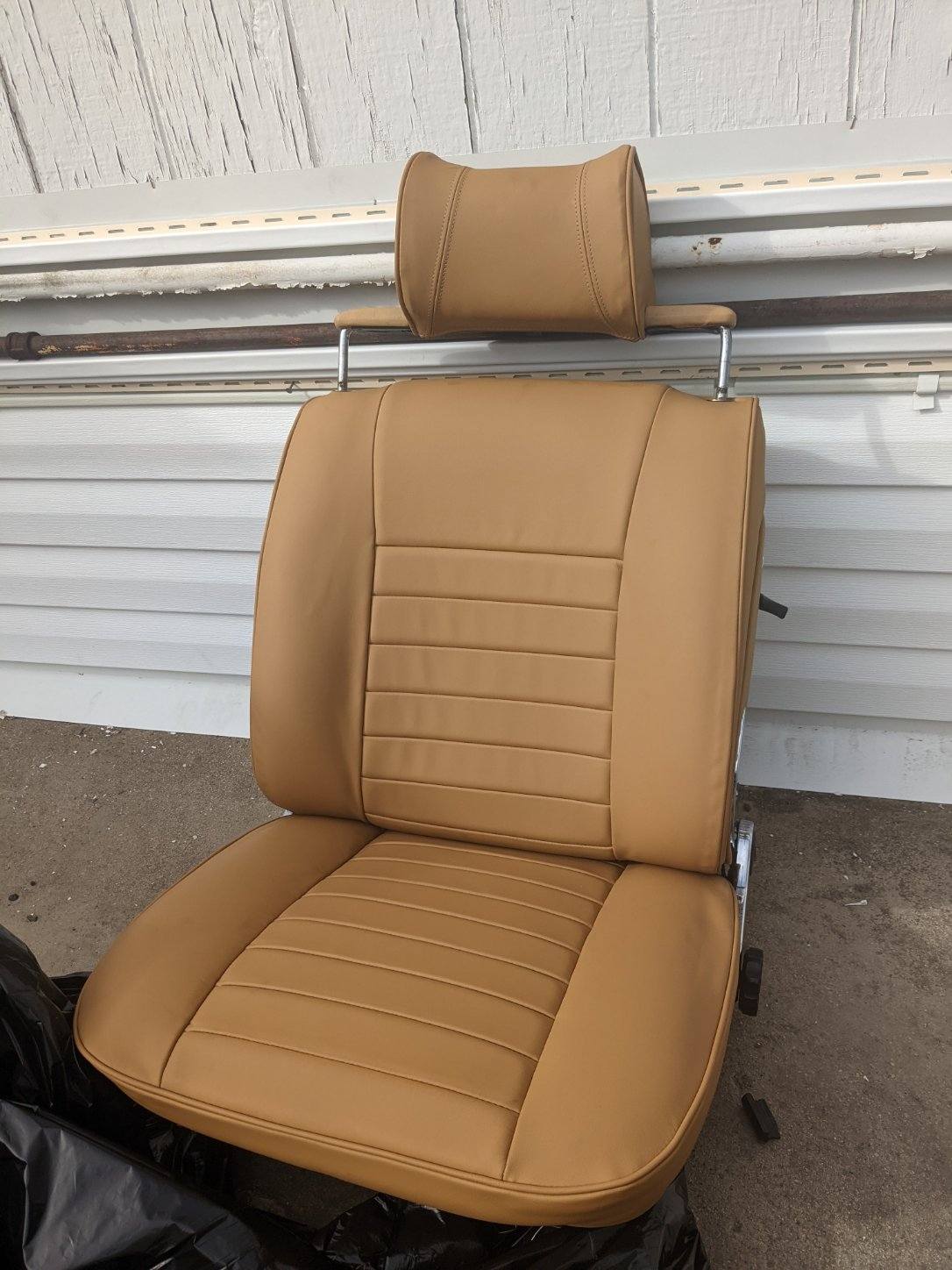

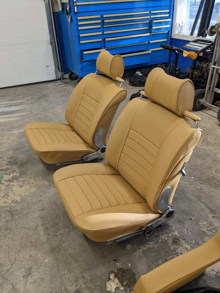

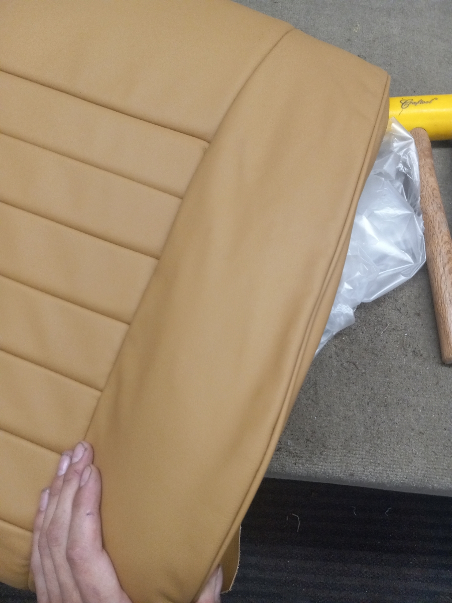

Got my seats redone. They look good. Costs $1,700 to get installed; but the guy said he lost his shirt on the install.

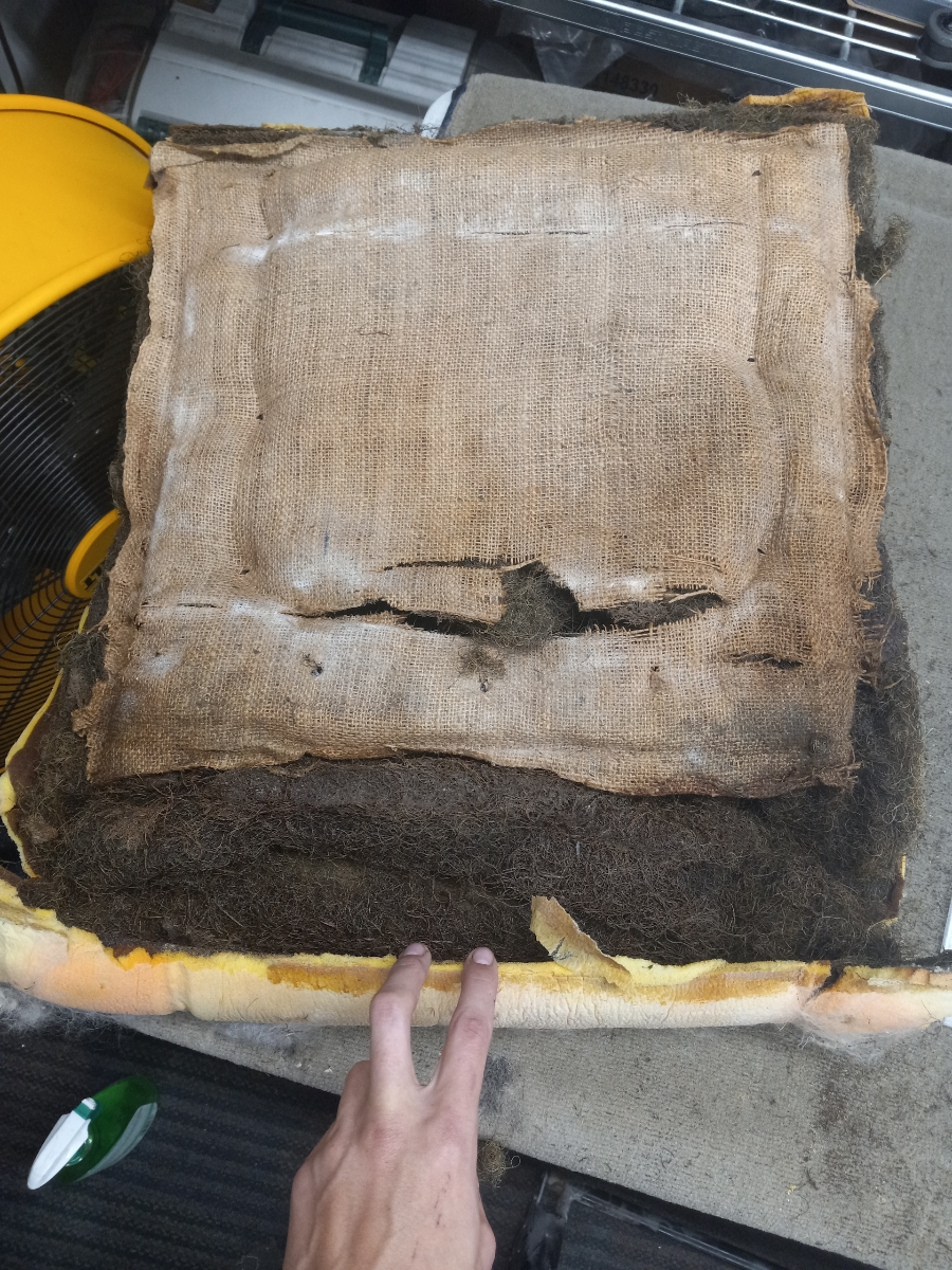

I think you got what you paid for, but you may have overpaid. As pointed out by your installer, the covers are larger than the originals. As a result, there is a significant amount of extra material. This material will not shrink. Rather, it will stretch as it gets some butt time (or paw time?). True, some sun/heat will help to smooth out the wrinkles, there will still be puckers and gathers due to the extra material. This would have been an opportunity to redo the horsehair with new or foam, which could have helped fill out for the extra cover material. My 2cents.
Looks pretty good. The leather will settle in a little after being in the hot sun a few times.
