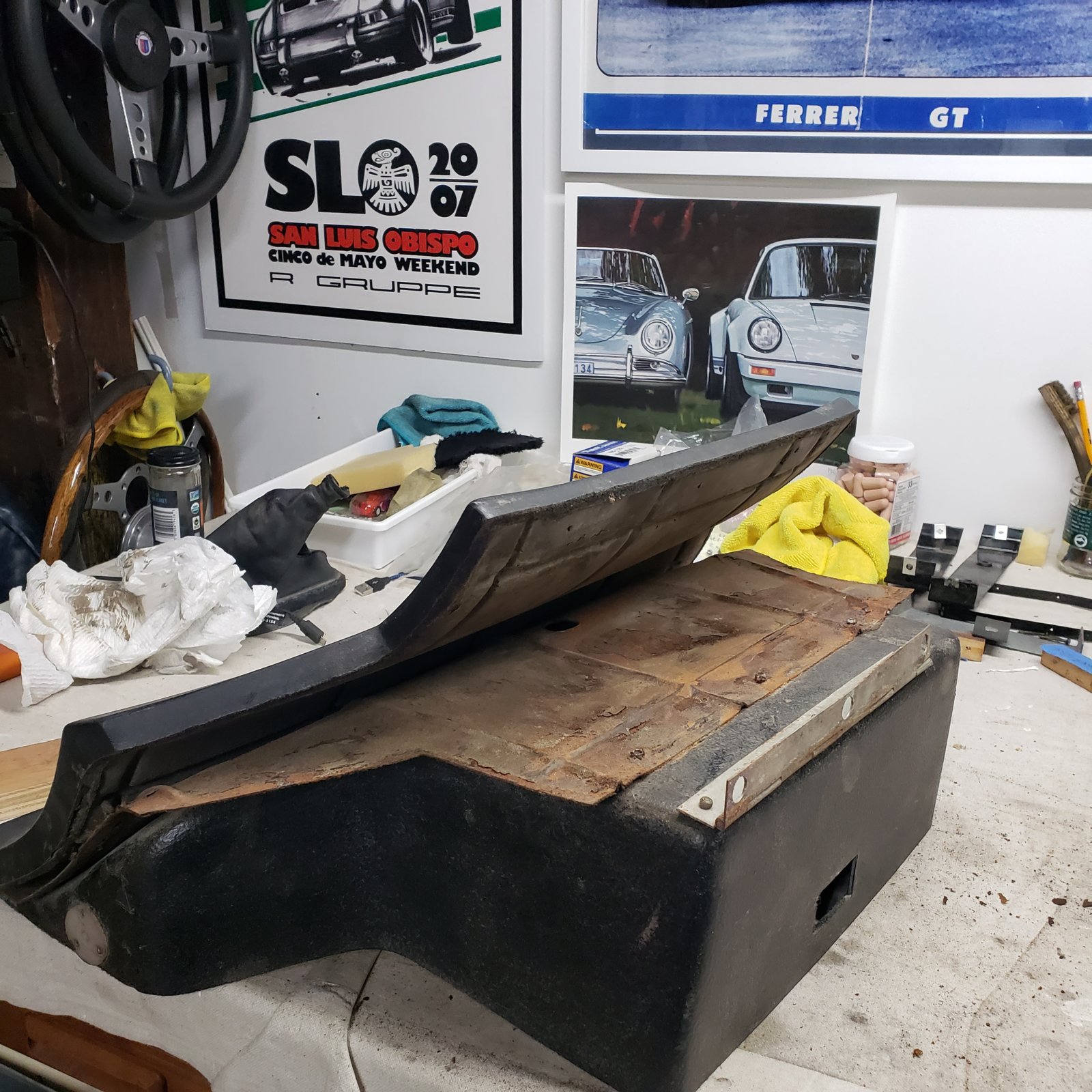

Glove box resurrection - Is it possible?

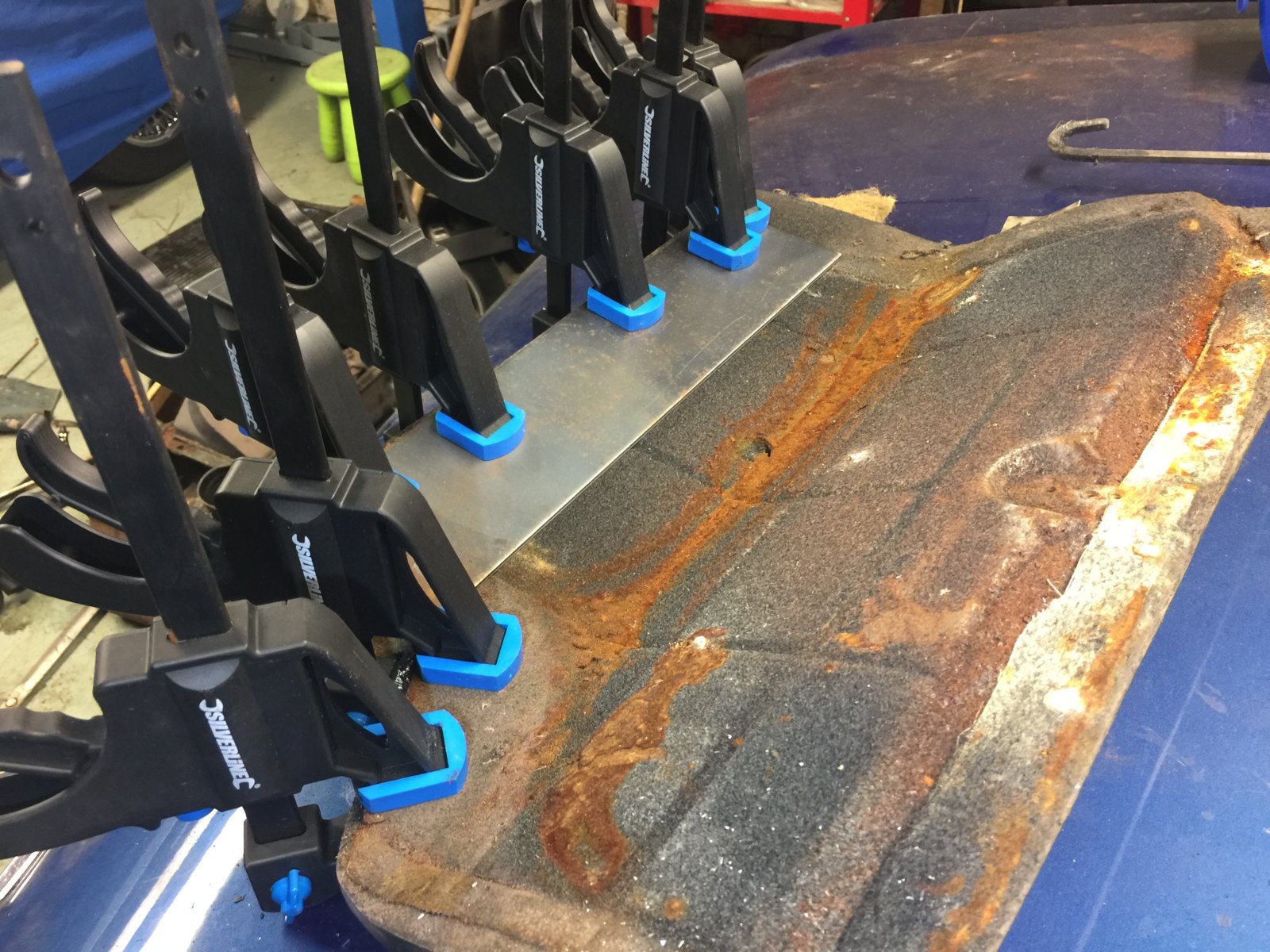

You need to make a caul. Basically this transfers the clamping pressure to areas you can't get to with a clamp.
In this case you would make a caul the same shape as the surface of the glove box. Use whatever glue or adhesive that seems to fit this situation.
First you need to clean the metal side really good. A media blast cabinet comes to mind. Just don't blast the vinyl. Tape it up so you don't make a semi-gloss finish turn dull.
You may even be able to media blast the back of the vinyl rubber.

Photo only shows flat surface cauls. You need something to form to the shape of the front of the glove box door. A piece of 1/8 ply might be suitable. You could even wet the wood and clamp it to the front applying a little pressure at a time to get it to take the shape of the front. Put some sort of soft material between vinyl door and wood.
Then after heating and applying adhesive of choice put the plywood with a piece of felt on it on the door and then you can run some of the cauls across and then start clamping. May have to use the cauls on both sides of the door so you spread the pressure out over the whole area.

Tyson, i had been thinking about what i would do to try to reform the face material. i would cut out ribs in the shape of the glove box - spaced to provide 3 braces for the box. so if the box was new it would fill the void. by using a 1/8" piece of plywood, and heating the foam, you could draw it into form with clamps as Gary as suggested.
@m5bb @rsporsche - Great suggestions guys. Yes, I understand the caul strategy and using ribs almost like stringers. The problem would be how to get the correct angles. I'd likely need one in excellent shape to get the template correct. It may be easier (not easy) to take it in sections and run the cauls from side to side like 1/3 at a time, giving each section a couple days to set up. I'll have to figure out what to put between the cauls and vinyl so they don't get dented with the pressure.
The base has a lot of surface rust and old glue so it may just be easier to drill out the rivets holding the glove box part and the vinyl foam metal base together, and seperate them and sandblast the entire base and restore it so the foam will have a much better chance of adhering to it. The challenge then becomes getting it back on square. I'll look at it more closely tomorrow. Thanks again for the suggestions!

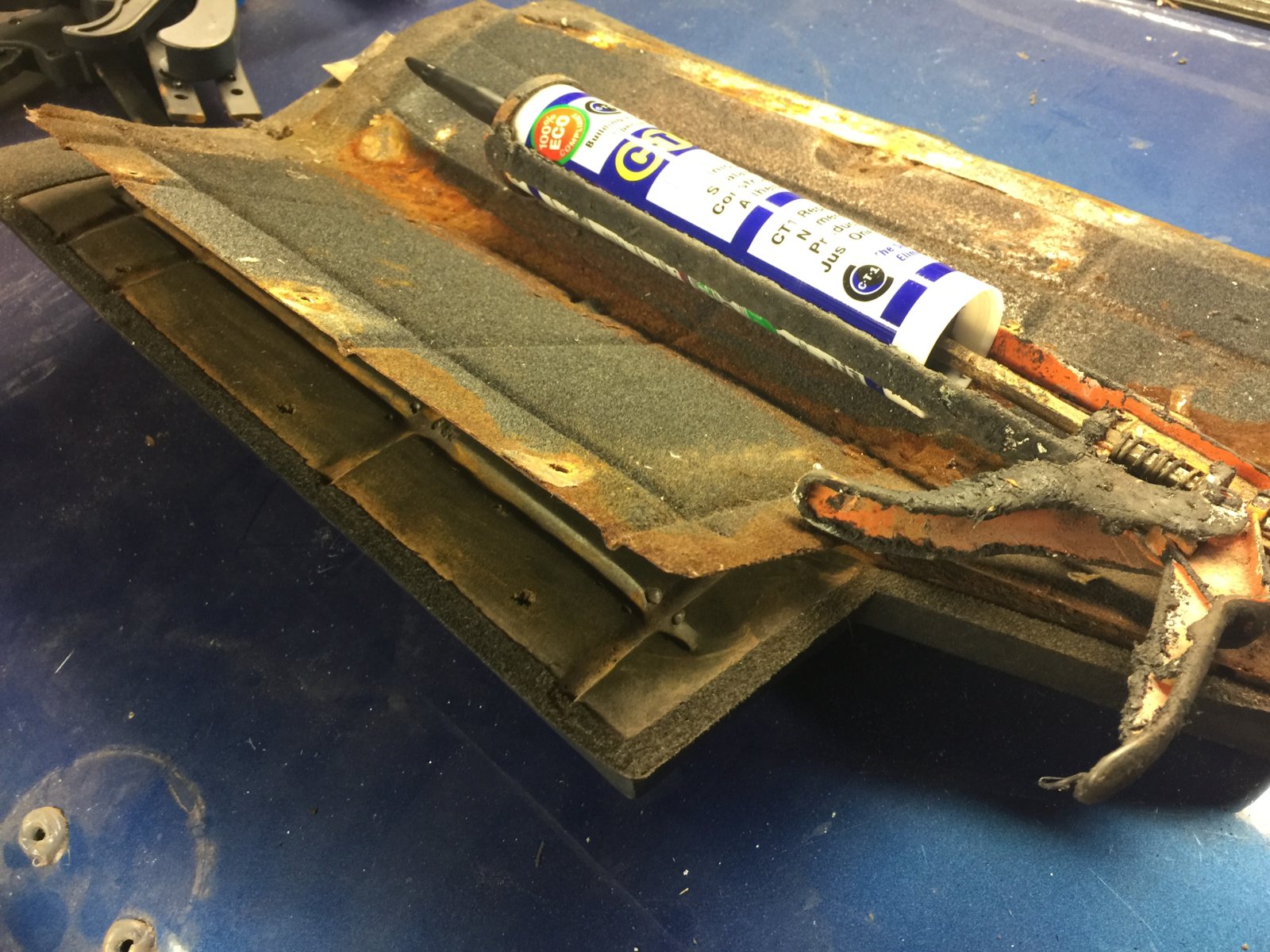

i did mine a few years ago - i used a product called CT1 - its a glue/ sealant -- its stuck like hell....

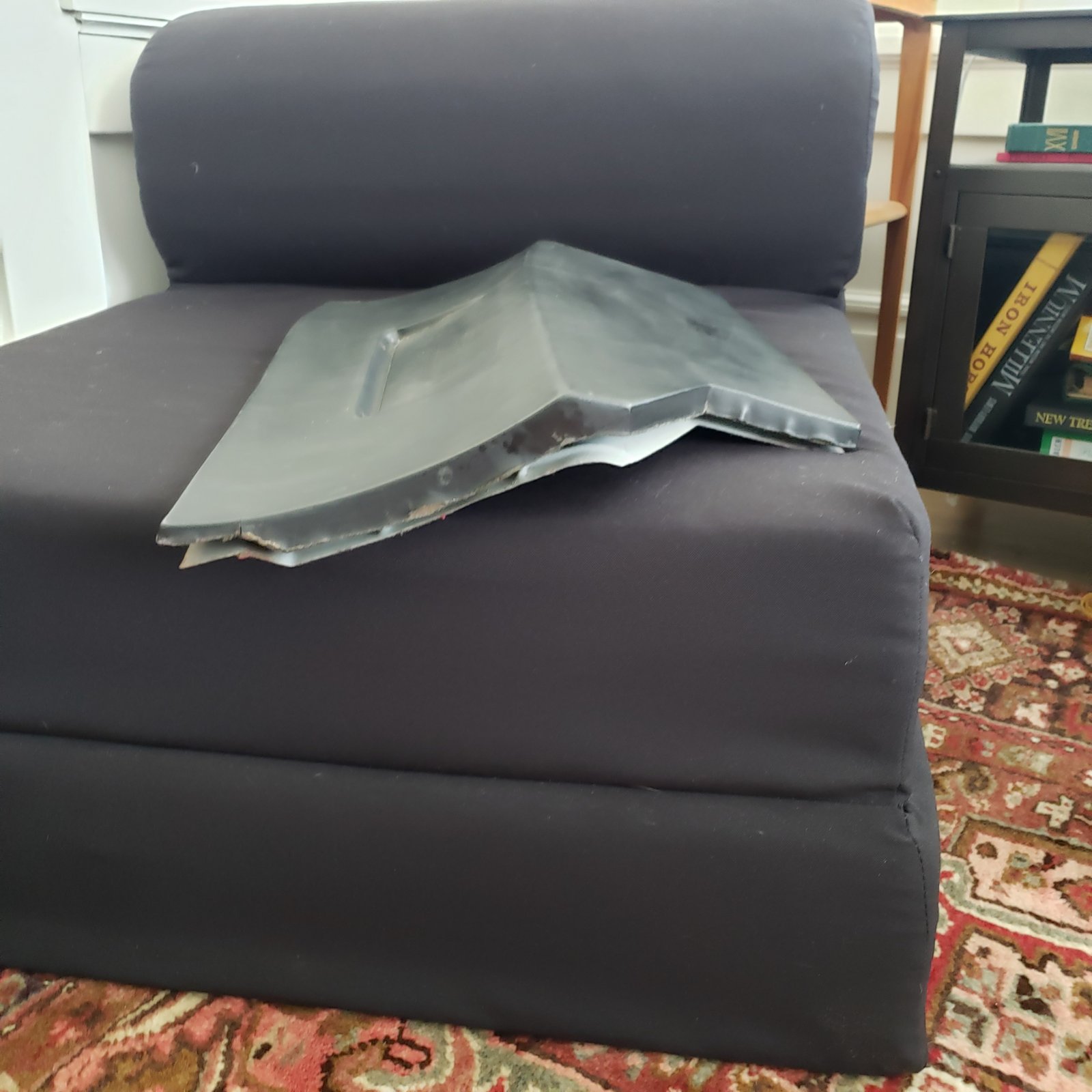

Well after several slow rounds of heating to about 170ish degrees, the panel will be easy to get back down to the base now. Really amazed at how it responded.
BEFORE :
AFTER:
Now we have an N=2......... Congrads. I would not use any form of glue till you have re-mounted on to the flocked part so you can get the original contour. Do some dry fitting runs in the car.
