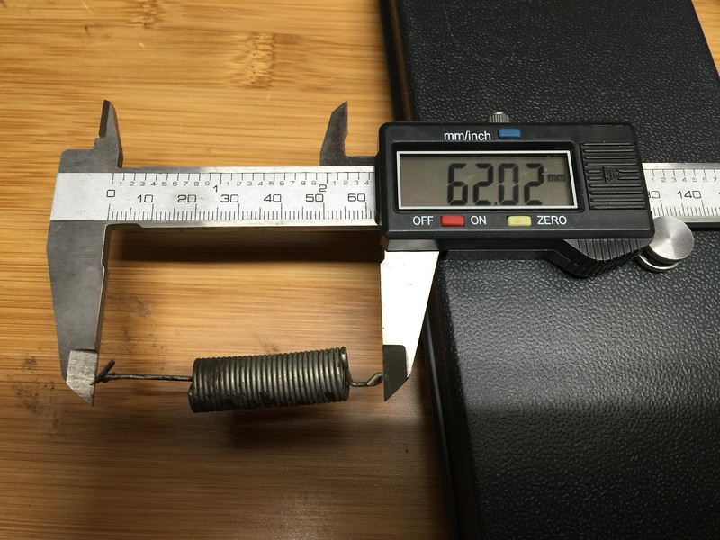

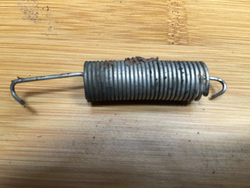

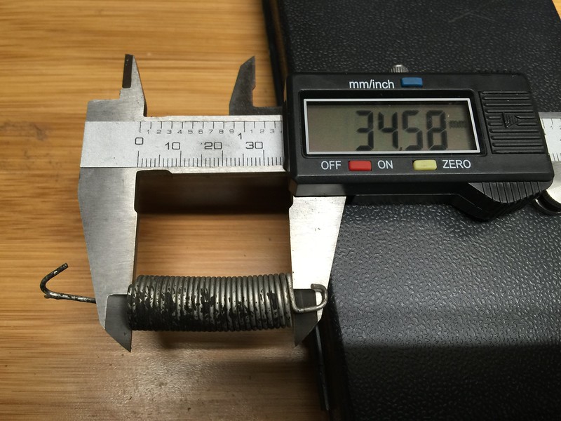

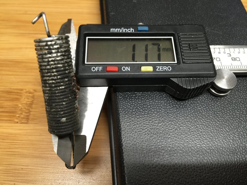

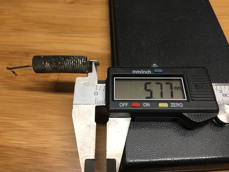

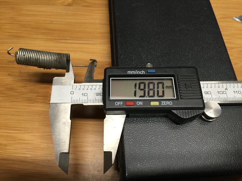

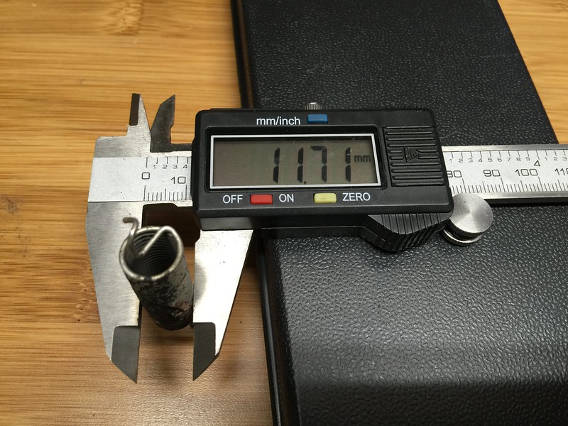

Took lots of pics. Post them later. This is a good example of "a picture is worth 1000 words".
Overall length: 62mm
Cool length: 35mm
Long hook length: 20mm
Short hook length: 5mm
Outer Diameter: 12mm
Material Thickness: 1mm
Coil count: 29mm
Coil Spacing: 0mm

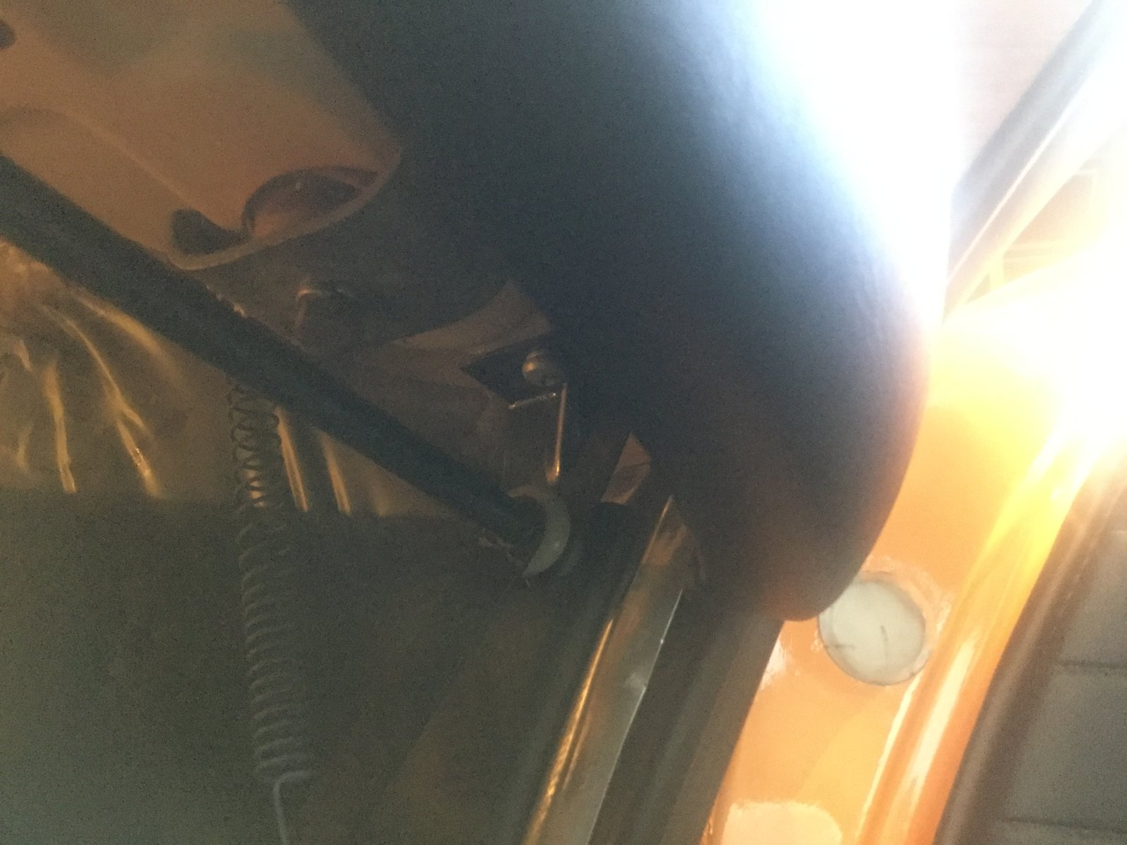

I found this one image from HBChris but I cannot tell where the upper connection is. I have a tab under the dash with a hole in it and set it there, seems a stretch. Perhaps correct.
bmwpaul
81
38
Dorset, England.
Hi I’ve just stripped my glovebox and your correct it goes onto a tab, I had a job to remove mine it was stretched to extreme when box is open.
