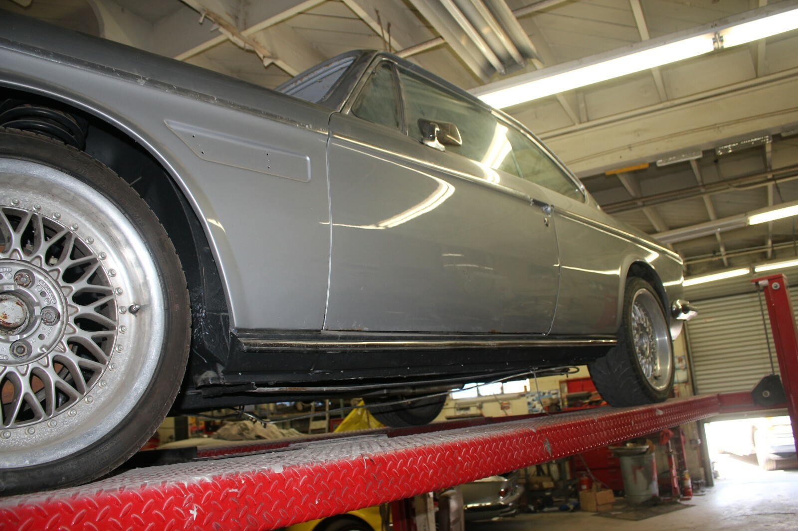

Could be a deal if the body is super super solid and done right.
Could be just dirt on the bottom of those doors.

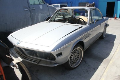

I have a friend who is over his head trying to correct rust in a coupe that might be terminal. He is interested in just picking this up. Has anyone seen it? Condition of interior or quality of paint and body repairs?

I haven’t looked at the pics, but it does have work done on it. The pic that @teahead posted shows lower front fender work. Make know of the weld bead running vertically. Not any type of red flag but just and indicator that someone was mitigating some issue at some time.

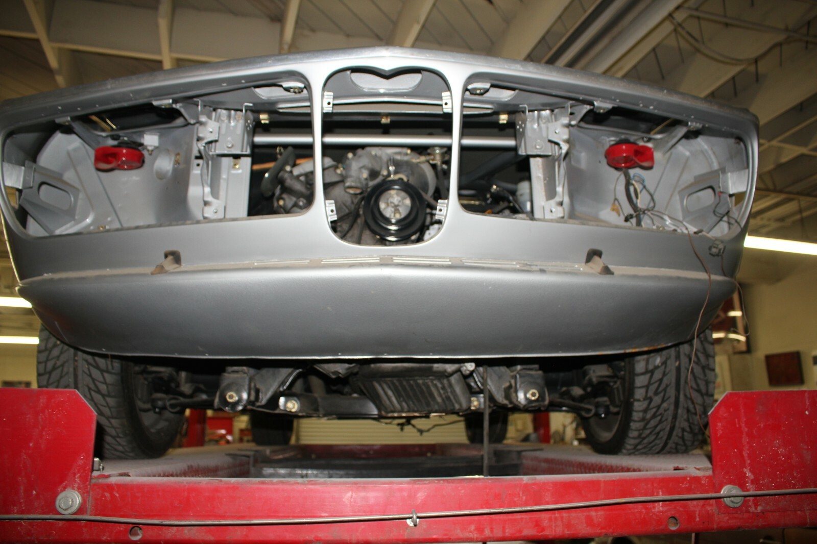

It appears they painted over rust ... already bubbling through lower door panels ... rust evident in rear shock towers ... and no photo of spare wheel well .... if I am correct the shiny paint job will have to be redone after the rust is properly abated. Ditto engine ... if they redid it when it was out, as they suggest, then it appears it was a sloppy redo .. the sump looks badly mutilated. And I would want to be sure the executor signed the title over legally.
Maybe, maybe not. The 'rust evident in rear shock towers' could be the factory adhesive aged on the Polaris paint (the combination looks a little orangish rust color). I had a Polaris csi that had shock towers that looked exactly the same but there was no corrosion. I agree with teahead, it could just be dirt at the bottom of the drivers door, the car looks like it's been sitting awhile.
I also agree with ccr2002, someone should go look at it. Looks like it has potential be a great start for someone.

New member here with an update on this car. I’ve been to see it: judging from the VIN it is in fact a 71 or 72 2800 cs, not a CSI. It’s structurally decent: that is rust on the underside of the door but otherwise seems reasonably solid overall, interior, carpets, etc are out so easy to floors. The car was recently painted to an OK standard, but the paint prep failed on the passenger fender and there are several bubbles. Otherwise looks decent. Later injection motor in it (sorry can’t more specific).
