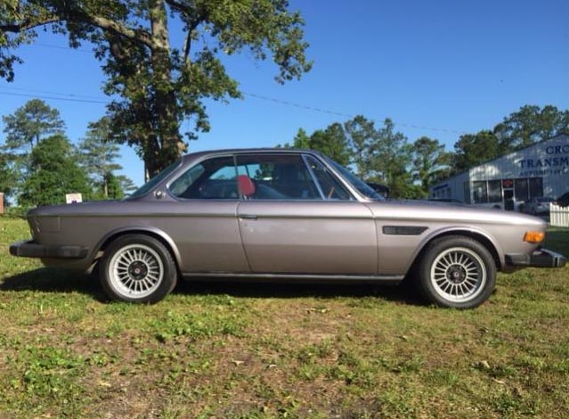

I got a much anticipated package in the mail yesterday. My ground control suspension came in and it looks beautiful. Putting this setup in my coupe that has bilsteins and 16" Alpinas, but otherwise stock setup. Not planning on slamming my coupe to the ground, but want something slightly lower than CN Springs. Once installed I'll post an 'after' photo and let you know how it performs. I have a different coupe with CN Springs, ST sway bars, blisteins, and 16" Alpinas to directly compare the handling to, so this should be interesting. Photo is of the coupe that the suspension is going on; hoping to get rid of that lifted 4x4 look.

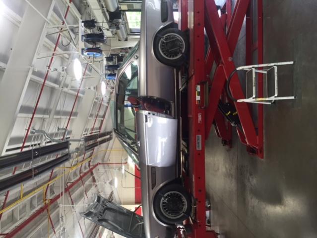

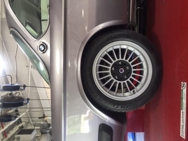

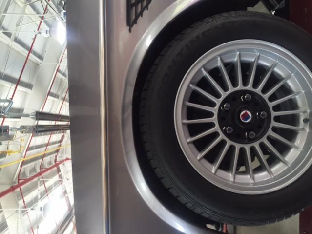

Enjoy the shots of the new set up. Sorry for the sideways shots. If someone can tell me what I'm doing wrong I'll fix it. Car is on the rack getting aligned; will take better pictures later.

Photos
I suspect your computer's software isn't honoring the rotation information embeded in your photos by your phone. If you are using a conventional camera, it may not include any rotation info. Or, your computer does honor the rotational info and shows you the photo right side up, but the web software doesn't, so they are rotated.
I'd make a small change to the image, like cropping it a bit and then saving to see if that will set the rotation the correct way up.
I've lightened the shadows a bit using Photoshop to make it easier to see the tires and the space above them. Easy to do, if you have PS. Other programs have a similar function labeled shadows/highlights or somthing similar. I use this command a lot as most images are a bit too dark when there are bright areas in the photo.
Ian
You da man Ian, thanks. Used an iphone 6 to take the pictures, transferred the pictures to a macbook via email.
