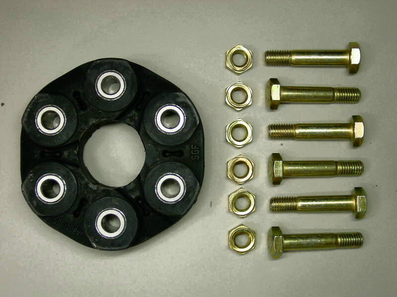

I wouldn't dare to use nuts with a plastic ring ('Nyloc' as there called in Europe) as I think the radiant heat from the exhaust may well bake the plastic, losing the friction function it has. For the same reason I wouldn't trust Loctite, as that starts to lose function around 200 degrees Celsius (400 Fahrenheit), and completely disintegrates around 250 degrees Celsius (485 Fahrenheit).
You raise an interesting point regarding nyloc nut heat exposure. However, if this was a serious concern, the factory would have issued a technical service bulletin advising against using nyloc fasteners for this purpose - or at least recommend very frequent inspections. (If you are concerned about the nuts' structural integrity and longevity what about the bolts? Look at link below depicting a worn bolt shank.)
It is prudent, whenever a critical fastener's condition is in doubt, to replace it. Still, I can't recall hearing about any drive shaft's dropping or detaching from the transmission specifically due to a fastener failure. This doesn't mean it hasn't happened, but I can't recall hearing about it. (Discussion at bottom describes fastener wear or failure - but not a catastrophic drive shaft detachment.
There are obviously exceptions, but typically, the weakest link in the drive line is the fat rubber jurid joint. When the joint is in bad shape there is generally fair warning due to significant vibration. (Of course a few may look perfect until they are removed.) Next, those six 12M bolts should be properly torqued (see chart below) in which case, when it comes to torsional stresses, the nylon portion of the nut is relatively insignificant as compared with the metal portion of the nut. The nylon's function is mainly to arrest vibration and its clamping force is de minimus.
IIRC, a rule of thumb when employing nyloc nuts is to measure the torsional resistance when the nut is "free-threaded" on the bolt or screw. That resistance, might add up to a lb./ft. or two - on a large fastener such as a control arm bolt. And that additional resistance is added to the overall torque load so that the combination of the two torque measurements equal the recommended torque. Given the generally wide latitude of torque recommendations, the math is not that critical. Aircraft applications generally require more care with arithmetic. ;) Naturally, as the nylon is abraded from use or exposure to the elements (including heat), it tends to offer less resistance, and that means less resistance to add to the total applied fastener torque. Loctite is fair insurance, but if one is truly going to rely upon it, as a substitute for metal on metal clamping power - then one may as well safety wire everything. I am unaware of any particular Loctite formula's temperature tolerances. However, I think it a fair bet that neither the transmission nor the drive shaft and related components never reach 200 C or 400F unless they are directly exposed to engine exhaust. Maybe exhaust fasteners?

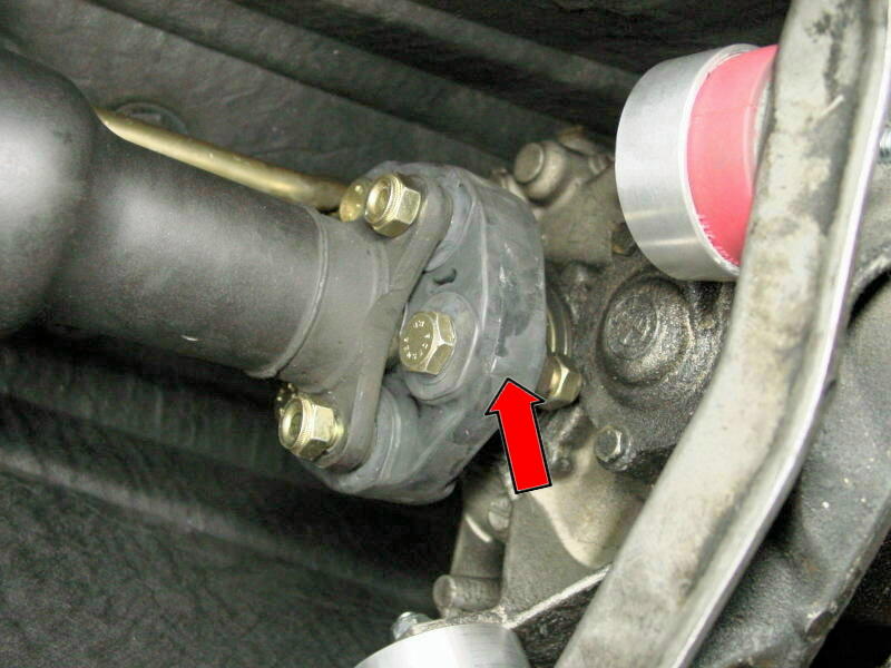

For illustration purposes.
A discussion regarding why Jurid Joint fasteners should be inspected. http://www.bimmerforums.com/forum/showthread.php?2069040-WHY-you-need-to-be-sure-the-guibo-nuts-bolts-are-tight Cause or effect? Chicken or Egg? Please note that nut and bolt failure may not have had anything to do with using nyloc nuts or the fasteners themselves. Could problem have arisen by merely leaving bolt loose (finger tight) or other worn/defective components?
Maybe it's just me but I went out of my way to get a German made M5 guibo, not the chinese crap that is abundantly available. You don't want to do this twice.
Hardware failure, human error and/or an operator asleep at the wheel?
If someone forgot a bolt or failed to properly tighten the nuts/bolts, it hardly matters whether the nuts were nyloc, castellated or even all-metal elliptical. Would think an alert driver might have noticed something wrong well before being disabled. But maybe it is not that surprising. People have been known to run out of petrol and drive on virtually flat tires.:rolleyes:
Looking at previous post I noticed something not mentioned -- bolts paired with elliptical or oval locknuts, similar in style to the nuts used to couple the drive shaft to the rear axle.
