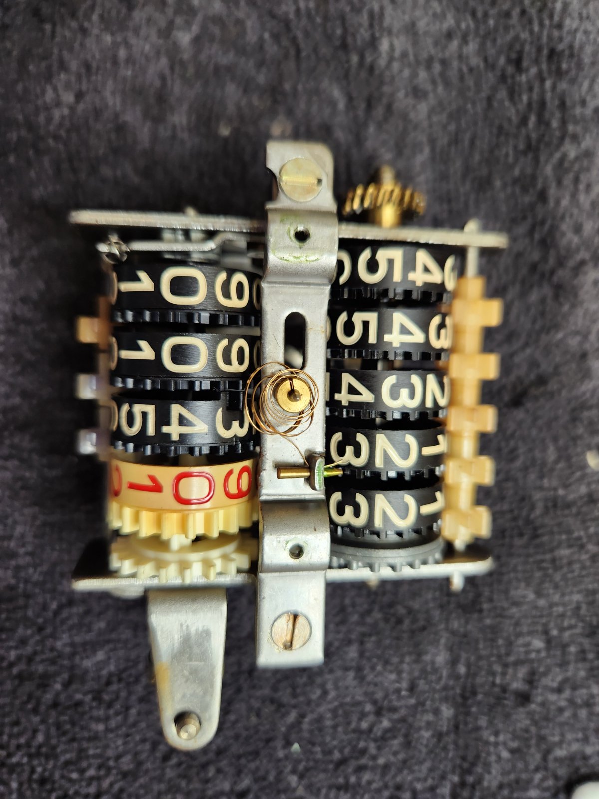

I'm refurbishing the speedometer/odometer and found needle's tensioning spring is all screwed up.
Does anyone have or have a speedometer they can offer?
Thanks, Rob

I may have what you're looking for but won't be home to look till next weekend.
E9 speedos have different gears in them to accommodate for different drive lines so be careful purchasing a complete unit.
be sure to read @HB Chris wonderful FAQ on speedos + diff ratios
you need to know what the speedo number is on your car so you get the right one.

tell me what number speedo you need, i might have one
Thanks @rsporsche
My speedometer =
VDO 20/134/1, W=0.7125, date 1.74
Diff is 3.45.
It is a Euro and Carl at Odometer gears said the odometer wheels clock differently and so best to find a salvage hairspring rather than a mileage odometer. But he said I could use a hairspring from a mileage odometer.
the euro speedo i have is a w0.67 dated 8/73 ... part number 20/134/5, for a 3.25:1 diff ... so i don't think that is going to help you. sorry
