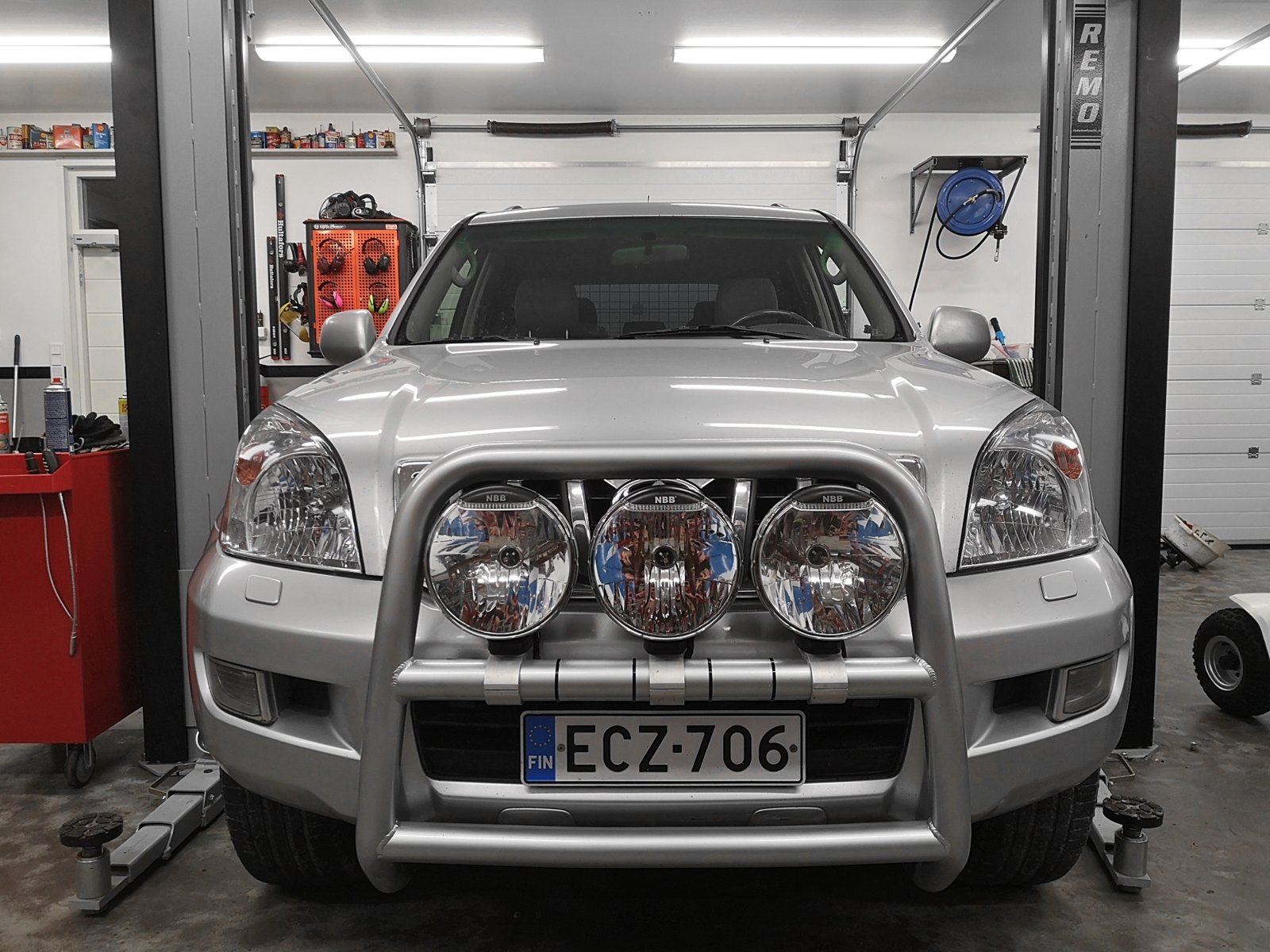

I upgraded my headlights on my daily Land Cruiser (new reflector headlights, heavy gauge wiring, ceramic bulb sockets, great relays, upped the voltage from the alternator and I'm using Osram SuperBrights 100W/90W bulbs which maintain the proper, and knife sharp, cut off with no glare and I haven't been flashed once.

I've been experimenting alot myself, but I haven't documented much. There's a great thread on the Tacoma forum with tests etc, which is a good read for nerds like me.
This second thread documents almost the same upgrade I've done to my headlights and shows how great boring halogens can work.

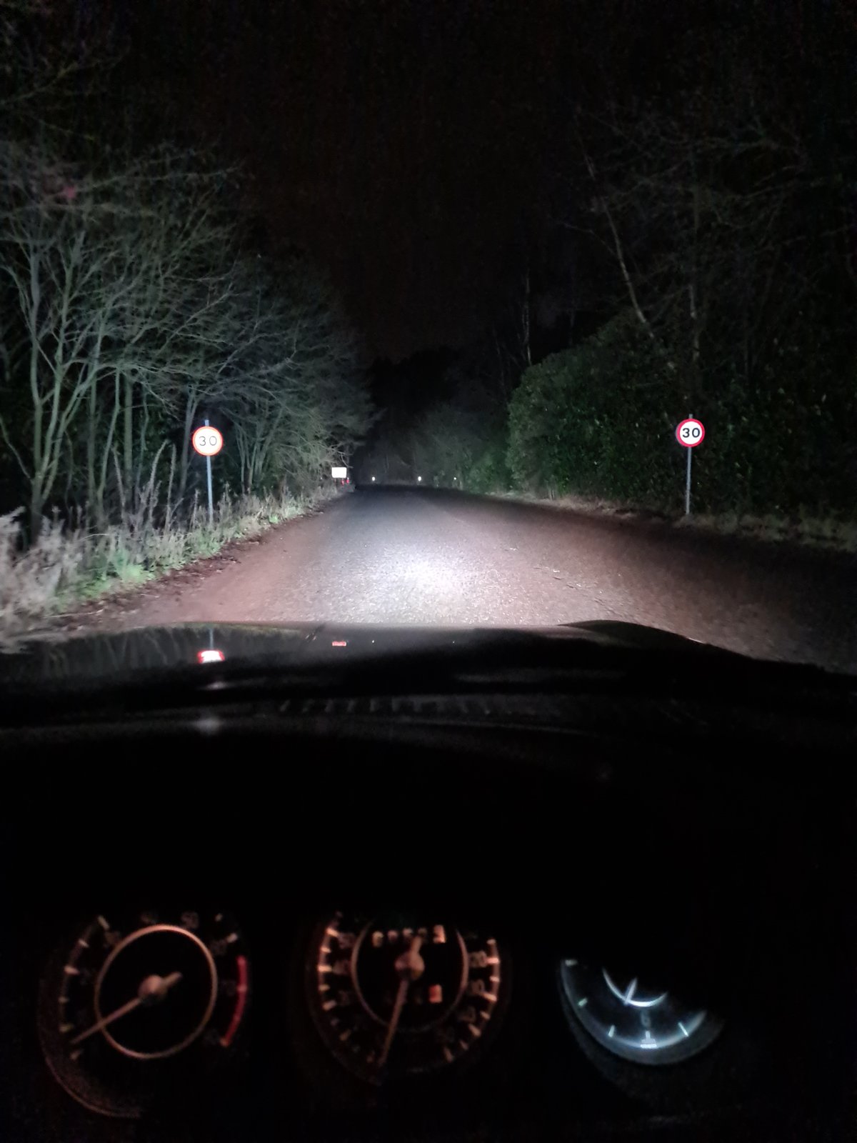

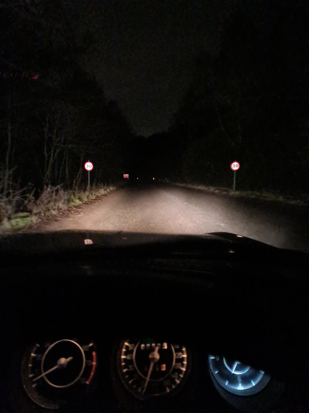

Lots of good info here and in general I agree I would be wary of using LED's in the dipped beam headlights since the glare for oncoming traffic is likely to be excessive. I have upgraded the full beams to LED and the dipped to OSRAM Night Breaker Laser. Here are some pics to show the difference. For me when driving country roads the LED's make a worthwhile difference.

hi @richiemcb do you have any details of what you needed to change from stock and what bulbs you used ? Hoping I can squeeze this in as a job for a weekend when time permits.

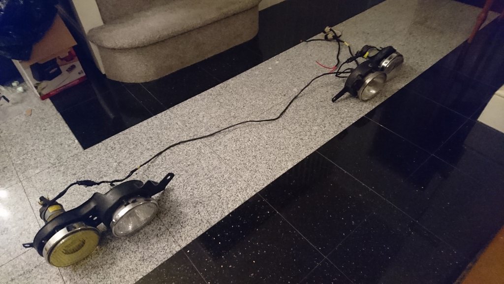

Osram night breakers for both. As for the relay mod, was the same principle on both cars. I used the high and low beam wires coming out the original harness to trigger new fused relays. I had some spare original relay blocks which I removed the wiring from and repinned with new wiring that ran to the battery and also the lights.
Not the clearest photo but you can see the original relay holders on the new set up, red wires go to the battery and the trigger wires to the harness
