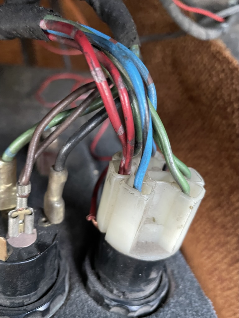

Mine has a very reasonable amount of cable slack. I had to replace it and I do not recall using a mirror or spending more than a minute on the job. If you knew me you would understand why I do not use mirrors :).
My switch connects to a plug - looks like this:

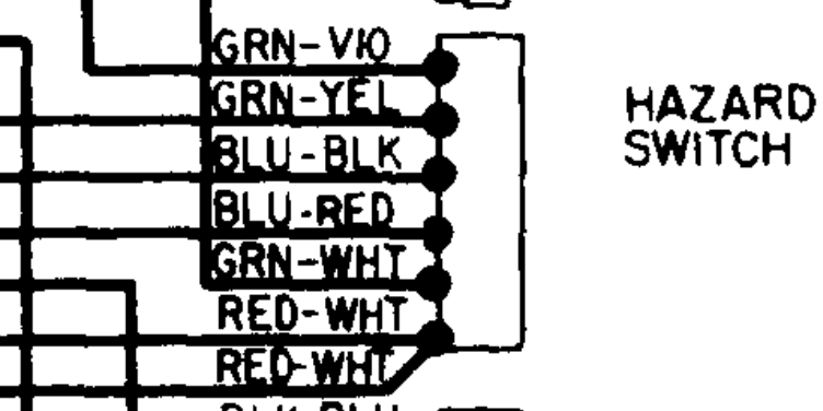

This is what it looks like on the wiring diagram:
