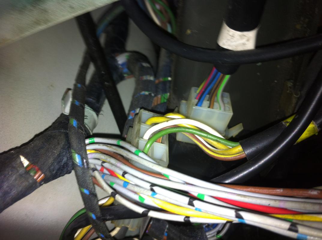

If you can send me a picture of the wiring connector might have a good used switch.

It's the white plastic plug with 5 wires going in (brown, green, white and 2 yellow) in the foregroung.
