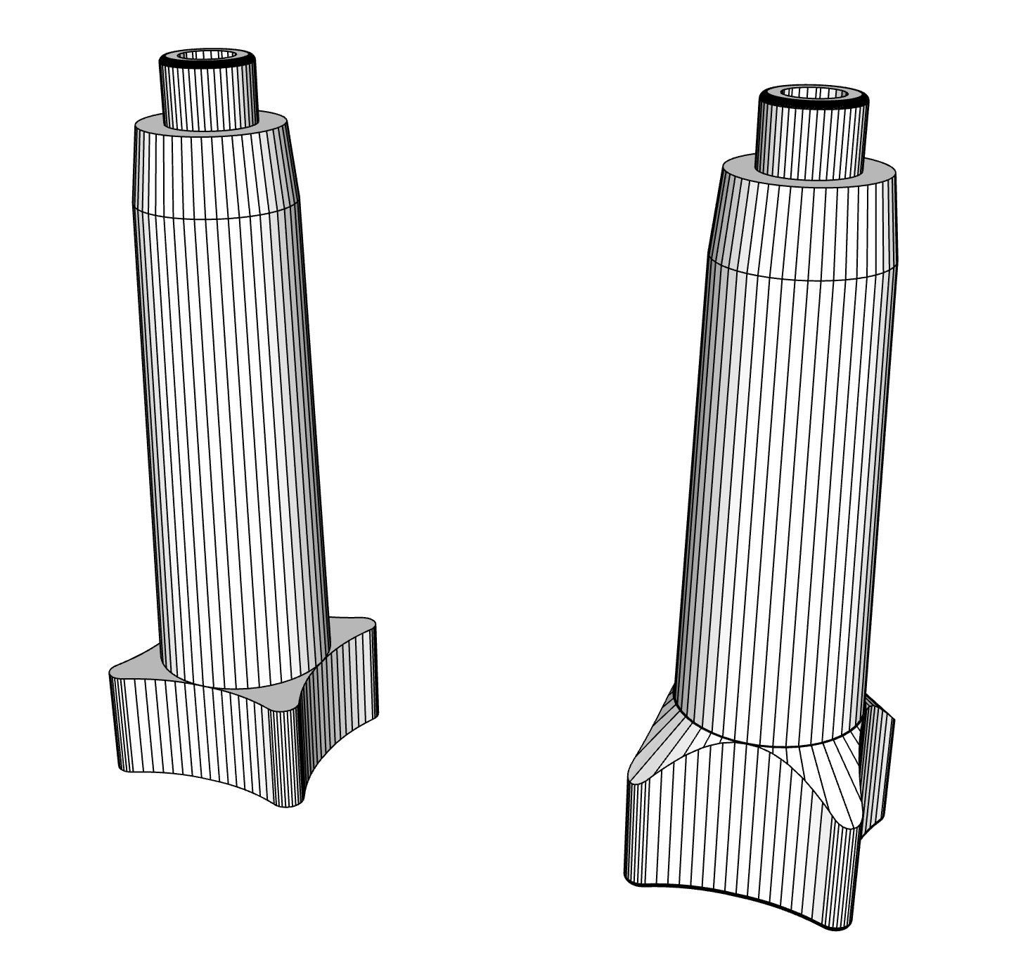

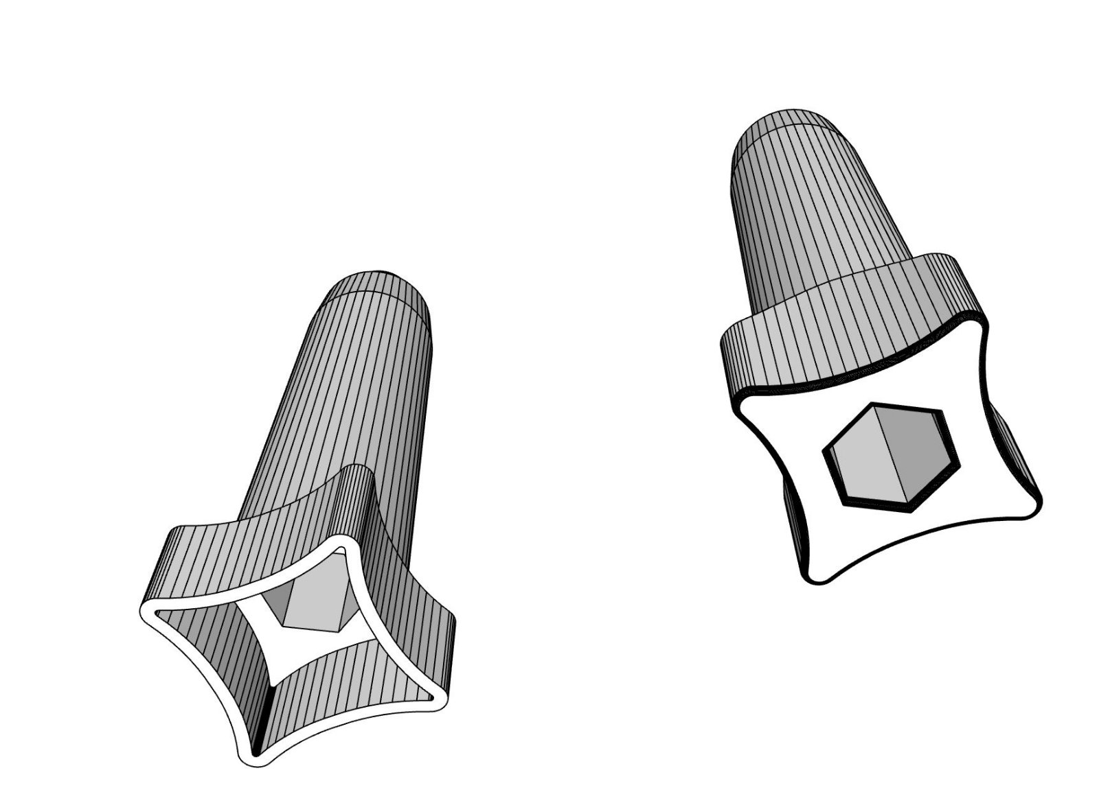

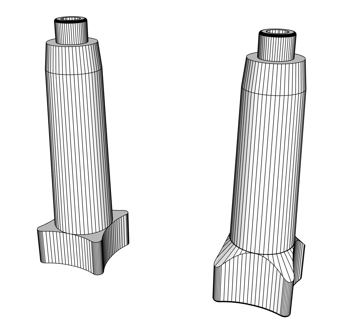

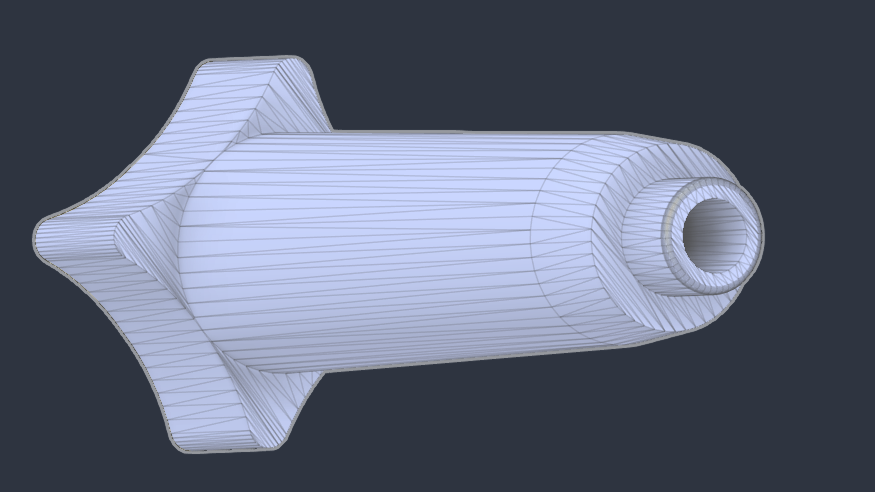

Hi All,
Having lost one of these, I have made some that can be 3D printed. There are two that I have developed. One is the OEM replica, the other is a slightly nicer one to use (and easier to print). OEM p/n 63 12 1354 449.
If downloading the file(s), remove the ".txt" from the file name and send them to your printer. Have fun.
PS. Use an M5x0.8 tap
Files are:
63121354449.stl.txt
63121354449 MWDS.stl.txt

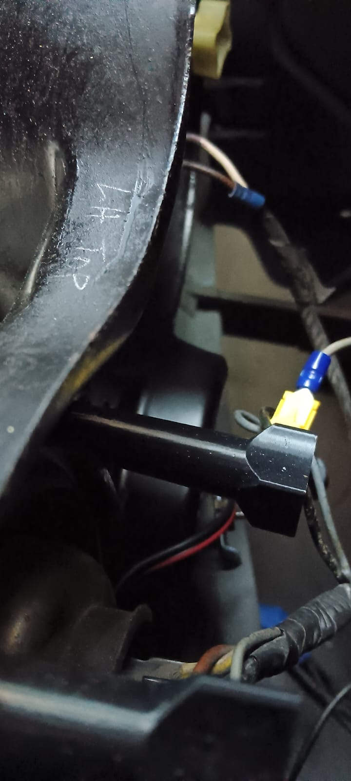

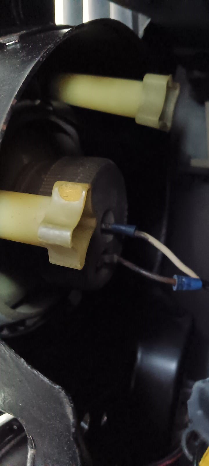

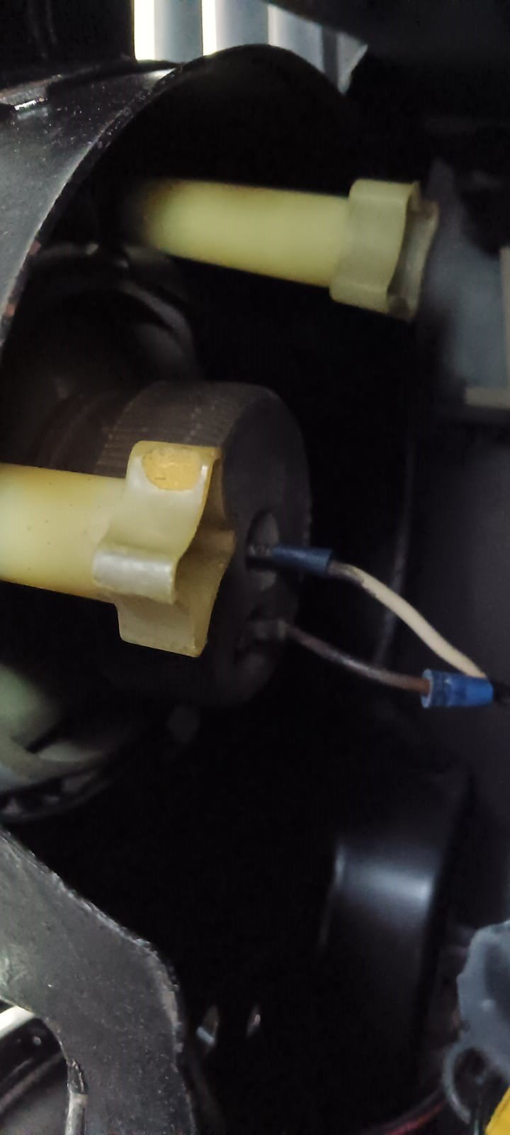

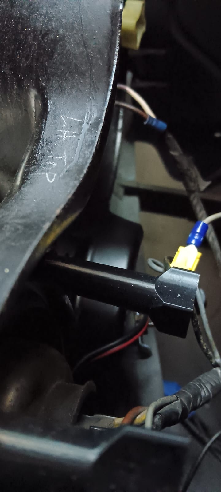

Can you send a pic of your upgraded adjuster? I am about to restore my headlight buckets.
Hi Rudy, Here are a couple of pics (as installed). I didn't photograph them before hand, but can slip one out if required. They are dimensionally identical to the originals just with a little smoother end where you turn them. This also made them easier to print. The purists will obviously mark me down as a hieratic though. :)

Thanks so much. I have two sets of headlight buckets and will be using the other style that does t use those adjusters
H D Calkins, just saw you message. There was no difference (white to black). The originals were a creamy coloured plastic. I simply had black filament in the printer. I used PETG. But ABS would work fine too.
