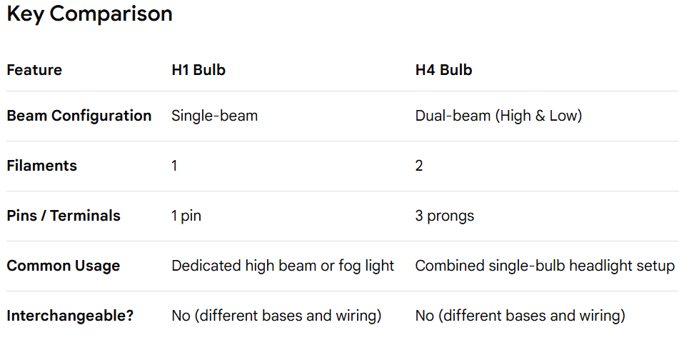

Here's what I have learned about bulbs from Google AI:

Well- appears Google AI answer is once again faulty.
The common usage for the H1 bulb and H1 lamps for coupes in Europe is the low beam and the high beam. Proof of that is the spot in every toolbox that holds exactly an H1 bulb.
Additionally, the thought that the H1 bulb has one pin, and the H4 bulb has three prongs is faulty at best.
The H one bulb has a spade connector for the filament and a ground connector
