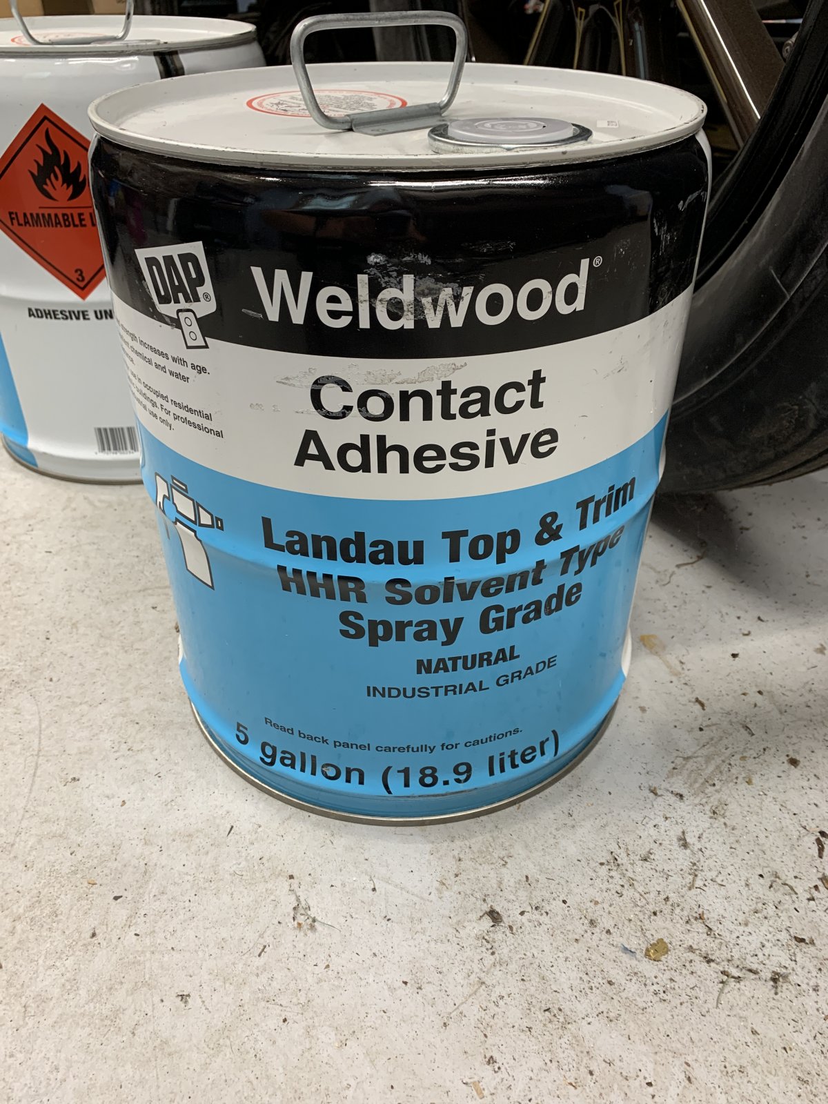

Response from my headliner guy:
DAP is the manufacturer. Weldwood is the product line. Landau Top and trim is the product. It is waterproof and available in smaller quantities like quart size cans. I found that most of the products in spray cans do not hold up well over a longer period of time in high stress environments. This glue can be sprayed or brushed on.
Thanks, Bob.
I ended up with some of the 3M stuff that is/was designed for headliners at about $30.00 per spray can.
I'll let you know if it let's up under the heat in two or three years.
