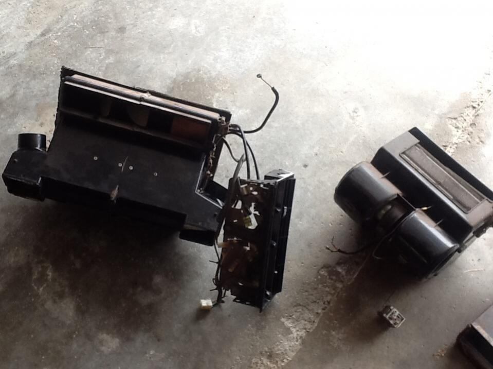

I am never doing this again as long as I live! The mounting plate underneath has to be removed to slide it out. Putting it back in is going to be fun, don't know how I will get the two nuts back on driver side of heater to firewall.

Maybe tape them to a flexible spring drive socket. Just a guess on what you are up against.

Stick the nut on the tip of a screwdriver with something very sticky but slightly flexible (how about blutack poster adhesive putty. Flex allows the nut to move so the bolt threes can engage.
