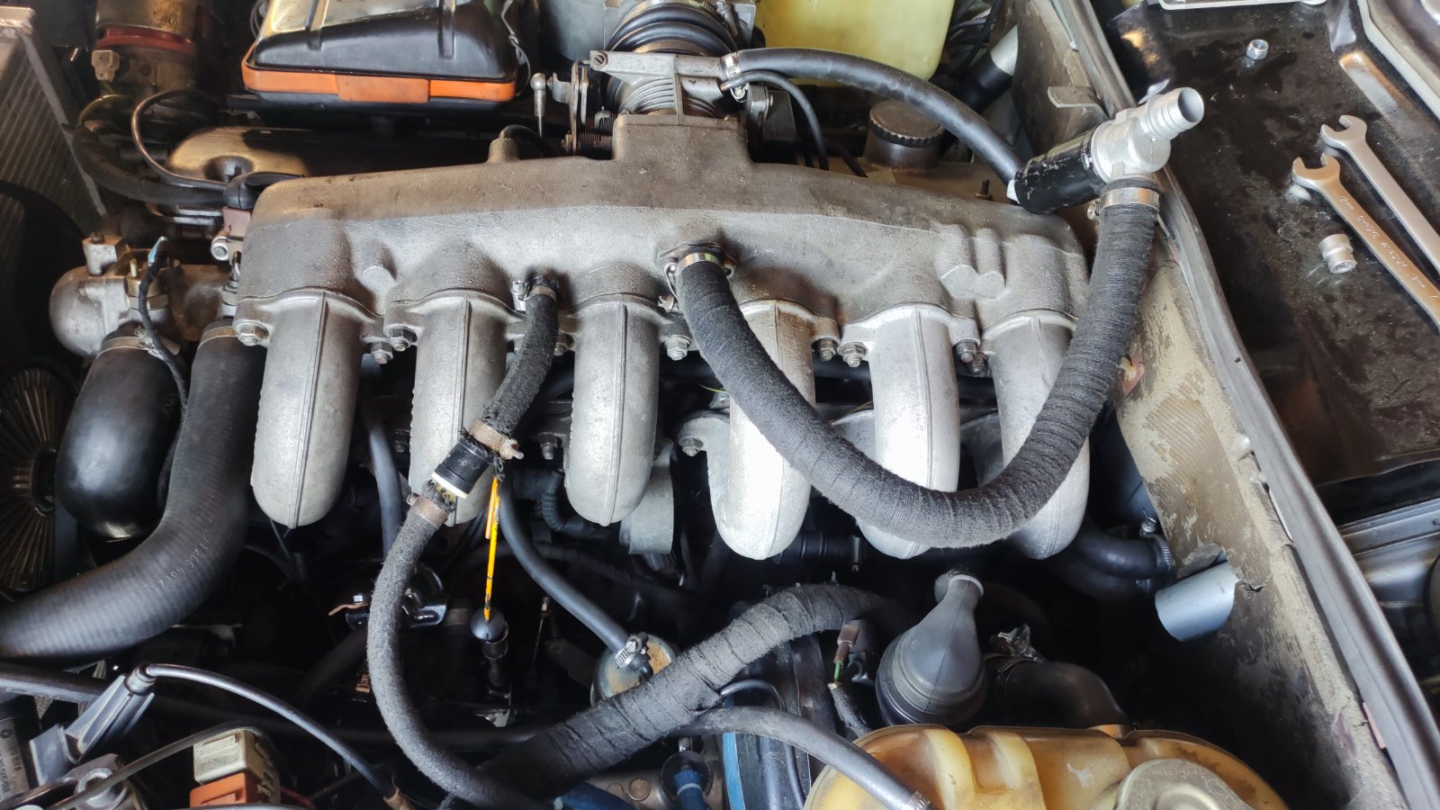

I also did an conversion to the longer e21 runners and now the engine ist much more fun to drive. More Torque starting at 2000 rpm and the possibility to rev a little bit higher (Up to 5600 rpm with pleasure).
In the picture you can see the visual lenth difference.

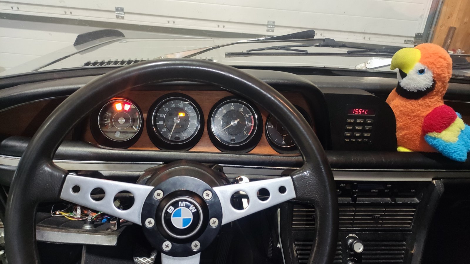

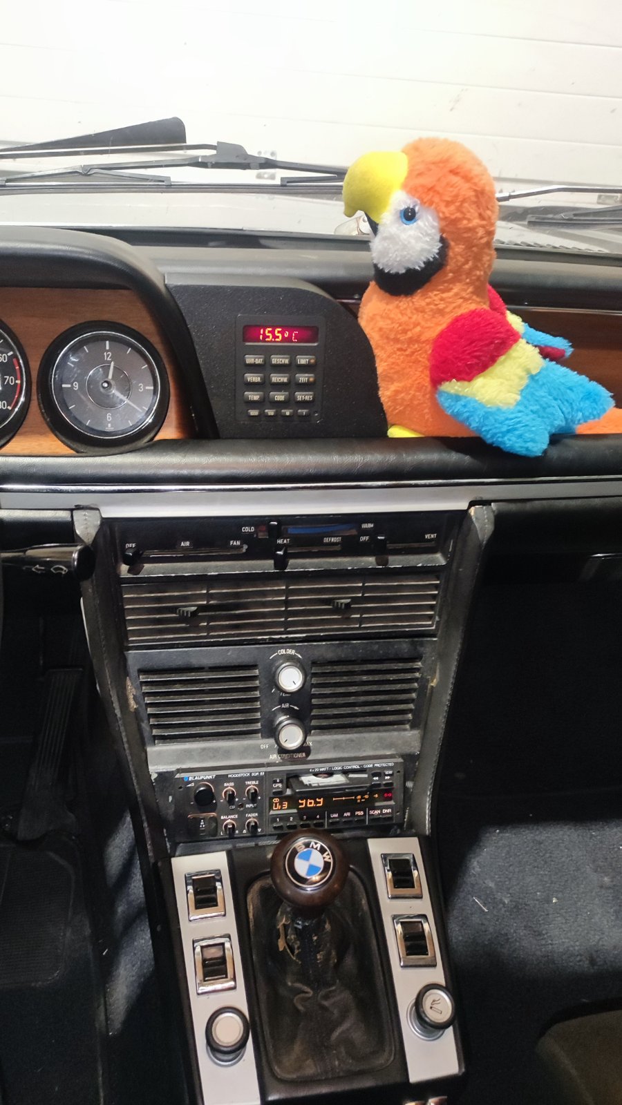

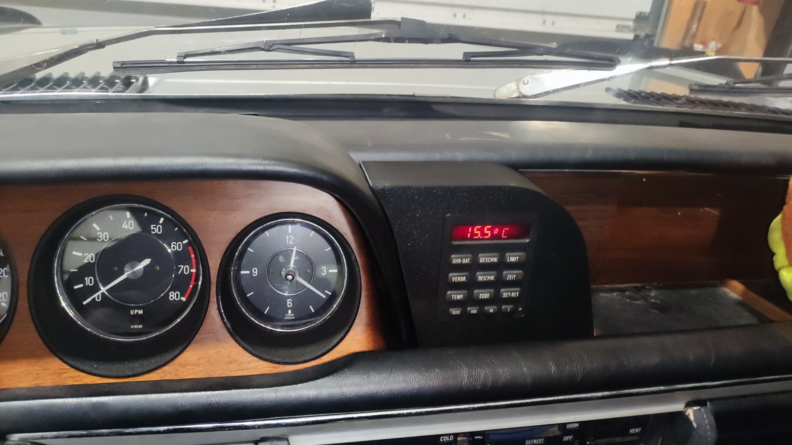

I also invented a conversion kit to electric Odo, cause my next step is to integrate a cruise control, Boardcomputer 2 from E24 and also the entire Check Control System. The electric Odo works great and as a result you need no longer the expensive Transmissions with Outlet for the Odo cable. Maybe also interesting for you Guys with Motor swaps and more modern transmissions.
At the moment I am working with my engineering students from the local university of applied sciences on the first Abs (Anti lock) System inside an E9 and the retrofit of an original air conditioning. Winter time ist working time.
The mechanical parts of the Abs System are already done, I only have to do all the wiring and put the battery into the trunk. Secondly I am also working in amore direct power steering with less rpm while cornering and with some luck I get it finished next Weekend. Target 3.5 rpm from left to right instead of Stock 4+.

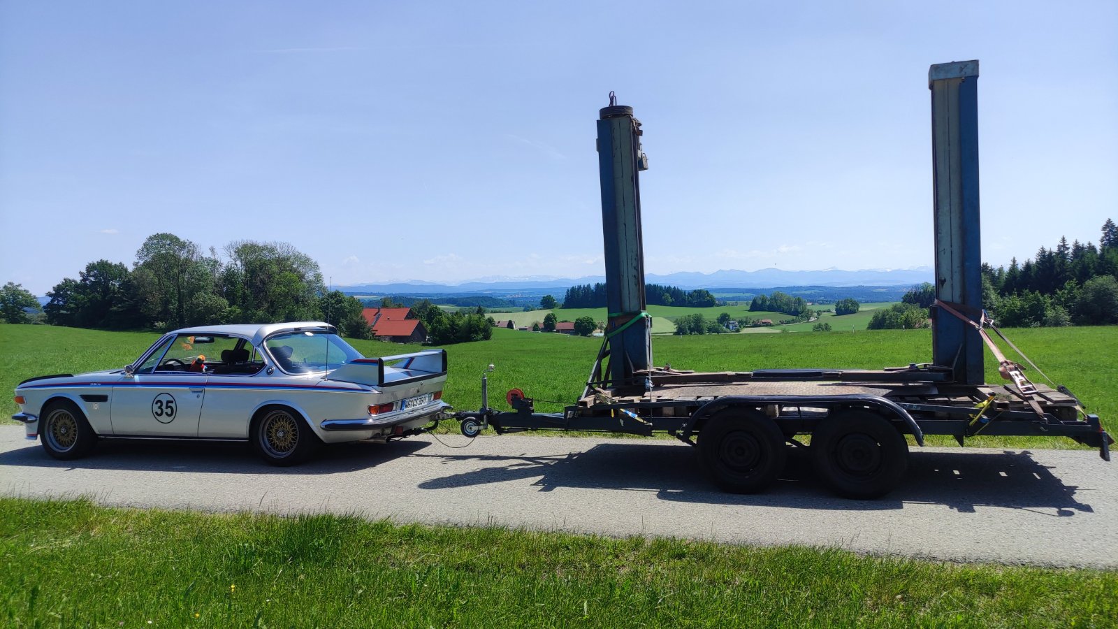

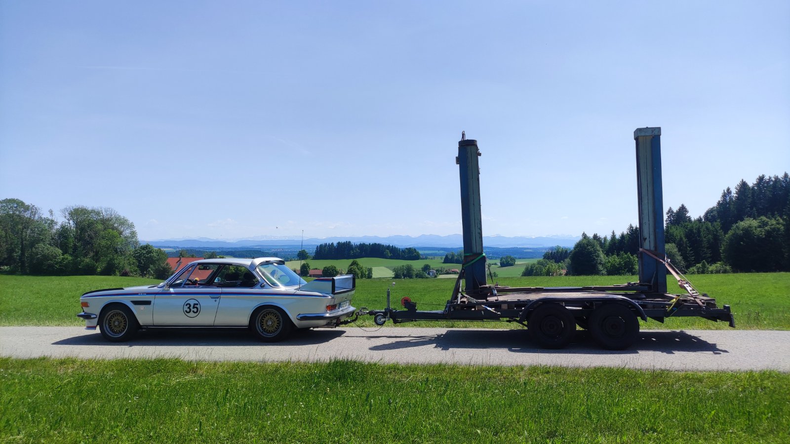

Hello,

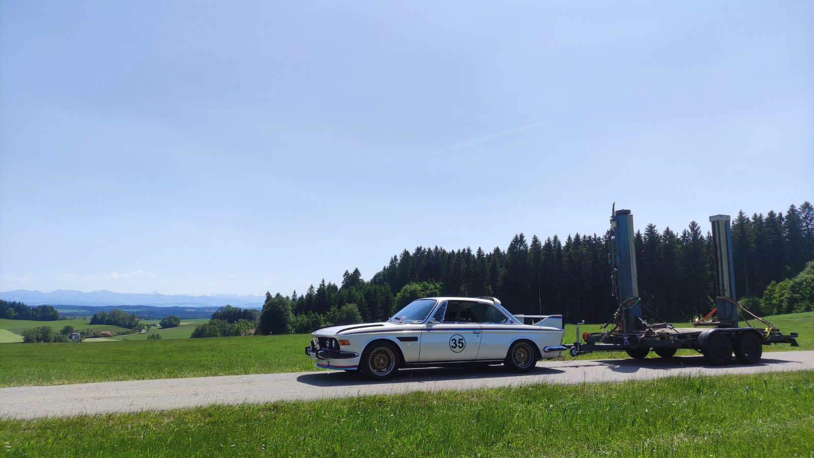

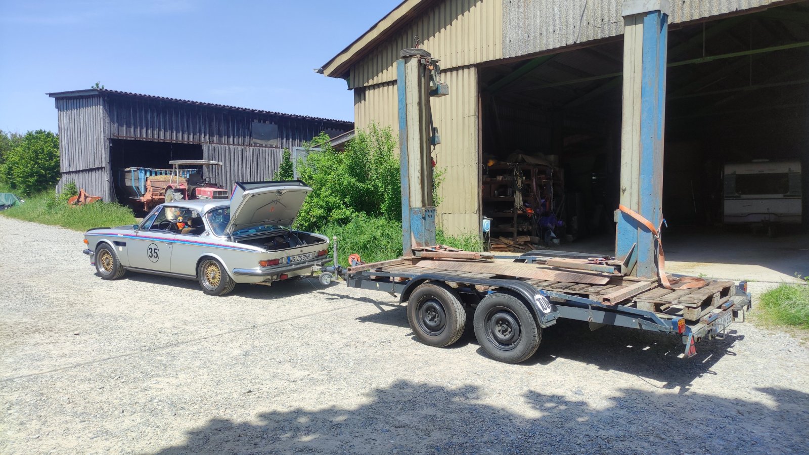

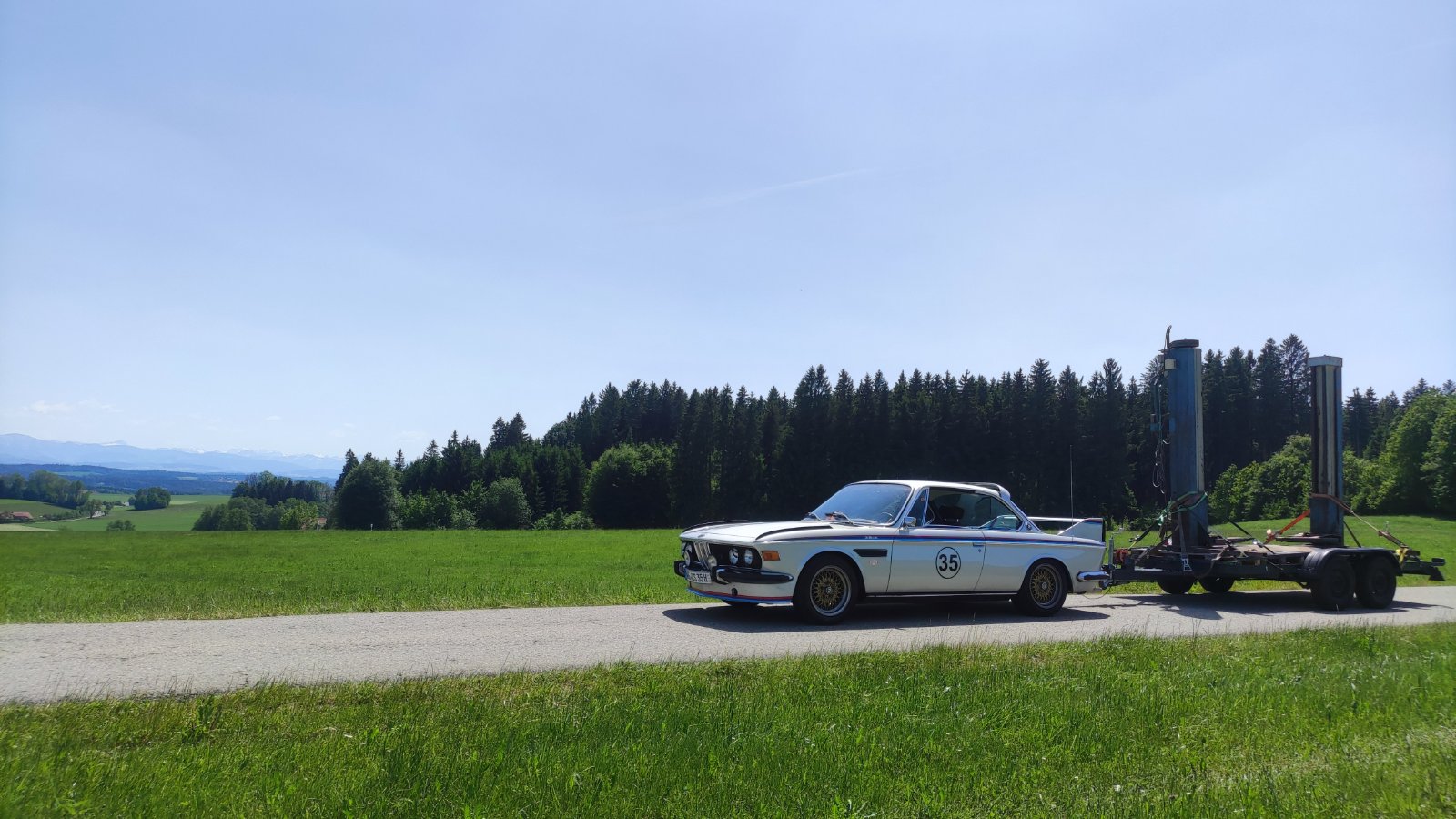

I'm 20 km north from the Lake of Constance "Bodensee" and today I did the First Trailer Ride with 1.7 tons and 30 °C outside. 3.5 engine pulls hard and AC blows super cold. complety in love.
In the Background you can see the Alps ("Austria")
Hello Guys,
like promised the results of the new dyno testrun with the long runners and the results are very interesting, but not really compareable, cause we got a brand new testbench and the workers told me, that they compared their test car and that the old dyno always showed a little bit too much power. That means, the old setup was measured with a testbench that showed always a litte bit too much power and torque.
That makes the new results even better for me and the setup.
The maximum torque between the old engine (on old testbench) and the long runners (new testbench) has increased with the long runners by nearly +45 Nm at 1700 Rpm. That is what you also feel while driving. It pulls hard at low rpm but looses in the higher range you normally never use for driving.
engine rpm Old setup New setup Delta
1700 rpm 224 Nm 267 Nm (+43 Nm or 14 Hp!!!!)
2000 rpm 256 Nm 264 Nm
2500 rpm 268 m 278 Nm
3000 rpm 275 Nm 282 Nm (+7 Nm or 4 Hp)
3500 rpm 284 Nm 298 Nm (+14 Nm or 8 Hp)
4000 rpm 292 Nm 307 Nm (+15 Nm or 11 Hp)
4500 rpm 292 Nm 299 Nm
5000 rpm 282 Nm 278 Nm (-4 Nm or 2 hp)
5500 rpm 254 Nm 250 Nm (-4 Nm or ~2 hp)
As you can see with the long runners you shift down the torque and also the horsepower to the most used rpm area and it feels way more torquier. I also compered the figures to a stock m30 218 Hp 3,5l (European Version with block airtake) from 1985 and the long runners also bet them in lower rpm, but lose above 3600 rpm.
So, the old intake is amazingly good for low rpm driving.
