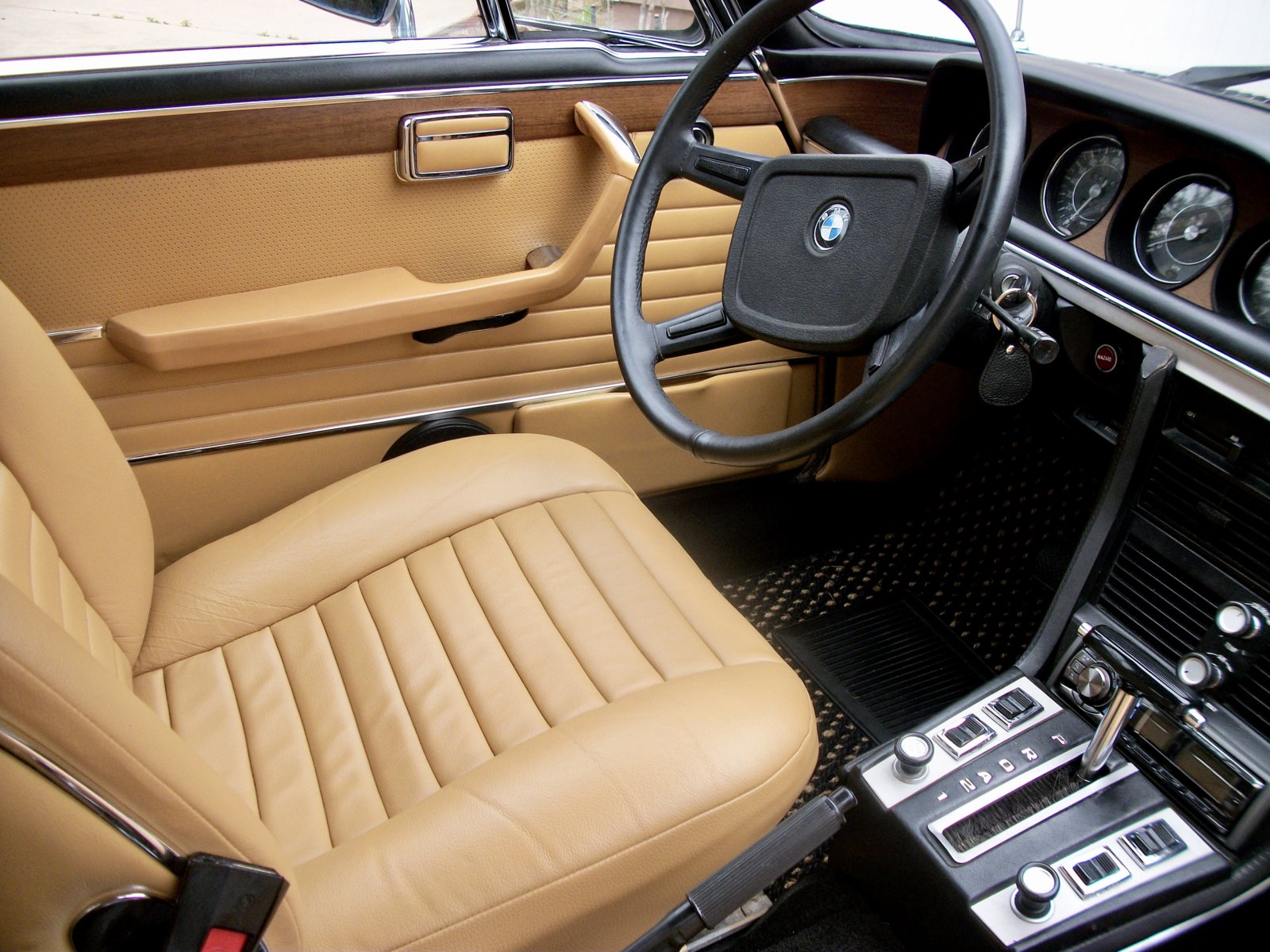

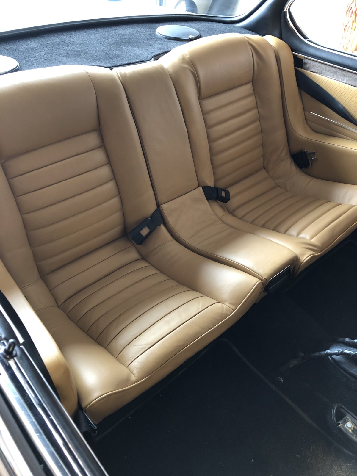

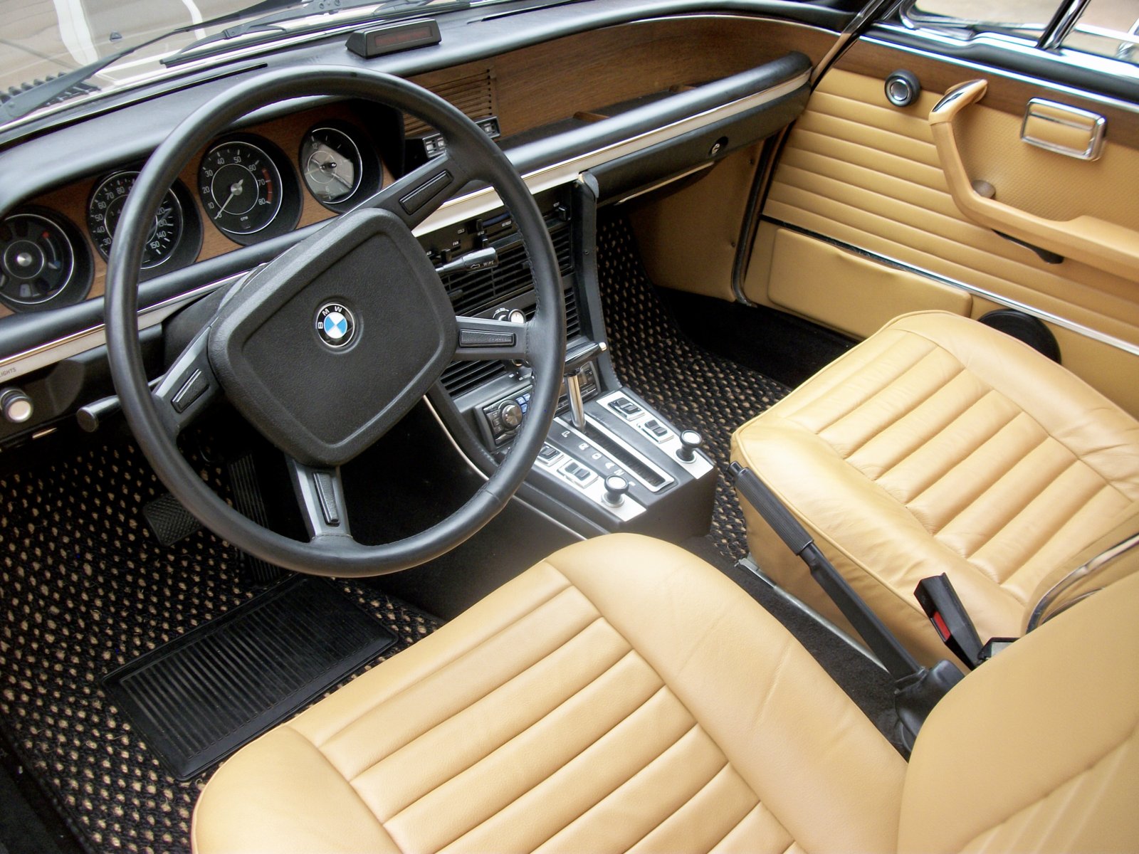

OK the seats and door panels are now all the same color. Very pleased with the spray dye, restored wood goes back in next week.

What color and what product did you use?
Looks terrific!
Hi Stan, I used the World Upholstery spray dye Gobi color. Wiped surfaces down a couple times with lacquer thinner to try to get rid of any Armor All type residue. Did not have a problem with adhesion or fisheyes or anything, doesn’t smell, not overly glossy finish. 4 cans was enough for all panels and seats. We’ll see how it wears over time.
