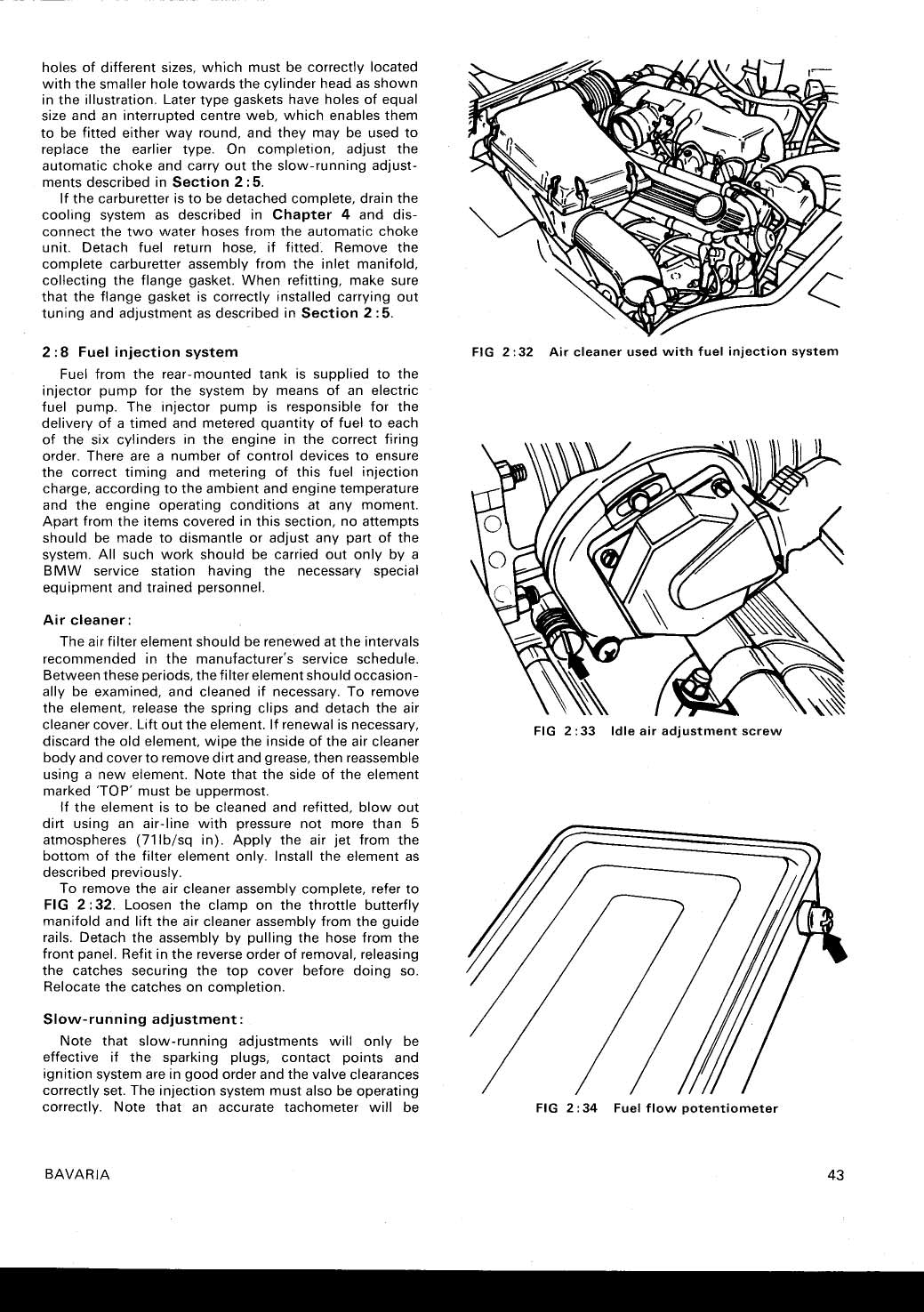

For starters, there is the shop manual and autobooks. But before dabbling, i would double check ignition and valve settings - also covered in the manuals.;-)
http://www.e9-driven.com/Public/Library/BMW-E9-Manual/pages/en/13.html#refertoc
