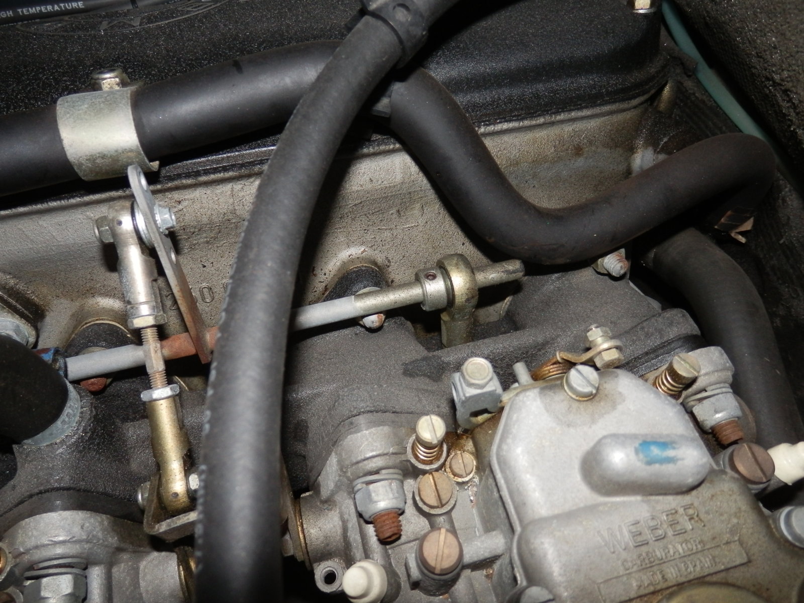

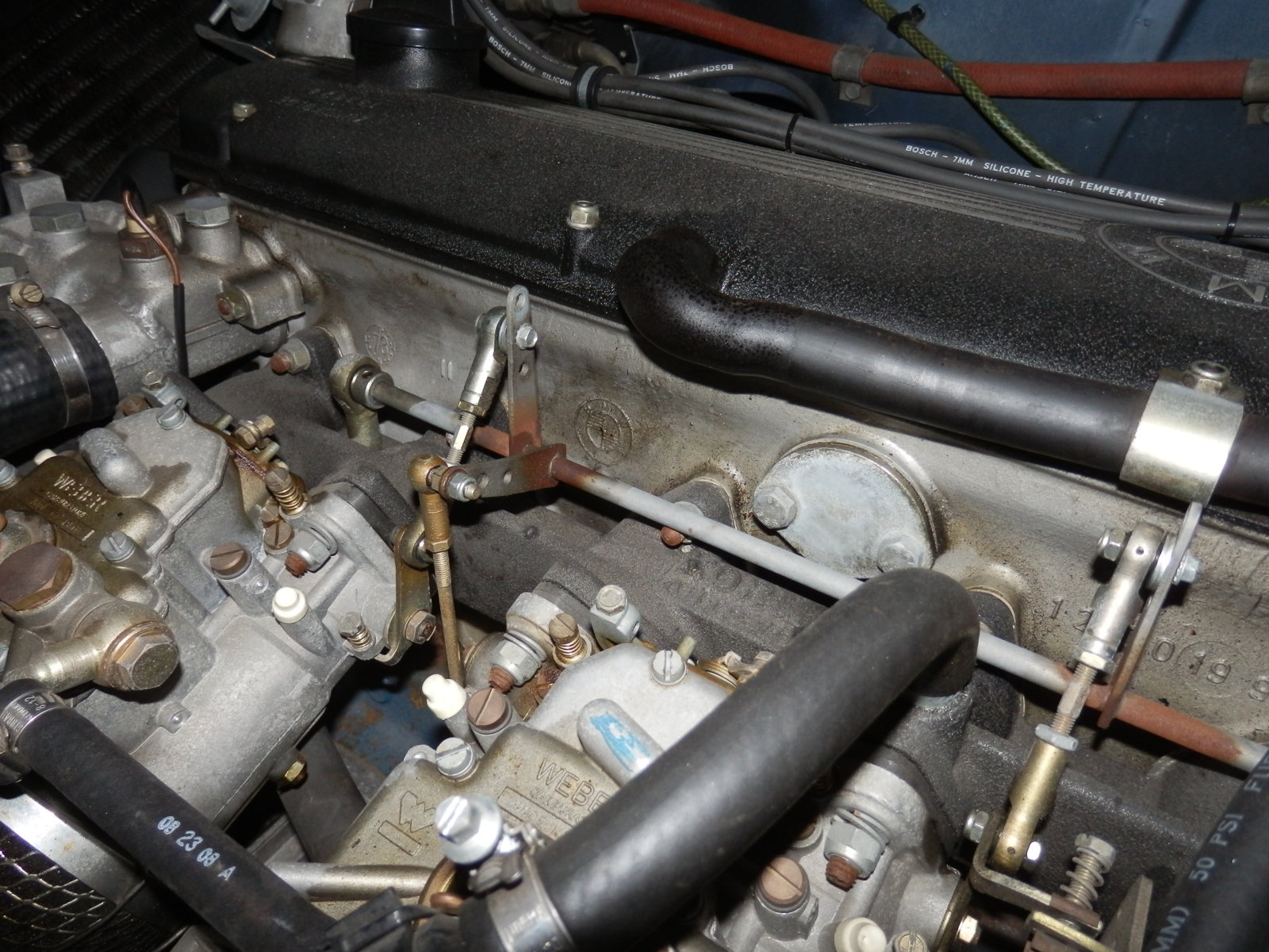

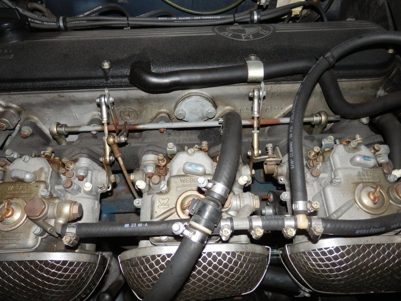

I don't even know what an Alpina Box is, but here's a couple photos of what I've got, is
said to be Korman (I have the old paperwork from 2002)
I don't even know what an Alpina Box is, but here's a couple photos of what I've got, is View attachment 49013 View attachment 49014 View attachment 49015 said to be Korman (I have the old paperwork from 2002)
That is the Korman manifold and linkage. I have that linkage also but I plan on using the balance levers as mentioned previously. The thing about using the balance levers is that you don't have to thread anything into the manifolds at all. The Korman linkage mounts to the Korman manifold. You can likely mount it to another manifold but you would need to ensure that the heim joints had the same thread. You can move the heims and the stops around on the shaft as needed to fit another manifold. Also, the Korman linkage is several hundred. I believe that Pierce has a linkage setup as well. The redline setup is flimsy junk.

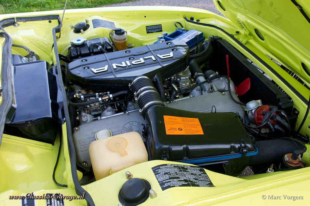

For reference, here is the actual Alpina Setup. As can be seen, the connector rod is pretty low and tight to the manifold for clearance on the intake manifold.

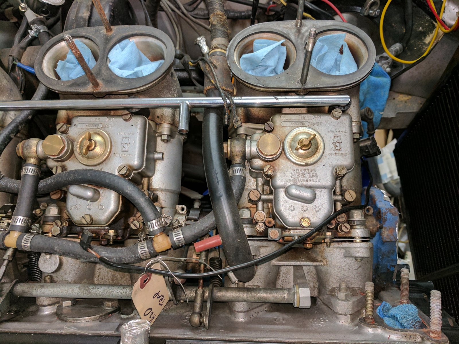

And here is Daddywad's actual setup, with different carbs, and just connecting the balancing levers:
img_2797-copy-2-jpg.48985
With that, is there any reason or advantage to having the connecting rod above? This is my first experience with setting up side draft webers, so excuse the lack of knowledge here.
