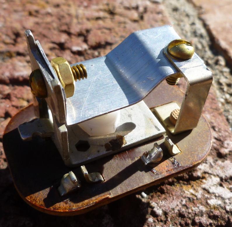

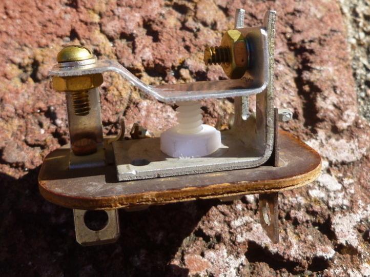

Recognizing that my car would be "dead in the water" if the LS relay failed, I performed a hack repair on my old unit. I attached a heavy jumper across the two load terminals and carry that part in my trunk. If the LS relay fails again, I could theoretically plug in this jumpered unit to restore functionality. Yes, I would need to unplug the relay or disconnect the battery every time I stopped, but at least it would let me limp home.

Here are the relay pinouts:
Coil: pins 85 and 86 (the two 1/4" wide tabs)
Load: pins 87 and 30/51 (the two 3/8" wide tabs)
Here are a couple of photos of the innards of my modified relay. You can see where I used two brass screws to attach a sheet of aluminum across the load terminals. I had to use a nylon screw to re-attach one of the load terminals to the bakelite base - it had previously been secured by the coil armature:
