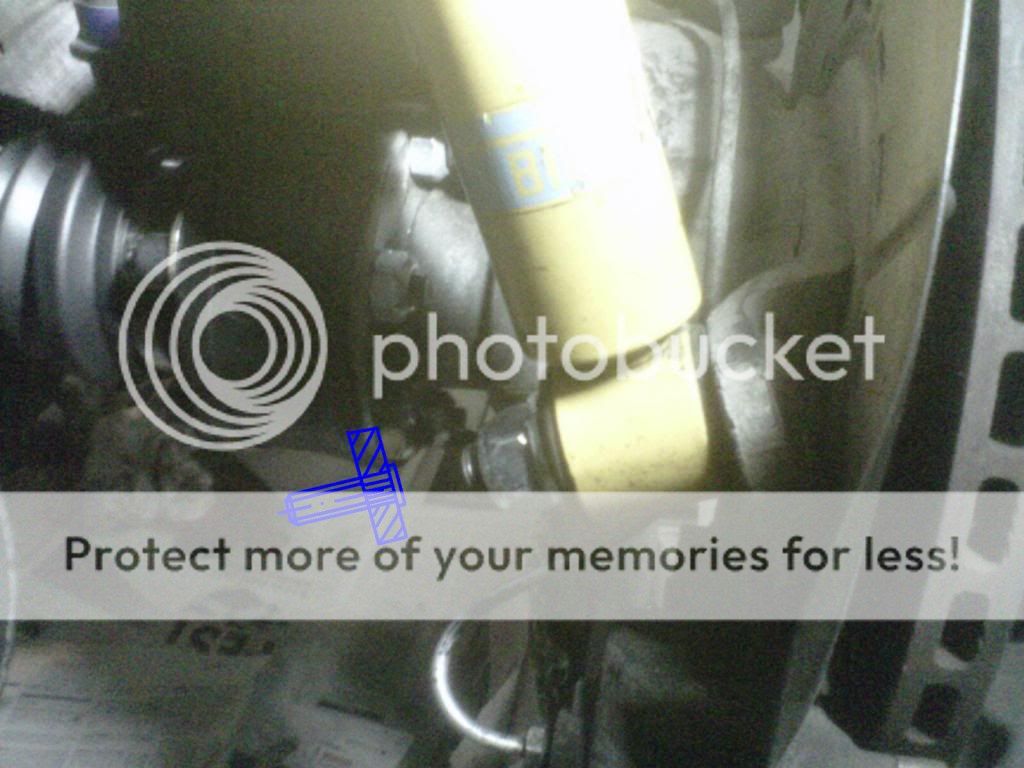

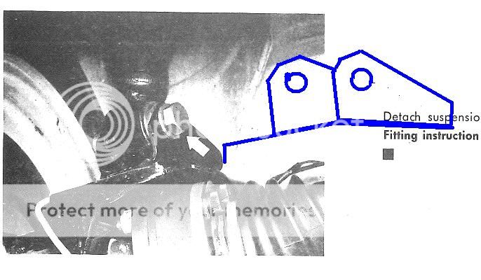

i would like to identify my rear strut spring support, i find it a little bit odd when i compare it with the formal photo found in the blue manuals
the geometry is different, so is the fixing point
my setup:
the setup as it is in the blue manuals:
i added little drawings in blue of the schematic of both
my car is from 1971, does this make a difference, which one is your setup ?
thank you, then iis it possible that the manuals reflect the e3 setup ?

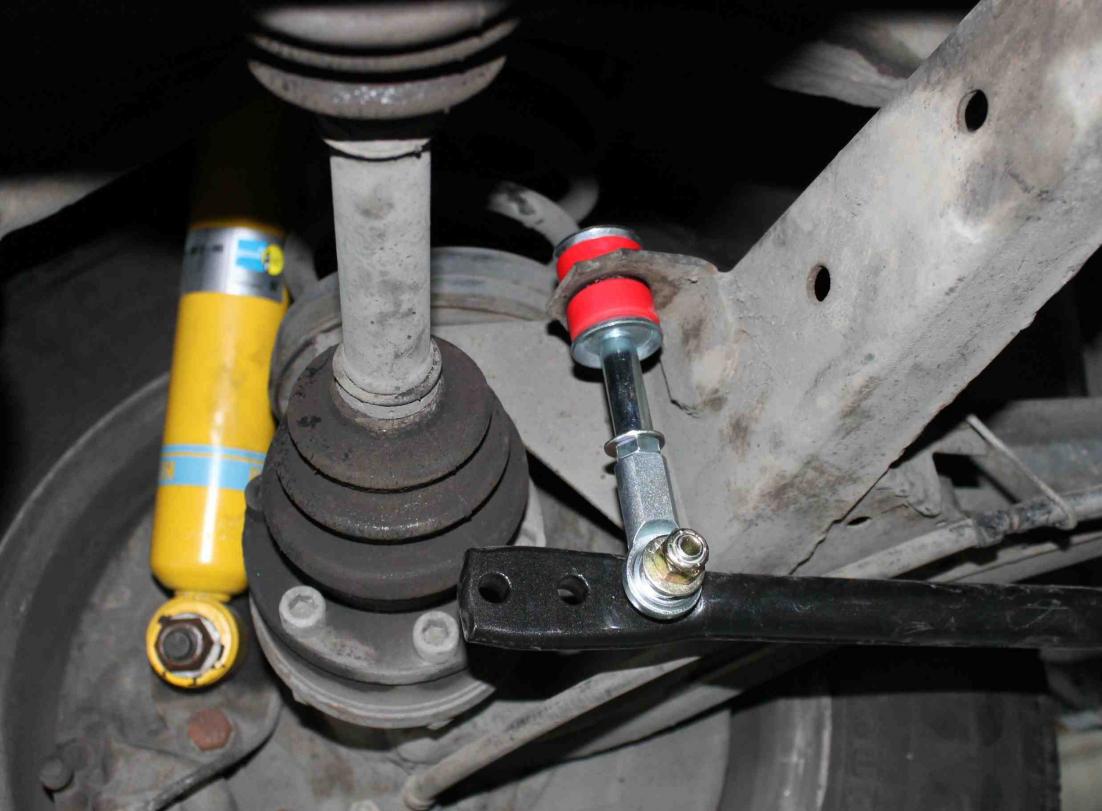

Manual is identical to my E3 and I believe there is a metal bushing in the shock.
Here is a picture taken when the sway bars were installed.
