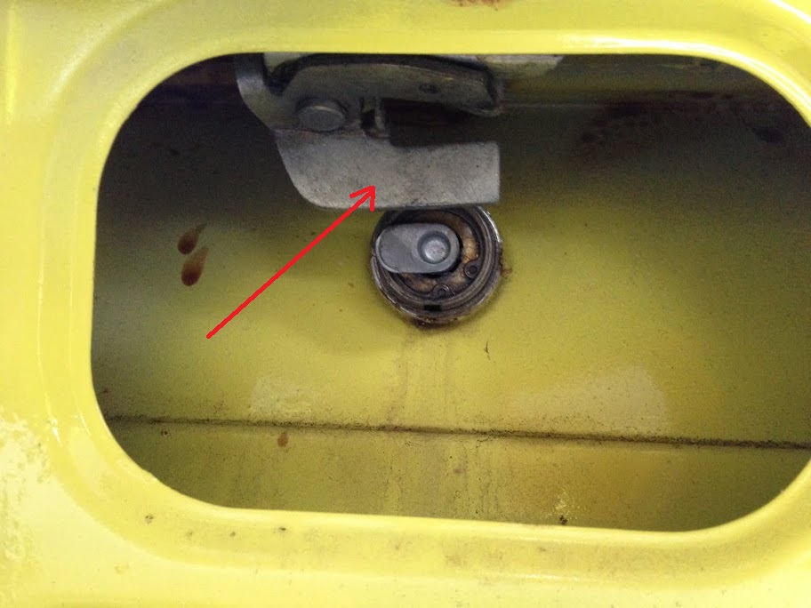

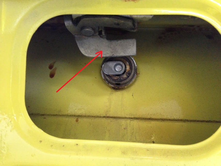

Guys how do I open the hood... today I was smart enough to check if key latch is working while trunk lid was closed... when I tried to unlock it latch detached now I can not open the trunk.
Any ideas how to open it? I removed one side of rear seats but there in no openings.
Push the inner part of key lock full inside to the trunk (from what i see on photo you should be able to make this, because already nothing is holding it) and then push marked part with something like a screwdriver or even finger.
If you can't push full key lock inside - try to catch and pull marked part thru tank cap or maybe you have speaker holes on back shelve.

I can make a suggestion that almost always works; as illustrated in the pictures above the little prongs get worn and this is what causes the problem. Put the key in the slot about one 4th in and push the side of the key to the right (or left) then another quarter way in and push sideways in the other direction. Make sure the key slot is in the unlocked position when you do this and then as you push it in the final distance the trunk should open.
