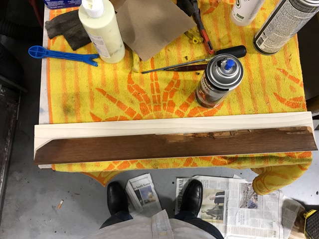

Hi Folks, Helping a friend do a low-budget and hopefully quality job on their wood. I'll post some pics below of what I have done so far but I'm having trouble getting the bezels out of the dash wood- Any ideas?

unscrew the metal back plate and then i think they just fall out. i've only done it once ... and it was a year ago.
so what are you going to do to the poplar? it doesn't stain that well (or evenly) ... we generally use it for paint-grade wood. are you going to put veneer on it?
I used the poplar wood on my coupe and got it to stain evenly (had to mix a couple of colors), then I sprayed multiple coats of poly and I think it's OK, considering I was not going to put mega bucks (or time) into it- what do you think?

My experience was that the bezels were actually lightly soldered to the back plate.
It takes some pressure to get them to pop loose.
Try sliding a metal putty knife under the back plate and lifting carefully till they pop loose.
If not you may have to put some heat to them around the edges to get the solder to soften.
OK, they're off- thanks- and can someone tell me what type of wood I should get for the doors and dash as I might as well do it correctly as long as I'm here.

Pry the plate off the bezels not the other way around.
OK, lots to answer here- Thanks Don, yes, I don't think putting the bezels back looking like bottle caps would be appropriate. Regarding removing, there are 11 screws in the rear to be removed, then some strange wood rings covering up the soldering points; those were removed and the solder was removed with a sharp scraper- the bezels then fell out when the backing plate was removed.
