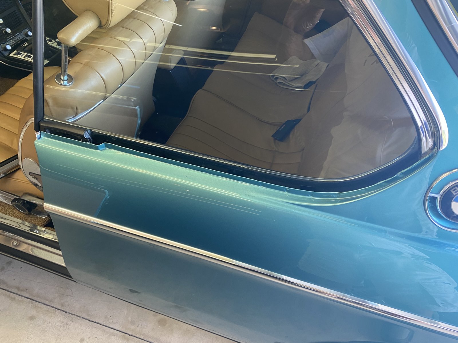

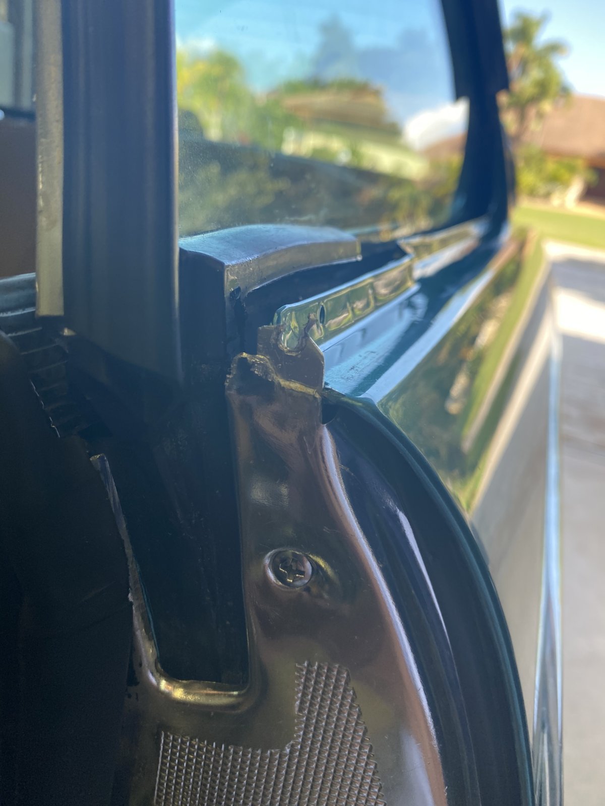

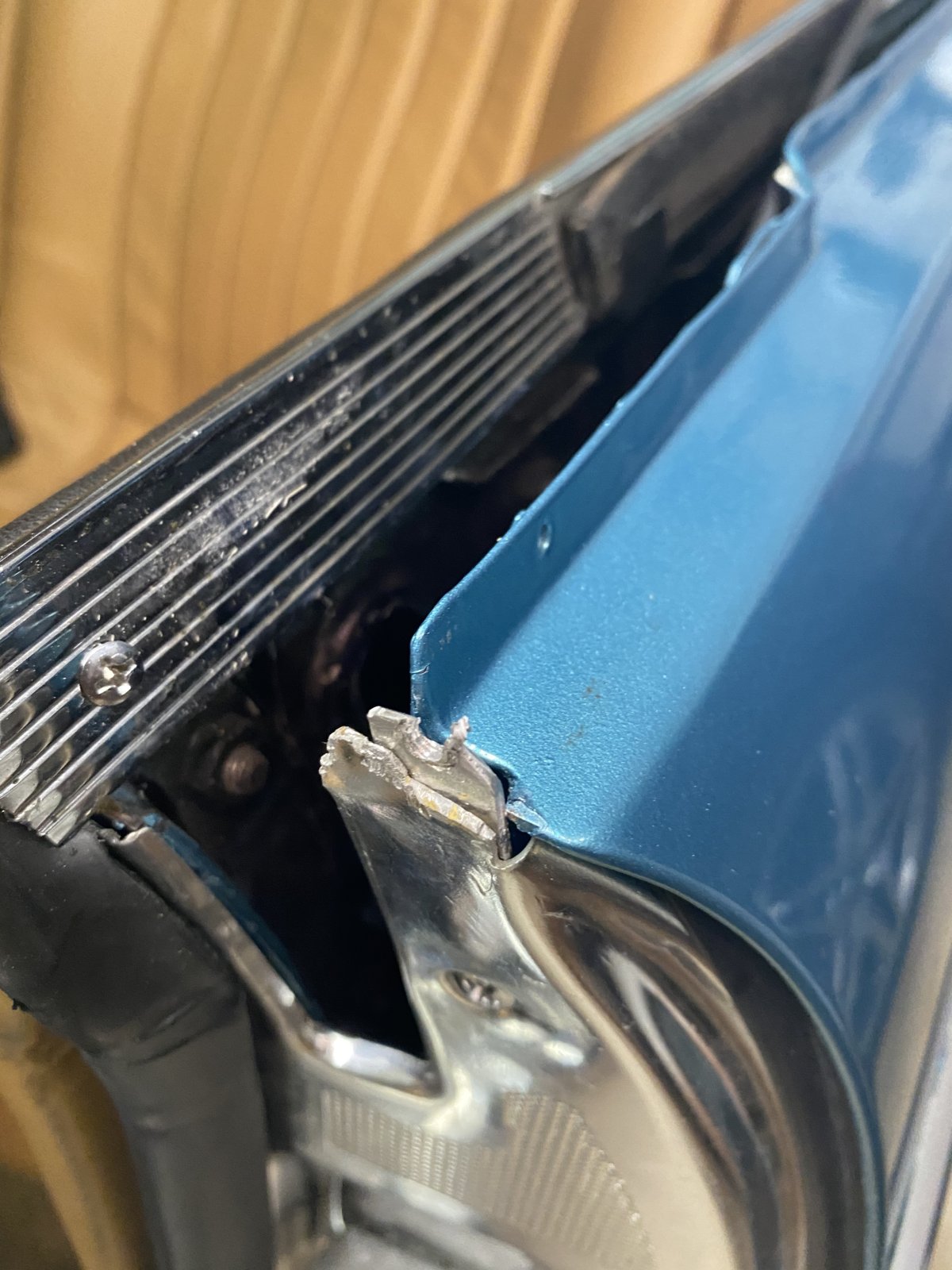

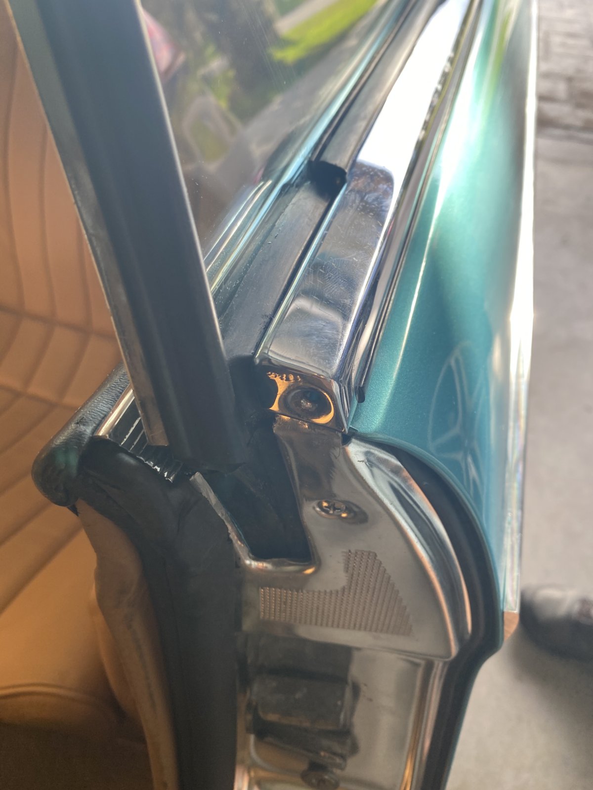

Markos--I had the rear windows out of my car to replace the rubber "blocks" that ride up against the subject part. I read where the original rubber parts have clips to hold it tight against the sheet metal along with the screw that goes into the back middle of the part. I'm missing that part. The PO used an aluminum piece extending up from the door jamb to replace the hard rubber piece. Then a screw was placed in the end of the trim to hold the outer chrome trim in place. When the window closed,the new rubber "block" just ripped the end screw out. This thread shows me I'm missing the part completely. Did you 3-D print any for the driver's side? Are there clips that hold it in place?
Here are pics of how my trim was fastened and the ripped hole at the top of the jamb. I'm afraid if I make another metal piece like what I have, the chrome trim will not allow the window to close completely since it is out of alignment. The first pic shows the new rubber "block" below the trim rubber due to the trim being too close to the window. That was fixed by twisting the chrome to fit the sheet metal edge better. The second pic shows the new rubber block in the correct position since the chrome trim is removed. The 3rd & 4th pics show the alum piece with the ripped hole where the end screw was screwed in holding the chrome trim in place.

The blocks screw into the sill, and the chrome screws into the block. You can easily make these yourself. See my post on the subject and follow-up with @tronch.
