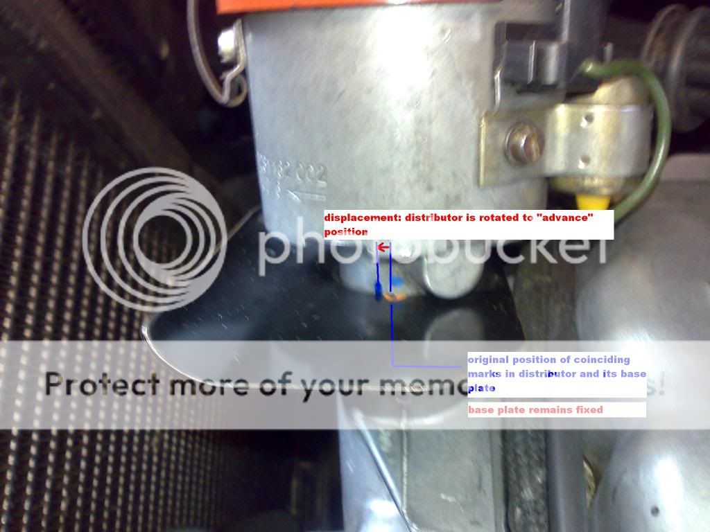

so i thought that i should check the distributor setting, the distributor was set according to specification with a stroboscopic lamp in the workshop
i painted a orange dot in the fixed plate (to allow me see the blue line that comes next), and a continous blue line from the plate to the distributor body to mark the "original setting position"
then i removed the securing bolt and i started rotating the distributor only a bit
i discover that anti-clockwise the engine died and started some annoying metallic noises inside the engine, the engine stumbled more and so I decided that was the bad direction

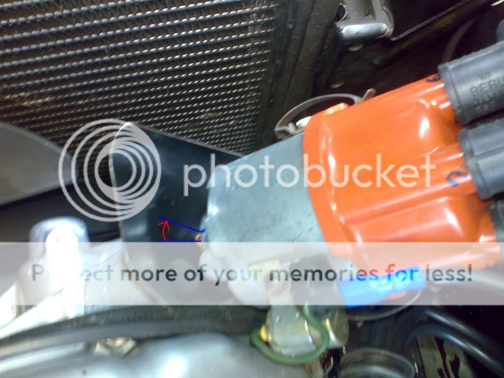

then i started moving it clockwise, i discover a clear reduction of the stumbling and a happier sound of the engine, until i turned it too much and it began dying again, so i went back a little and i left it there, as in this pic.
detail

Pay attention to the water temp. If it is near normal, you're done. If your water temp is a little high, slightly turn the distributer the opposite way just a bit. ( 2 degrees)
Yes, advance can effect temperature. What you're experiencing is reffered to as , "stack'. Components such as chain, sprockets, cam, piston position,distributer, points, etc. all effect the final best timing.
Looking at your blue marks, that doesn't seem too far off. Just enough to make the adjustment.
