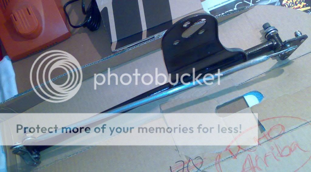

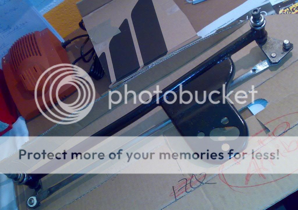

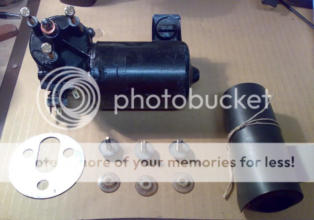

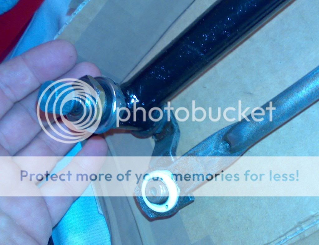

hi
if you want to go to the original mechanism and motor i have a very good set of mechanism plus motor from an 1973 coupe
cleaned, painted, regreased and checked
just in case is of any help
original fixing knurled end in perfect condition

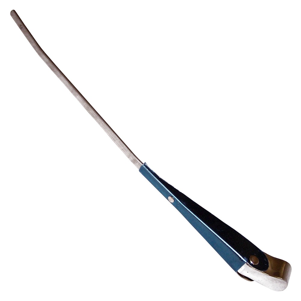

Hook fitting is the 'newer' type wiper arm where a plastic piece slides up into a reversed hook like slot on the wiper arm, on older cars they were just straight and the wiper blade fitted onto the end of the straight arm .
See attached pictures to hopefully explain this a little better.
Regarding length go to the scrappers and take with you approx measurements of your windscreen and a tape measure, once you find a car with approx the same width and height screen within an inch or 2 then the arms from this should do you SO LONG AS the splined receptical is the same size as your splined drive wheels.
If you get hoked arms you are then basically free to get different length blades which will allow a good sweep of your windscreen without overrunning and onto the roof rubber or paintwork.
Its not an exact science or a purist fix but it should get you away and through an MOT.

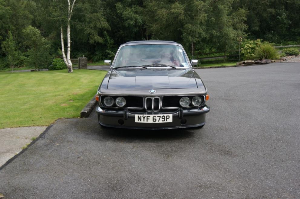

Picture of my car below attached for any reference, showing approx how long the blades need to be in relation to the car offside window / door pillar
Hope this helps
