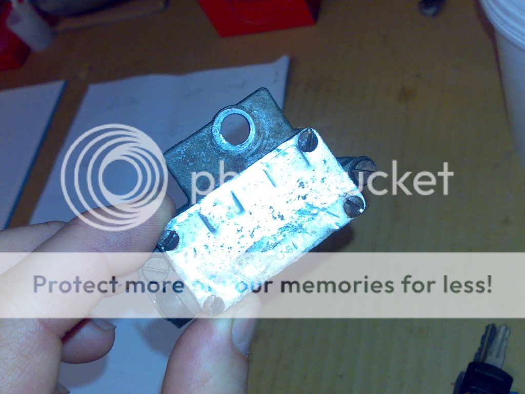

a question on the thermostart valve
hi
there is a doubt about the electric installation of the thermostart valve (see the pic to identify it)
you know that zenith carbs were apparently similar, but very different in the details, the set that i am repairing now has a lateral thermostart valve, it seems to work well, so when i connect it to the battery it starts warming up and opens the tiny valve attached to it
the question is the following: is this valve always open when the car is working in normal conditions ? and the more important thing: is the electrical resistance always ON and heating ?

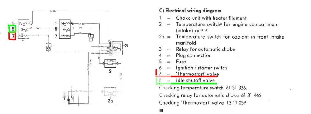

according to the installation drawing it seems so:
apparently it is connected to the same point where the iddle shut-off valve is
can anyone confirm this ? i am preparing the wiring right now

I think it should only be open when the engine is cold.
thank you for your input
unfortunately i can not agree, according the manual it is closed when the engine is cold and the outside temp is below 15 ºC, and then the electric resistance starts warming it up and it opens
so the hot makes the opening, i can not think that it will close again if the engine is warm, and moreover you still feed the resistance with electrc power
