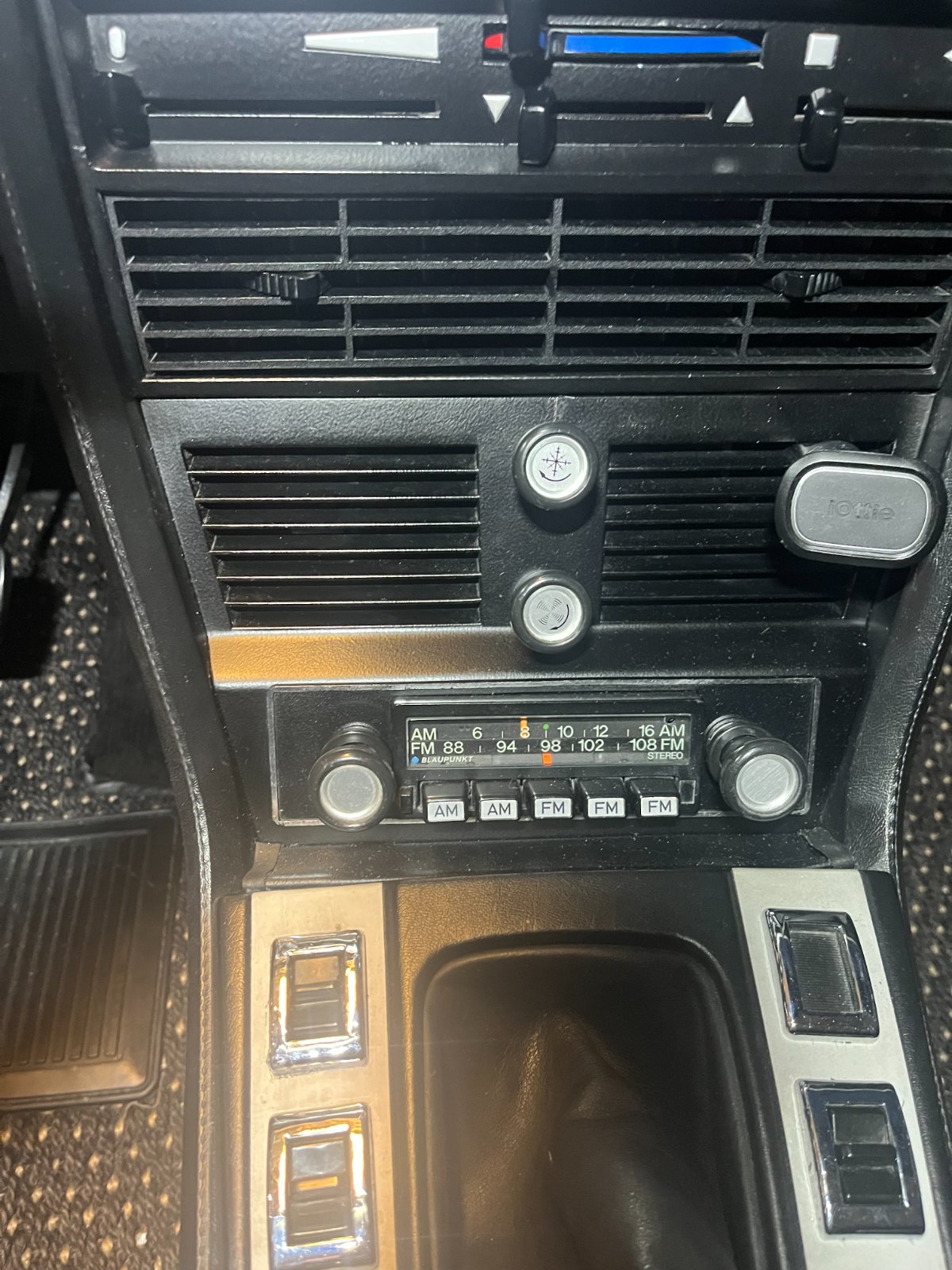

When I repainted my car, I deleted the original antenna, but now I’d like to install a hidden antenna instead. I have a couple questions for the group:
What’s the best way to access the back of the radio to plug in the new antenna? A step-by-step explanation would be really helpful since I haven’t removed the radio before.
Any tips or photos would be appreciated. This is the becker radio and I have AC 71 2800CS
Any recommendation on a hidden antenna?
Mike, That’s a Blaupunkt. I usually just remove the passenger side console and the console screws only on driver side to pull a/c faceplate forward a bit.
I bought a basic hirschman radio antenna and found a nice place to hide it behind the dashboard (horizontal ). I'm sure the signal strength is affected but I haven't had a problem.
I had the luxury of a dash disassembled for access, so perhaps my words are irrelevant for your situation .
If you remove the side console you can access the rear of the radio and run an antenna up towards the upper dashboard, near the center speaker. I agree that although it may not be as good as an outer antenna it’s likely sufficient. It’s pretty easy to work along the passenger side footwell and push a cable up towards the speaker, then you can remove the speaker (temporarily) to pull the cable through and anchor it to the dash underside
