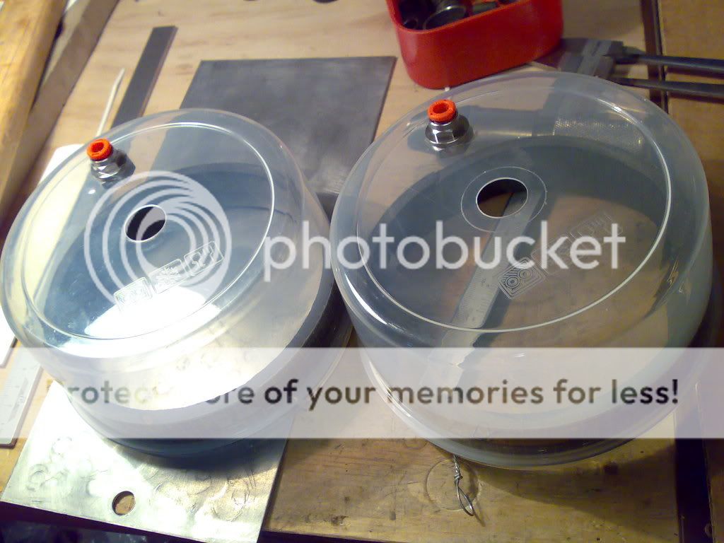

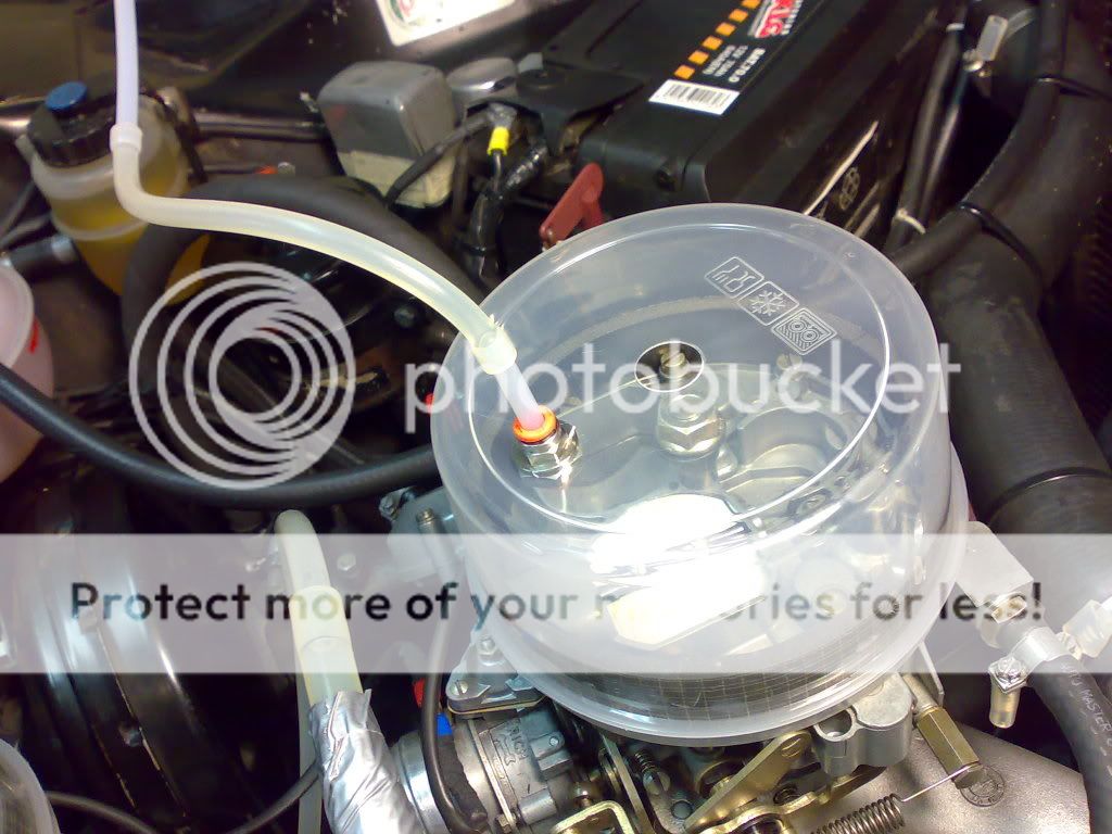

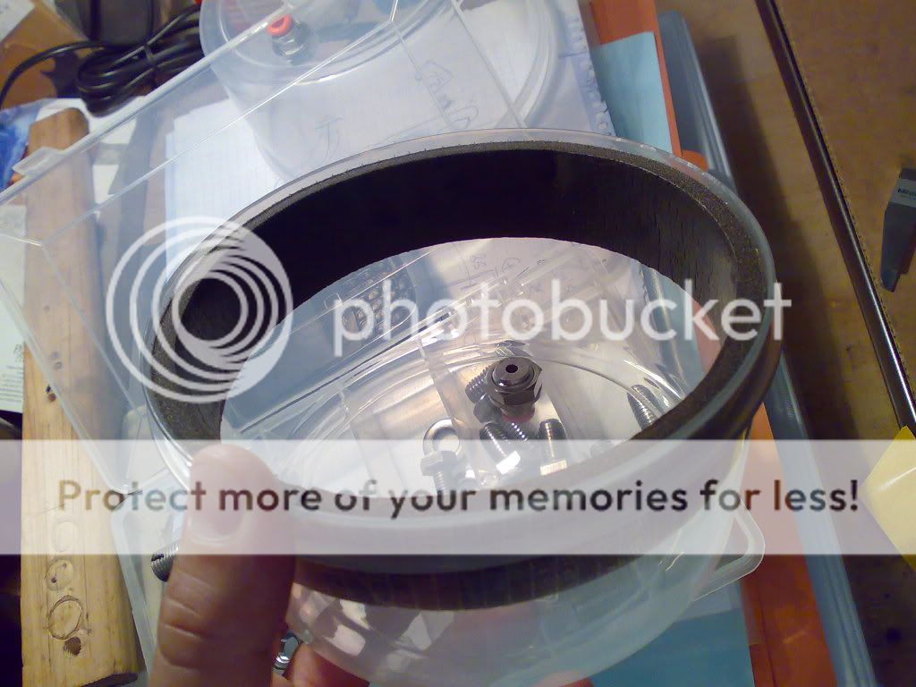

using some of the excellent advices of others i have built this synchro device
hope it is useful for someone
regards

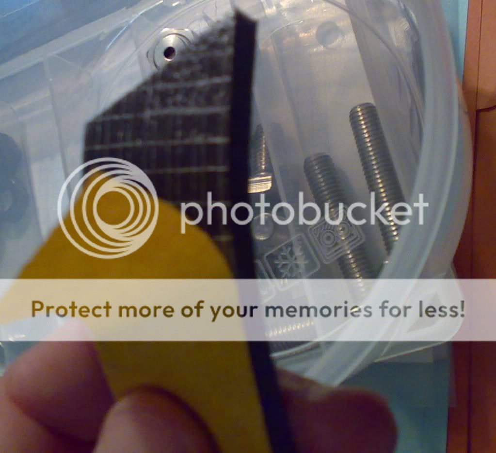

some adhesive band to fit and air tight

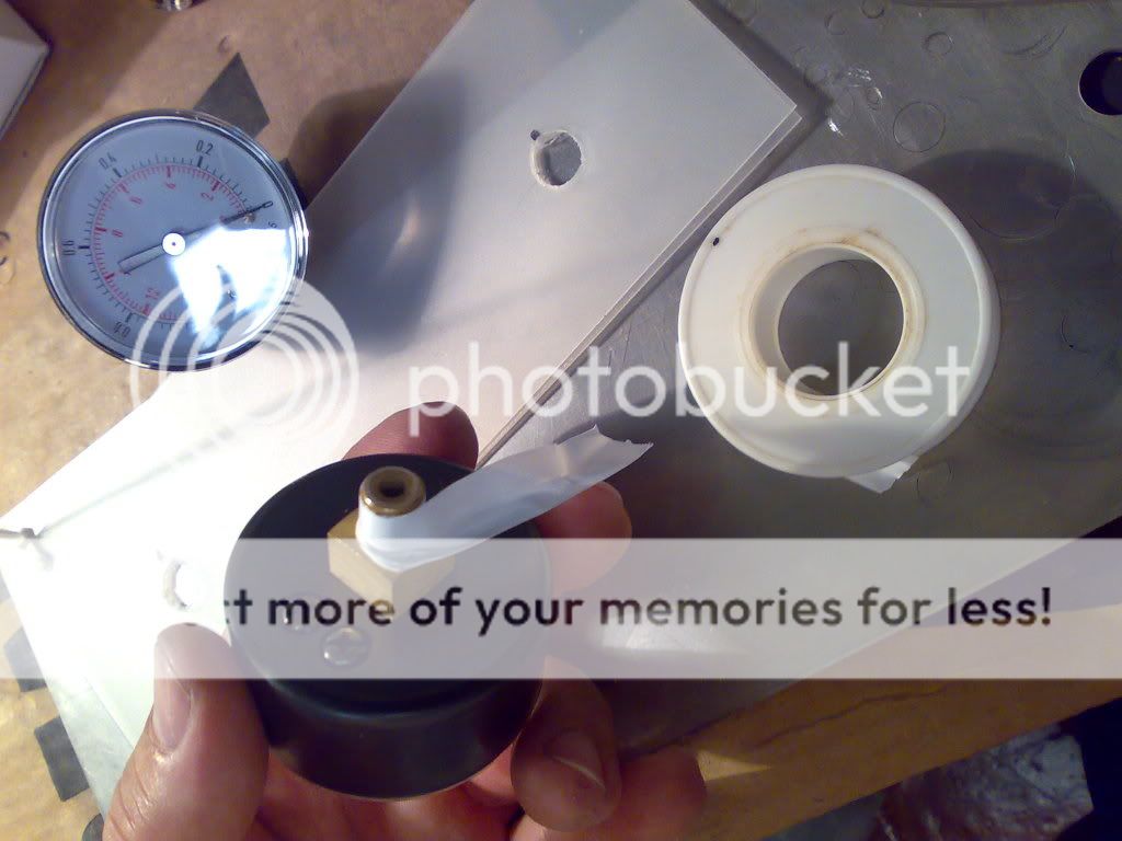

vacuum meters from 0 to -1 bar

Awesome! Are the small center holes large enough to allow air into the carbs to function correctly while you are making adjustments? Also, where do I get a drill bit like that? And in conclusion, what will it cost me to build my own?

sorry my mistake
the synchro can not work as it is in the picture,
after trying it i realised that the vacuum meters can not read anything, the holes were ok for the engine running, but too large for the vaccum meters to have any suction
but the good news, is that i can use the vacuum meters and the rest of it without the bowls

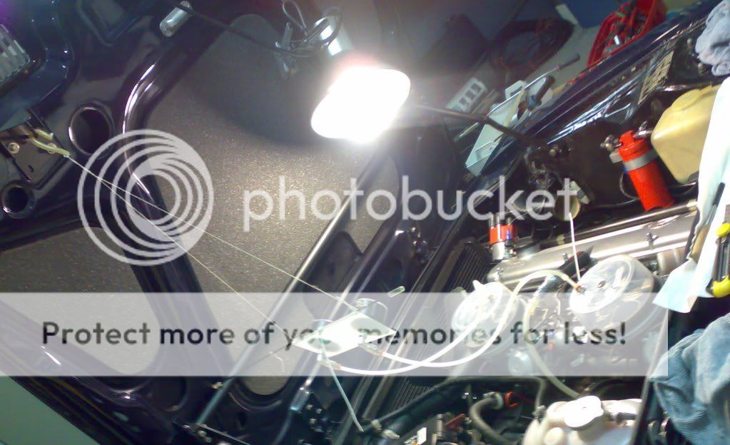

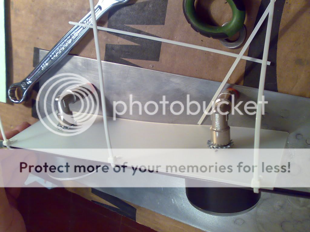

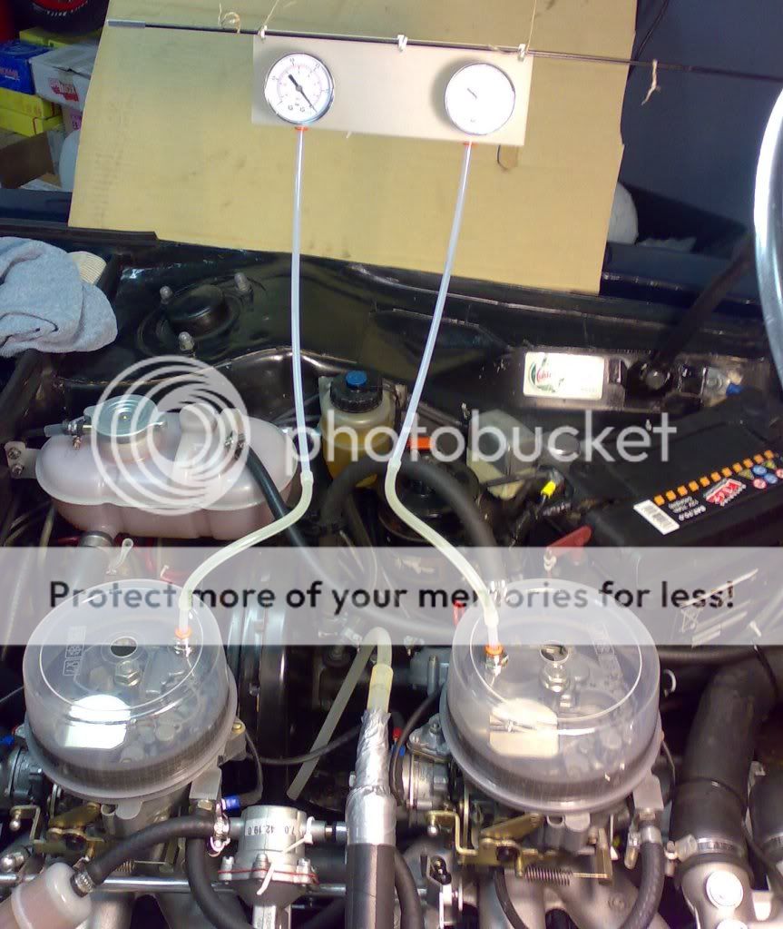

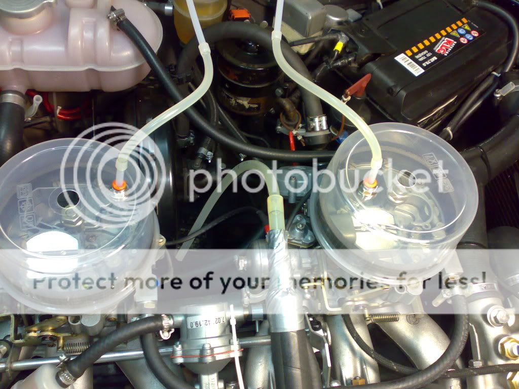

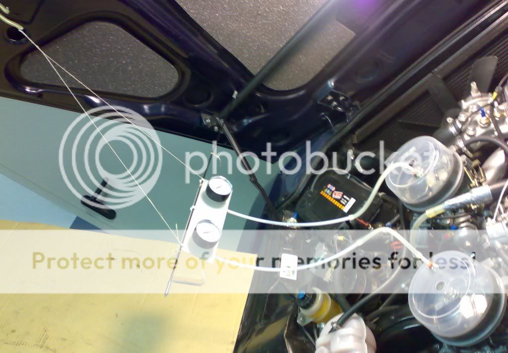

the final installation is this one, use only the vacuum meters and the tubes and connect to the hoses that come out from the carbs, as in the picture:

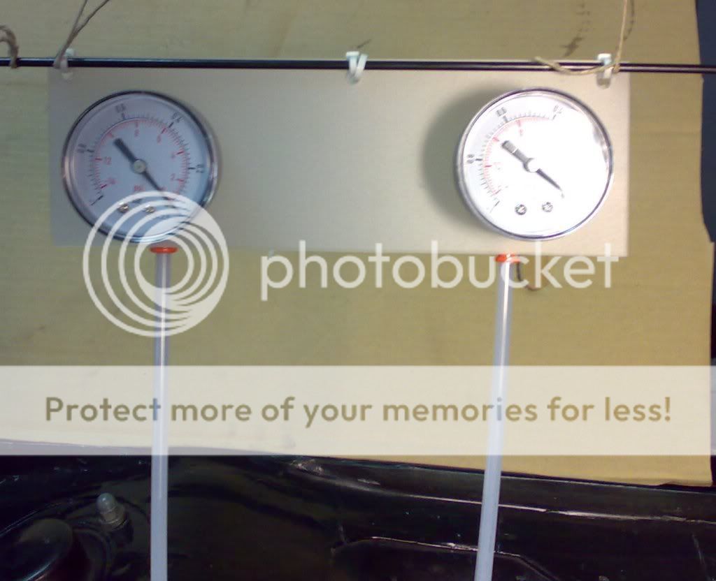

they work great, see here after synchronising:
components:
vacuum meters scale (0 to -1 bar), max error +- 1,6%, adapting materials, silicone hose diam. 4mm (exact one for the carb hoses)
the total cost will be less than 60 euro, but i do not know where you can find them, nowadays is getting more and more difficult, nice that i have a supplier nearby with plenty of these things, :mrgreen:
