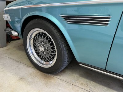

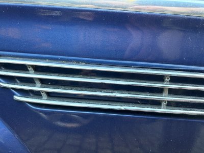

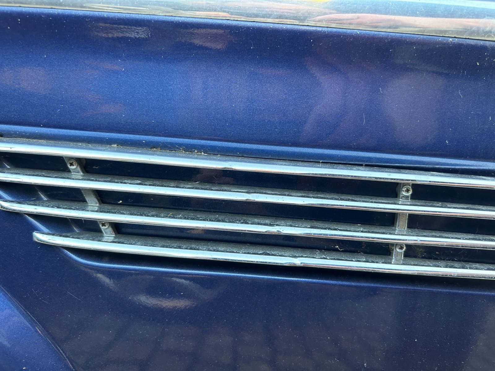

Also, I bought new chrome grills but didn't think the 'one use only' clips were that good for such expensive items. I broke off the prongs, drilled four small holes and used stainless steel screws to attach them. It's a fake grill anyway but adding the screws improves the look. Obviously not standard but neither is many aspects of my car.

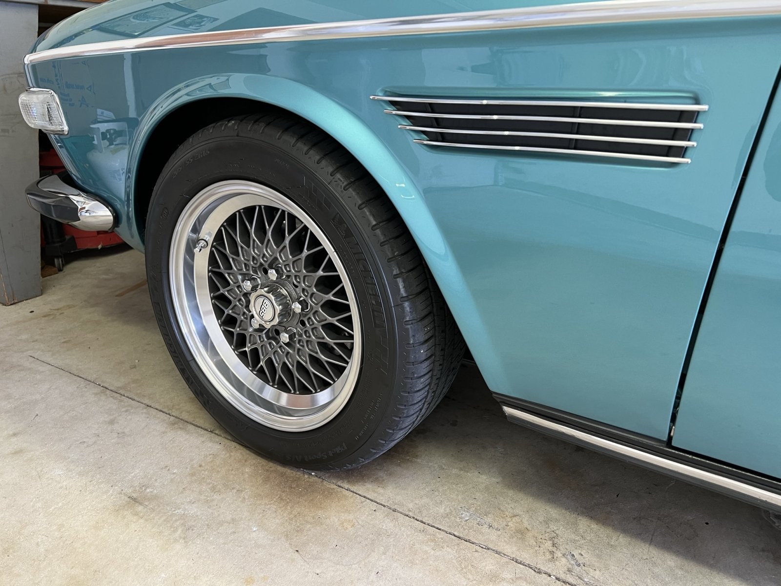

Rek--Now you can make the fake grills look less fake by painting the vertical posts with flat black enamel with a brush and masking tape. Then they will look like the pic below.---Drew
