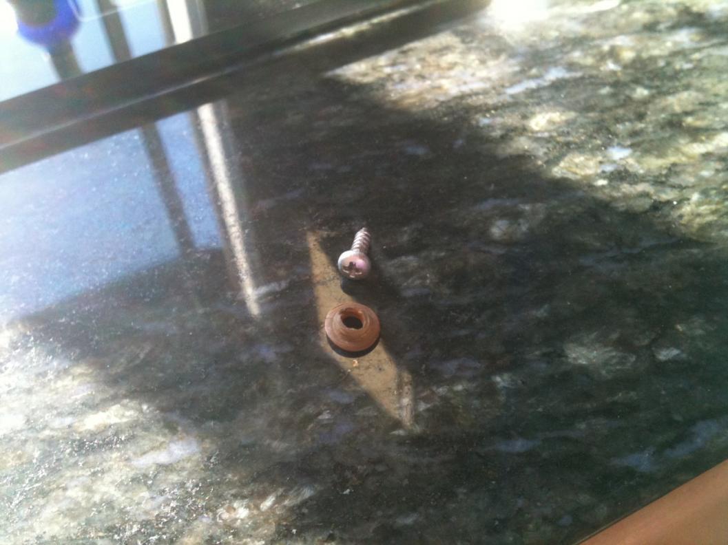

TINY DETAILS are you kidding? Hood grilles use tiny Phillip Head screw Plastic Washer
Jerry,
I cannot believe that E9 guys are asking questions about tiny little screws under the hood that no one will ever see! That is getting really crazy.
Didn't you guys get the Memo?
According to the rules BMW E9 guys are never interested in or ever allowed to speak about originality or tiny deatils:-?. That sickness is reserved ONLY for Porsche 356 and 911 guys:mrgreen:!
On all 4 of my E9s have the exact same tiny Dome Headed Philips Head sheet metal screws. There are 6 per grille. Under the screws are tiny plastic countersunk washers that are all yellowed now but were probably clear when new...

The plastic bushings seem to be available (but pricey), I'd try your local Ace Hardware or similar store with a large fastener selection and root through everything for suitable substitutions for both parts. Just watch the diameter of the screw threads so they don't crack the plastic grille.

I knew there had to be a better way to mount a $112 hood grille so it didn't break that 45 year old plastic, rust, and generally didn't get dotted for the judges that did know what a vintage BMW should be other than white glove clean. Nylon washers... got it.

The screw on the existing grills are of various sizes and none have a plastic bushings. I thought it was a rubber washer! My only concern is not to break the new grill. Preventing rust on the new paint job is number two on the list.

Rubber washer would probably work, the screw size is ST2 9X13 according to the parts list.

Side grilles have a clip like those for the roundels, push it on but don't ever try to take it back off. Some use a small hose, that apparently works too but no screws! Hood grilles as mentioned use a tiny phillips and plastic washer, go to a large hardware store and search the bins/bags.
