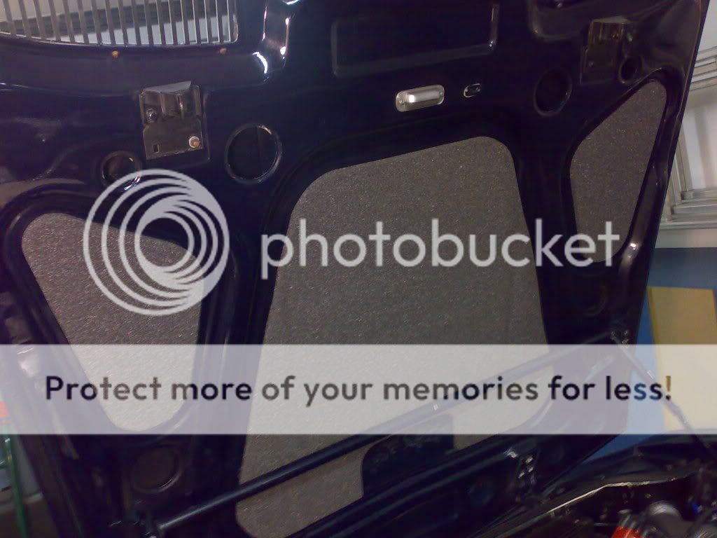

i have just received the w&n insulation pads
very well cutted to shape, and very simple material
the reason for buying was I saw an old 2000CS, with the original material in place, and it was, if not the same, very, very similar, so enough for me

this is the final aspect of the just istalled parts from w&n
first clean, second activator, third assembly
the small ones, no problem, the big central one, start from the lower zone, pass the bar, and then go little by little to the top
