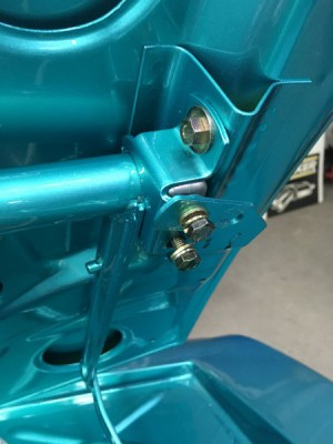

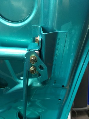

Here are some helpful hints curtesy German forum !
Basically you should do this with two people, otherwise you will scratch the whole hood.
Loosely mount the bearing block, torsion bars, and tube with struts, but do not yet install the end stop. Insert the complete hood strut assembly and tighten the screws. Then, by slightly twisting the struts, secure the end stop. This will create a slight preload when the hood is open. Finally, attach the struts to the fender.
You must mount the hood strut to the hood without any tension, as shown in the first two pictures. Then, you must extend the strut away from the hood, approximately at a right angle, and position and tighten the stop bracket. (From GR)

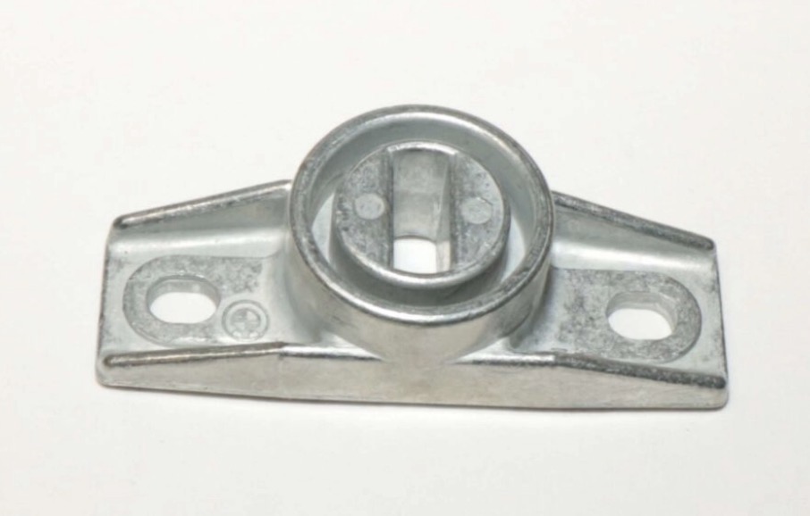

Well yes. But the pot metal parts that bavbob refers to in post # 4 are secured with the same bolts that mount the whole assembly to the hood. And those parts are what anchor the fixed ends of the springs. So conceivably, one could have shifted outward when the spring assembly was loose, allowing that spring to lose its pre-load. If that were to happen, one arm would require less torque to rotate it than the other. But I don't think there is a way for the spring to loosen just a bit; it would either move 180° or not at all. And given the amount of preload on the springs, the clunk would be pretty audible if one came adrift.

If the center part of the mounting brackets are worn, twisted or damaged then it may cause this problem I think. When I replaced the hood on my car during the restoration I got a used hood with the brackets still attached but not the bar. There where obvious signs of wear on them, so naturally I replaced them with new ones.
E3AV is on point. If the orientation of the anchor part in the image above is fine and the orientation of the arms are fine (see my post, I describe where they should be), then the center keyhole in the image above is stretched and distorted and will cause your problem. That was the issue with mine. New brackets solved the problem. Send us some images of what you have.
