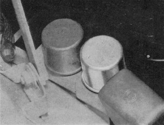

Where exactly is the horn relay and how can identify it? Assume it is one of the relays in engine bay but how to hone in on the horn relay vs others? New to forum and new mechanic

you know about the 2/3 relays next to the battery, lights and horns, so remove one and see what happens
the repair manual shows this as the horn relay (the round one in the middle):
