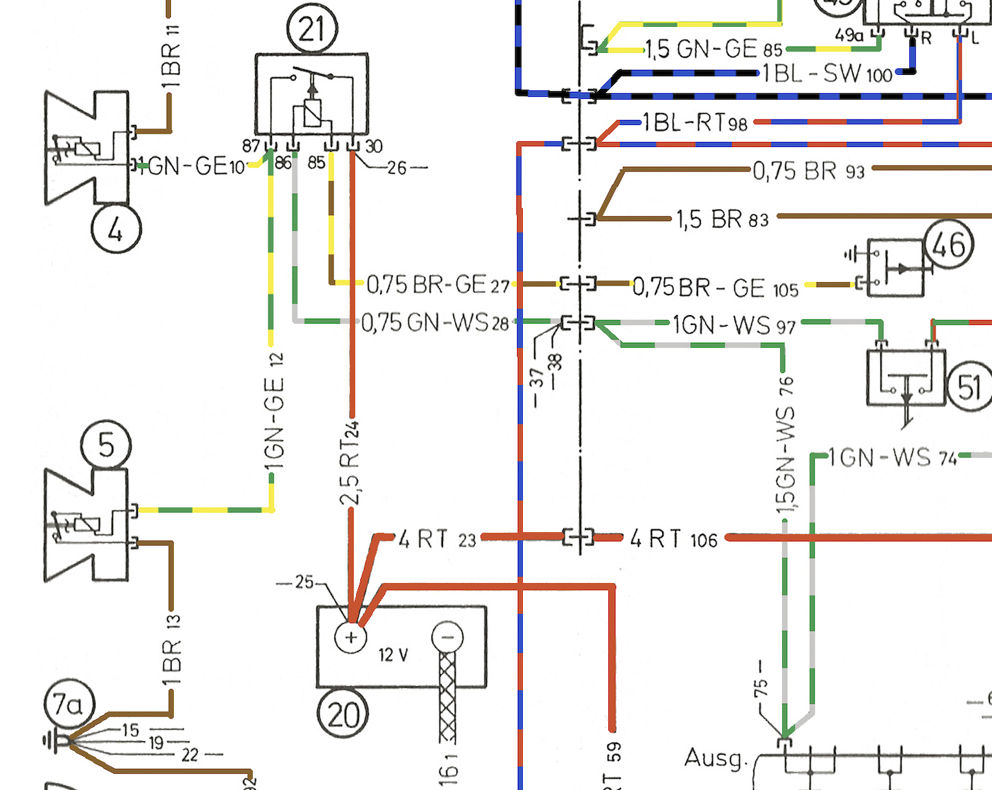

Anyone have a simple diagram of how to wire the horn relay? Mine knocked loose and lost a couple of connections. No horn. My "blue book" only references simple removal and install of the original type.
Terminal 30 gets large red wire from battery, 87 goes to the horn (green I think), 85 and 86 trigger the relay doesn’t matter which you use but one is ground, brown, and the other is the green or green/white.
