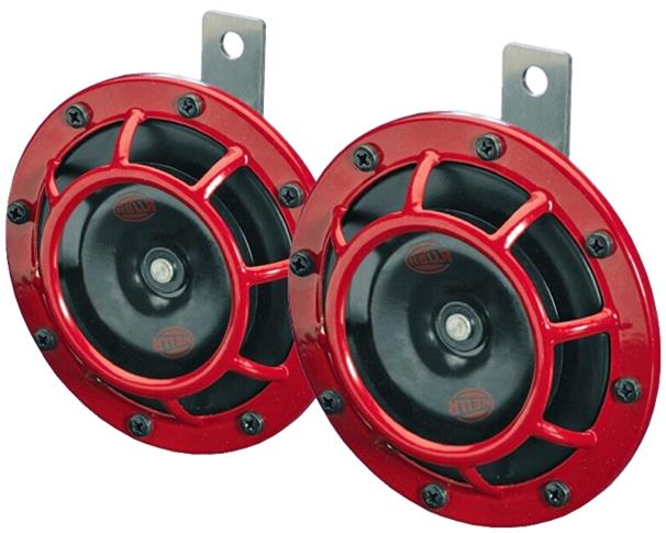

I am using these Hella horns in traffic crazy Atlanta. Not exactly the same sound as BMW but do sound European.

i think you will find that new horns will make a difference. here are new Hella horns for BMW on Amazon
I installed these. Mine were dead & needed them in my first drive into office—helpless feeling. These seem plenty loud, but not as loud as the ones M5bb posted, which a friend installed & scared the bejesus out of me. The ones they sent me had a 3-pin connector, which I had to cut off & work around, but that was probably just a one-off shipping error.
