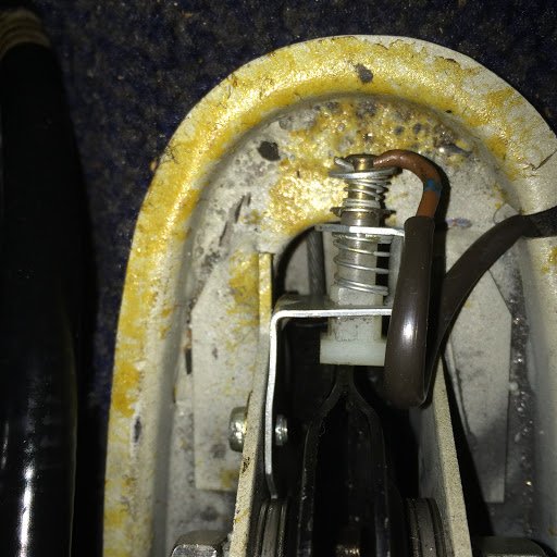

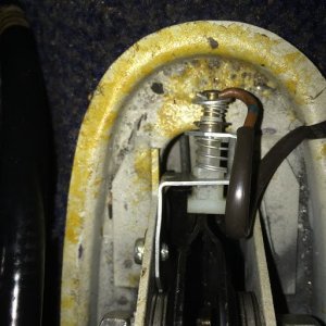

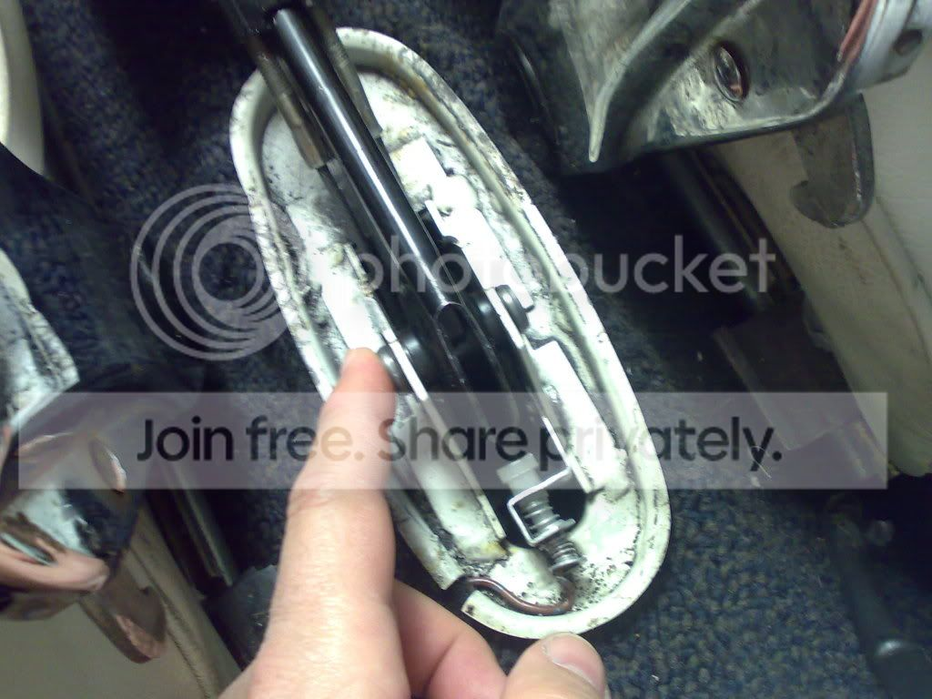

here is a picture from my search - my wire was laying on the floor of the car (brown / blue) feeding from the drivers side harness that runs from front to back. the wiring diagram shows a cable end that is attached to the switch. my curiosity is where? i see it going under the spring switch
mine has a piece of bare wire end - no solder on it anywhere. does it solder onto the end (twist fitting) of the spring?
It's been a long time since I looked at mine, but the photo sure does look like it's soldered vs spade terminal.
that photo is from dequincey ... since the end rotates to tighten the spring / contact ... that would put a lot of twist on the wire.
just goes to show you, it didn't stick in the memory. the good news is that i found a plastic piece 11 years ago, but i didn't remember about how to reattach the wire. looks like the spring end is pushed in and there is a hole in the pin for the wire to be inserted. so it just goes to show you, its hard to teach an old dog a new trick ... and if you do, its hard to teach him to remember the trick. maybe this time i will remember now that i've had my nose rubbed in it. appreciate the reminder Erik!

Actually it isn’t. There is a hole in the post that the wire goes into and is held in place by spring. You have to push the spring in to expose the hole
