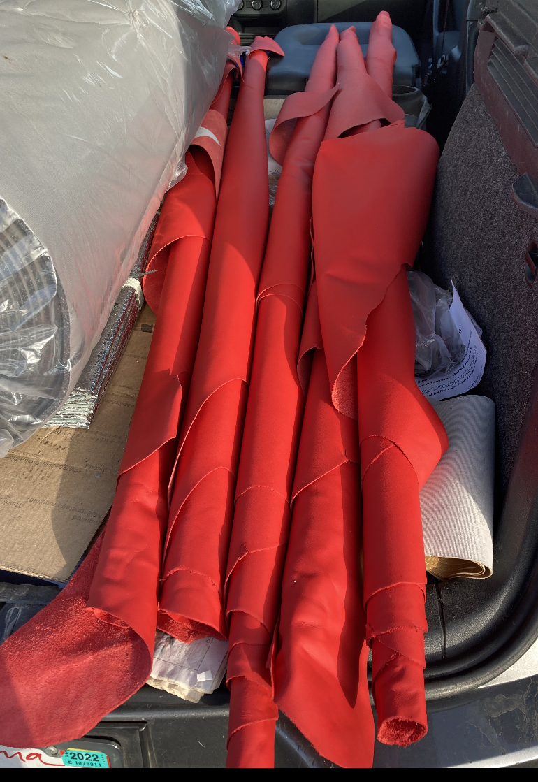

Dave like noted above there’s a lot of variables, with that in mind, I purchased five hides to do the interior of my car…seats/door cards/under dash panels…
