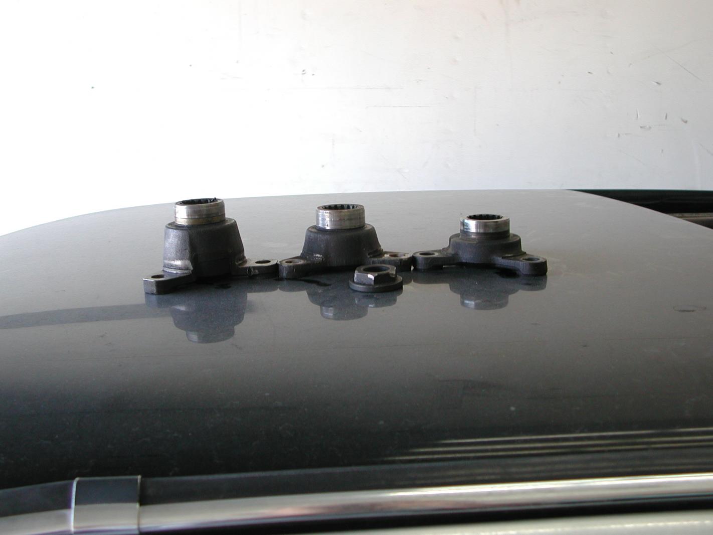

There are three different output flanges for your G265, something to consider when deciding on drive shaft length.
